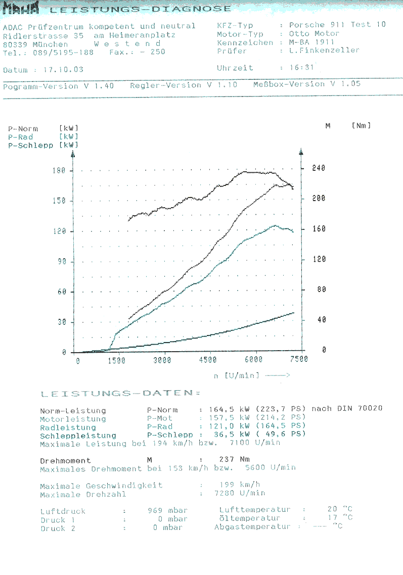

When Bernd Andritzky of BMW was dyno testing some of the chip mappings we were working on, two dyno runs were performed on an U.S. spec 89 Carrera with and without the airbox cover. It was fitted with a Euro premuffler, and the chip was the same on both runs. Here are the results of the two runs. These particular runs were runs #10 and #11 and were 10 minutes apart from each other. The first run, #10 is with the stock airbox cover. The second run is with the cover removed. Comparing the runs shows a 0.7 rwhp loss with the cover removed. But that could be dyno tolerances, or my theory is that the warmer air cycling inside the motor compartment on a static vehicle on a dyno is reducing the hp with the less dense air. On a moving 911, this could be different with the turbulence behind the vehicle drawing cooler air into the engine compartment. With a tail Bernd theorizes that even cooler air denser air may be drawn in. Obviously these were done on a German dyno, and the rwhp #s don't correspond to U.S. dynos, so don't try to compare this to a different dyno. Anyways, here are the two runs:
Run #10 with airbox cover
http://forums.pelicanparts.com/uploa...1069140420.gif
Run #11 without airbox cover
http://forums.pelicanparts.com/uploa...1069140432.gif
Paul Franssen 11-18-2003 02:59 AM
Interesting to see these German test-results. Note that, on result no. 11 (with lower bhp figures), the air temperature is 19 (iso 20 on no. 10) and ... the oil temp. is only 16, respectively 17 degrees centigrade. Those are very low oil temperatures! Does that mean they do those full-power tests with a cold engine?? In fact, how can it be that the oil temp. is LOWER on the 2nd test. Just some curious things...
Steve W 11-18-2003 03:02 AM
No Paul, the engine was actually pretty hot, with each run after another in 10 minute increments. The oil temp sensor was just not hooked up and is just measuring ambient air temperture.
