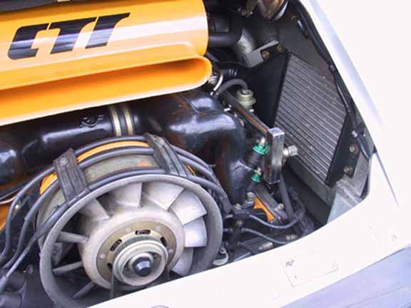

Where can I find these ignition wire holders?
I've seen them on the Ruf CTR:
http://forums.pelicanparts.com/attac...&postid=664887
They're the ones that are mounted along the top of the fan. Any ideas? TIA.
john walker's workshop 02-28-2005 01:30 PM
stock 3.2 stuff. be aware that the wires that they hold have a rubber sheath that makes the wires bigger. regular wires would be loose .
Rick Cabell 02-28-2005 01:43 PM
Thanks John. That is good as the magnacore wires are 8.5 mm and will be just about right. I have a 85 motor here that has a differant set up that is also factory. I'll try to attach the photo.http://forums.pelicanparts.com/uploa...1109626933.jpg
