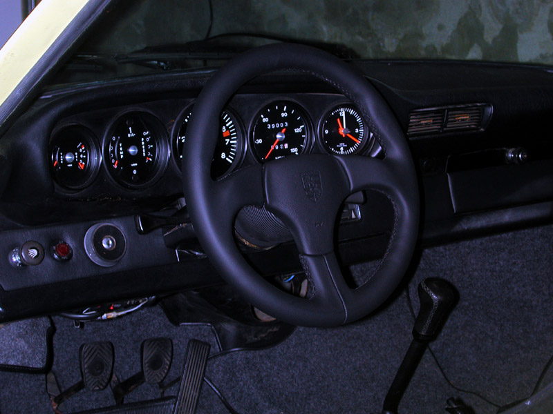

I've done it. I cut a plastic backer to fit and wrapped black leather around it, glued with 3M interior adhesive. There are four pieces: left of the steering column, steering column to glove box, glove box, and the little triangle right of the glove box.
With an early car, you can't use the (common) later trim panels, since you don't have the side vents.

Here's a pic. Sorry it's a bit murky:

The vinyl is just glued on. Pretty easy job of finding some 72-73 door panels and using the vinyl to cut new ones using the old ones as templates. All you should have to do is unscrew the switch bezels. Install the new pieces and put the switch bezels back on.
