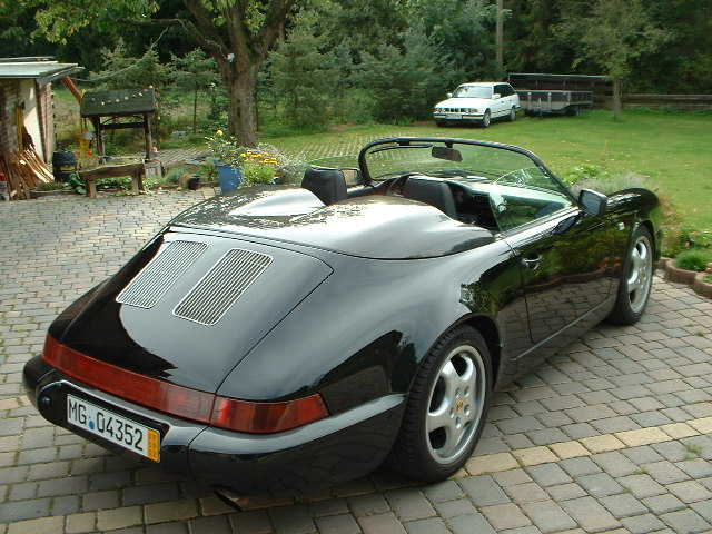

juicersr,
I was toying with a design that was rather close to what you have already done - my plan was to do it with two cutouts on either side of the middle rather than the single in order to maintain more of the structural rigidity of the engine lid (similar to the pic that gastalt1 posted). My sole intent was for better engine cooling. Your design certainly reduces the 'labyrinth-type' passageway that the cooling air has to follow in stock lid - your approach allows a direct approach of the capture of cooling air.
Although it is probably too late in the season to determine any cooling benefits from this design I would certainly be interested in hearing of any results in the coming spring and summer (as you have saved me from having to procure another engine lid to sacrifice for my test). Your project appears to be done very professional and, in my opinion, is aesthetically pleasing. Thanks for posting and I am looking forward to updates.

juicersr 11-20-2006 07:59 AM
Thanks for the complements guys. I haven't had time to do the swap with the existing lid, which involves a lot of transfer of AC condenser stuff, etc, but do have a pix of the test fitting on my SC prior to painting it and the car.
http://forums.pelicanparts.com/uploa...1164037860.jpg
Obviously looking rough at this stage, but you get the idea. Will allow a more visceral appeal to the backside.
As for structural integrity, the lid is still plenty strong without the vertical beam, and have no qualms about attaching the latch.
Weight savings? Hey, every little bit counts, right?

Well, to each their own, but I personally do not understand this mod.
Is this supposed to assist with cooling? Will it actually do that or will it have some sort of unintended effect of changing the stock airflow through the engine compartment. Specifically, could it change the airflow so that it goes in the first intake and out the second, or down the back of the engine compartment, without having any beneficial impact at all? I have no idea.
Could it have some unintended impact on high speed stability? Specifically, could it result in lift at higher speeds? I have no idea. Hard to tell without wind tunnel testing.
Is it for aesthetics only? If so, I personally am not too fond of it. Were you going for a Ferrari type look? If so, then why not Lexan? I can't really see through it as is. Imagine a Lexan ducktail . . . or a fishtank made from Lexan and if the little fishies die it means that safe engine compartment temps have been exceeded . . . ;)

masraum 11-20-2006 09:20 AM
Looks cool. I second the suggestion to use the same mesh/grill material for both holes.
I doubt there will be any problem with cooling or air flow since the fan sucks a lot of air in. The only thing that I can see is that it might not work as well for the AC since the air that normally would have to go through the condensor can now go through the second grill.
