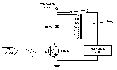

Did you add flyback diodes to your relays?

Info for anyone interested...
Flyback:
"One other consideration when using relays is the current spike created by the coil. When a coil of wire has current running through it, a magnetic field is created. This closes the contacts of the relay. When the current is removed from the coil, the magnetic field collapses and this causes current to flow through the wire until the magnetic field is completely collapsed or gone. This can cause a damaging voltage spike back towards the logic circuit. This is called flyback and is avoided in the above circuit with a flyback diode."
From:
http://www.acroname.com/robotics/info/articles/drivers/drivers.html
Example:

Uhhhh... neither the headlight filaments nor the manual switch contains any active devices. I suppose a switch could qualify as a logic circuit since it has 2 states...

I believe a flyback diode is built into the standard fuel pump relay, that's why I asked.
And the explaination above, while correct in it's theory, is not correct for this application.
