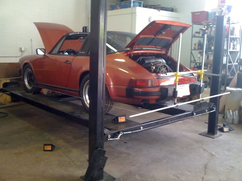

reviving an old thread with my interpretation...
not yet complete but i'm getting there...

just had mine done as well. my guy said it usually takes him about 2.5-3 hours to do a full alignment.
