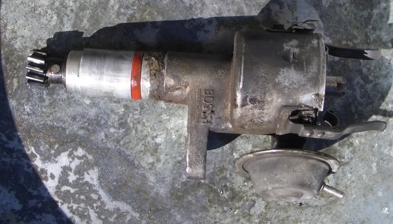

Step 1:
Get it to Z1, mark it, pull it.
http://i184.photobucket.com/albums/x...rsche/DIS2.jpg]

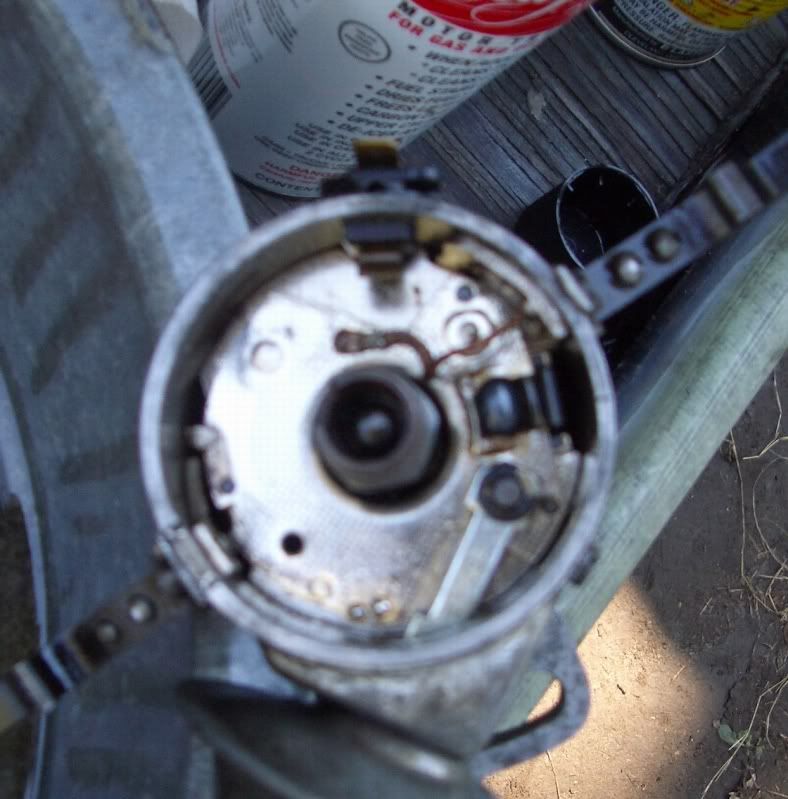

Step 2:
Take your points off or in my case the Pertronix Ignitor off.
http://i184.photobucket.com/albums/x...rsche/DIS3.jpg

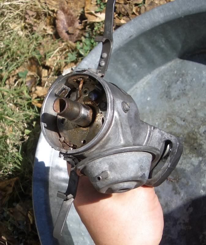

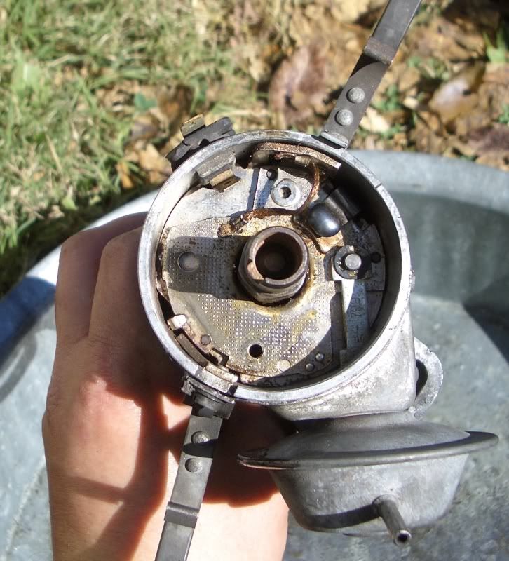

Step 3:
Look at it, mine was more dry than greasy and dirty, but looking old.
http://i184.photobucket.com/albums/x...rsche/DIS4.jpg

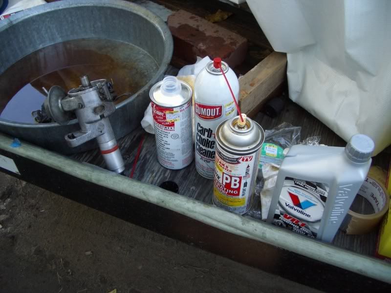

Step 4:
It's a cleaning party, invite all your favorite and trusted friends over.
http://i184.photobucket.com/albums/x...rsche/DIS5.jpg
Step 5:
I sprayed half a can of PB Blaster into any hole, top and bottom I could find.
I then sprayed generous amounts of carb cleaner and shook it all about.
Then I poured nearly a whole can of Seafoam through it, rotating it, spinning it and just drenching it.
Oops, I don't have these parts on hand anyway.:eek:
http://i184.photobucket.com/albums/x...rsche/DIS6.jpg

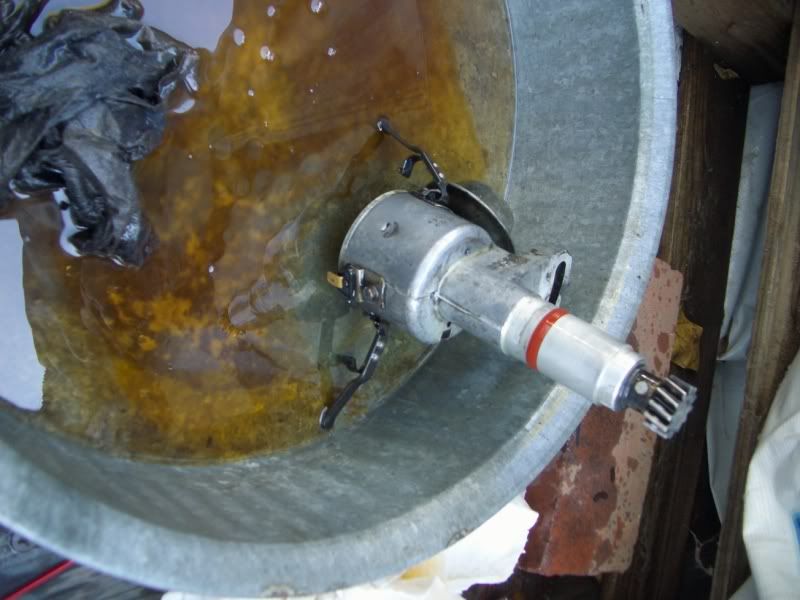

Step 6:
I poured almost a quart of motor oil into the distributor, shook it all about, poured from both ends, and then some more. I then let it drain in the oil pan for several hours.
http://i184.photobucket.com/albums/x...rsche/DIS7.jpg
I shook it well, spun it and so forth. There was still oil in it, so I let it sit for a couple more hours.

Gunter 06-06-2011 08:58 AM
I'll give you "A" for effort but overall, this is NOT the way to do it. :(
For one thing, you cannot see the condition of the tiny plastic bushings for the springs or remove all the dirt around the weights. Plus an unnecessary waste of fluids and oil. :rolleyes:
These Bosch point- distributors come appart similar to the SC distributors by removing the vacuum pod, clips and wire connector first.
Vacuum pod:
Remove the small circlip and lift up the arm, then remove the 2 screws and remove the pod.
Cap clips:
Once the clips are off, the whole trigger plate mechanism can be pulled up over the shaft and out, or, if there are screws under the trigger plate, rotate the trigger plate mechanism to locate the holding screws underneath. Remove the screws and lift out the whole mechanism.
Now one can see the weights and springs and check for wear. :)
The washers between the gear and body determine axial play. One of the washers is fiber but brass can be a substitute, IMHO.
After everything is back together, put a tiny bit of grease on the small ball on the trigger plate. Check the vac pod by sucking on the line and watching the trigger plate move.
