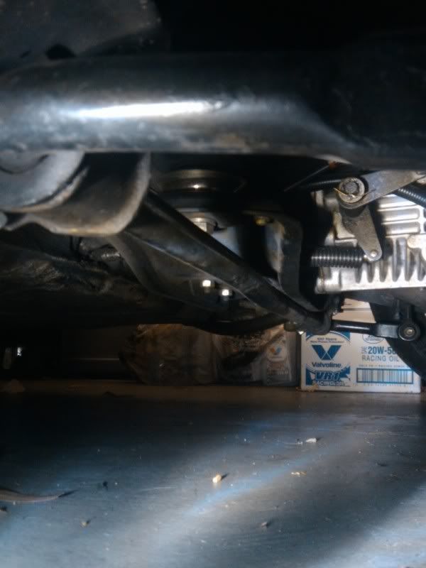

Don't know if u remember - I have the 3.2 in the 68. My throttle is sticky as well. how should the bell sit? Should the prongs basically point down to the ground? Mine is cocked on a 60degree angle at idle. The engine throttle link looks like it is to short.

Here is a shot from a side view of my Bell Housing Linkage. Hope this helps: Remember this is LHD side.
http://img.photobucket.com/albums/v5...724_101446.jpg
Cheers,
Jim
Yes, I place a dust shield to the ball pivot to the pedal linkage, It is loose fitting with lube, I also noticed the rod would rattle against my trans mounts cross member.
rolls 912 07-24-2011 03:16 PM
im surprised that the bell is rotated so far back. I thought it would be more clockwise to about 7:20. thanks for the headsup. hi ho, hi ho its adjust the screw we go.... im sick of tweaking. i just want to drive the thing!!!

Hi again. Rehasing this thread - Just confirming that the bell arm pictured above is the correct way that it should sit? I.e. i thought it should be more like an upside down V rather than a V on its side as pictured.... Im about to adjust mine.
DRACO A5OG 01-23-2012 03:06 PM
Oh my, your baby RHD, correct?
It should still be the same orientation if the Throttle Body arm in the engine bay is on the left had side.
