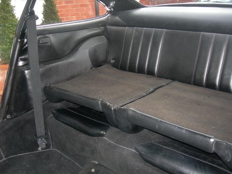

have had the Southbound rear seat delete carpet set hanging around for some time, awaiting the fitment of the rear cage and the seat lowering to be done.
Well, the summer holiday has proven most productive for the 73T, and with those jobs done, it was time to go from this :-
to this :-

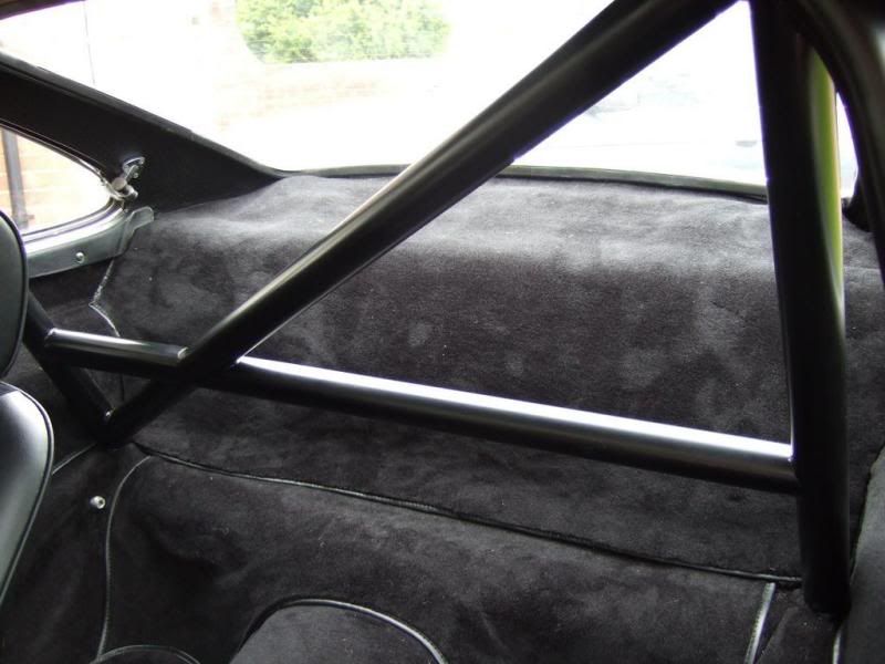

So far I have spent 10 hours over two days and taken 89 photos as a record - I have still have the transmission tunnel and fronts to do.
I generally followed the order in the excellent guide to carpet installation available from Appbiz.
This was complicated by having to cut around the roll cage, harness belt eyelets and the lowered seat mounts.
Tools used were essentially scissors, stanley knife, spray glue (from B&Q), chalk.
On the whole I am very pleased with the end result, given that I had to make patch pieces to cover the original seat mountings, and for the rear by the cage.
The car has a much more completed look and feel about it, going from the solid but brown / black / silvr POR finish to black carpet - it is not Perlon.
Some of the photos are poor, as for once it was very sunny and the camera found it difficult with the contrast of the bright light, black carpet and white / silver piant.
This serves as a record for myself of the work done, but may be of use to others if the contemplate the sane exercise.
I have the front to fit tomorrow so another update and more photos to come.
