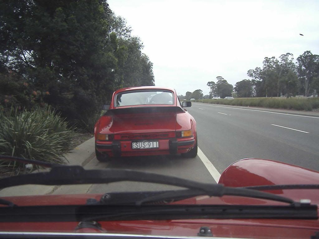

sus911 has a set in his carrera
not the best pic but the only one i had handy:
