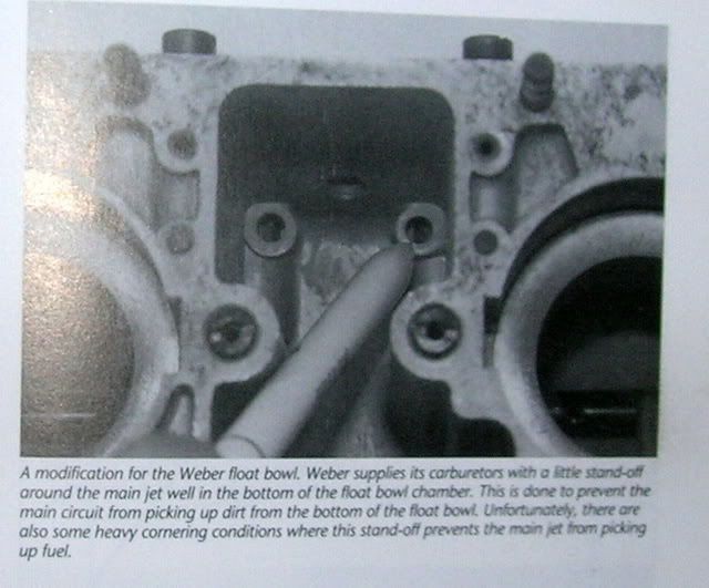

Need a pic of the Weber float bowl mod
Help!!! I can't find my BA performance handbook and I was planning on doing the float bowl mod tonight. I've done multiple searches and have only found referral's to BA's book. No pics of exactly where the baffle goes or how big it needs to be.
Thanks!

Excellent!! Thanks so much Shoepop!

You are very welcome, a very worth while project.
