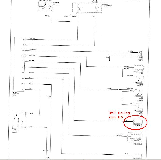

Took a very quick look at the schematic for the 84 Carrera and the alarm system is tied to the DME relay. Looks like if the alarm goes off the DME relay will NOT activate and the entire DME gets NO power. Thus you can't start the car.
The DME relay activation comes via the Alarm module, this means that when you turn the key to run or start the DME relay is activated by the Alarm module and is commanded to turn the Relay on but if the alarm was triggered the Alarm Module simply ignores the Run or Start mode of the ignition switch and will not activate (energize) the DME relay.
The alarm module is in the front trunk under the wipers. It's a small black box.

Old 07-07-2008, 12:51 PM
scarceller's Avatar
Join Date: Oct 2006
Location: Southern MA
Posts: 4,018
Here's the schematic from the factory manual:
The Alarm module applies 12V to pin 86 of the DME relay to activate te relay.

Old 07-07-2008, 04:17 PM
Location: New Jersey
Posts: 1,861
Sal,
By the looks of the circuit it appears that if the system fails that unpluging the box removes the problem and you are on your way once again, but alarmless? Or are there jumpers that are required?

Old 07-08-2008, 09:42 AM
scarceller's Avatar
Join Date: Oct 2006
Posts: 4,018
Originally Posted by Mysterytrain View Post
Sal,
Ron, I think that if you unplug the box the DME relay will never activate. That black wire that feeds pin 86 of the DME relay would be left disconnected. I think you would need to jumper this wire to the run/start line on the alarm module. Just a guess.
