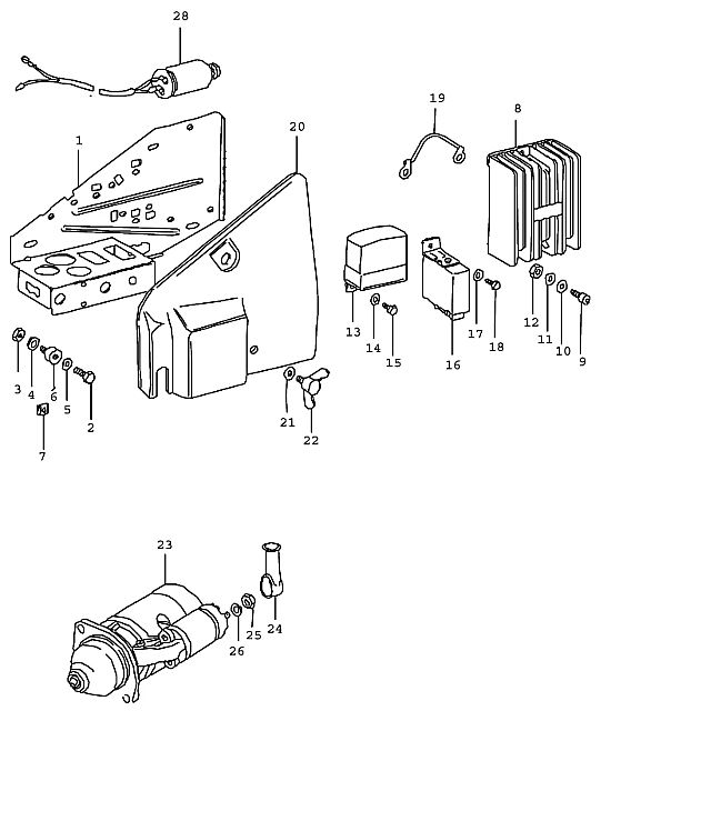

Old 09-13-2008, 06:25 PM
Join Date: Jul 2003
Location: Glorious Pac NW
Posts: 4,184
Originally Posted by 4flyboy View Post
Great discussion guys. Mine seems to read ok but it "sticks" at zero for awhile until I get the Rpms's up or it gets jostled. I'll try the 14 pin connector for fun. Where is it located please? Do you mean the big one under the drivers seat?
No, both the big harness that runs from the dash to the engine bay and the motor wiring harness meet at the 14 pin connector in the engine bay - at least on pre-Motronic cars.
The connector is mounted on a large metal plate/open box assembly (with relays and fuses) mounted on the left-hand fender wall behind the fuel accumulator/filter (and the CDI on an SC or earlier). There may be a detachable rain deflector plate (part #20) held on with a wing-nut over it.
The relay panel is part #1 on this diagram, that rectangular hole on the back/bottom edge is where the female side of the 14 pin connector is mounted. The male plug end is attached to a harness and plugs into that.
Several recent threads on cleaning this connector.
