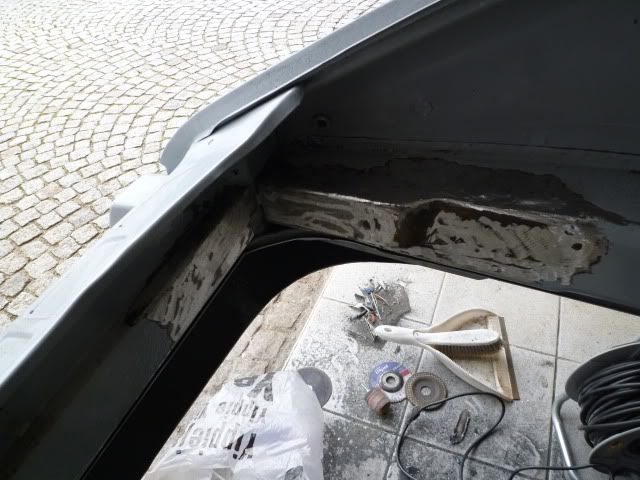

jury 06-12-2011 09:42 AM
I went to Spa Francorchamps afew weeks ago for a Classic event from the same organisiers as Classic Lemans, it was great!! So inspired and motivated (again :rolleyes:) I am ready for the long haul to get this thing finished...
Centre fill Tank measured/aligned and tack welded in place...
http://i161.photobucket.com/albums/t...1/P1000647.jpg
http://i161.photobucket.com/albums/t...1/P1000645.jpg
http://i161.photobucket.com/albums/t...1/P1000646.jpg
http://i161.photobucket.com/albums/t...1/102_3271.jpg
http://i161.photobucket.com/albums/t...centretank.jpg

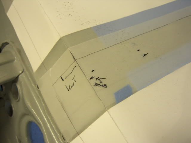

jury 06-12-2011 09:45 AM
Rear 'seat' area fabricated and bolted down...amazed it fits. I originally started this area in the USA 3 years ago and managed to find the original tracing paper patterns! After 4 house moves!!
http://i161.photobucket.com/albums/t...1/102_3244.jpg
http://i161.photobucket.com/albums/t...1/102_3245.jpg
http://i161.photobucket.com/albums/t...1/102_3250.jpg
Get the metal break out again...
http://i161.photobucket.com/albums/t...1/102_3252.jpg
http://i161.photobucket.com/albums/t...1/102_3259.jpg
http://i161.photobucket.com/albums/t...1/102_3276.jpg
http://i161.photobucket.com/albums/t...1/102_3274.jpg
