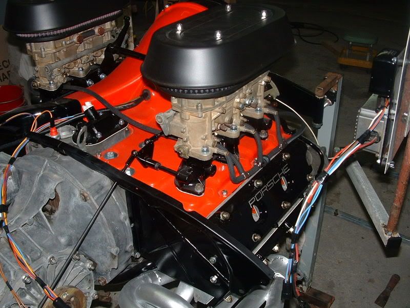

I removed my vacuum system and the solenoid valve. This is on a 2.0 race motor so I have little concern for the idle circuit.
I believe the Zeniths are a superior design over the Webers because the have the multiple accel pumps and they have a high speed enrichment valve. At high rpm's the accel pump nozzle discharges fuel into the venturi thus reducing turbulents in the flow.

i use the dollys too, they work nice
