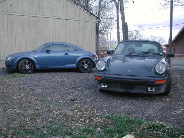

here's the new project sitting next to my old project out side my shop.

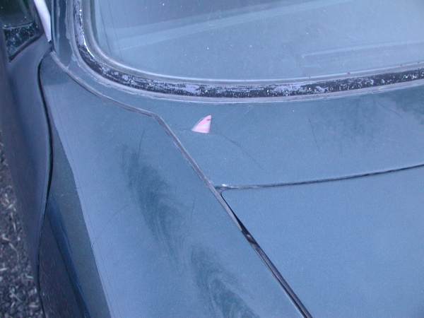

and the main reason the car was priced the way it was
bad paint!...... so far i can tell this car has about 3 full paint jobs on the rear and 5 on the front! yikes!....

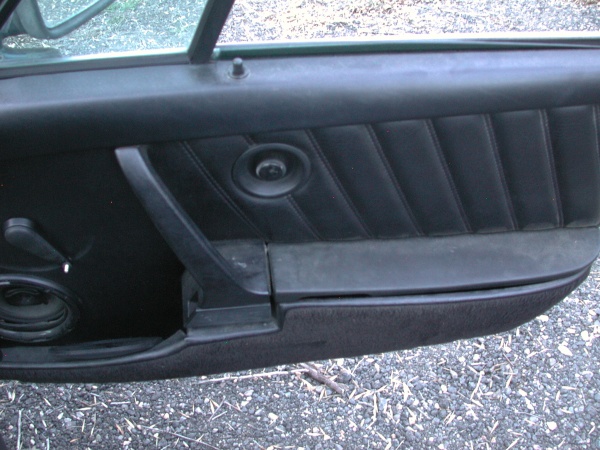

the inside of the car isn't in too bad of shape, but the door cards are falling apart. i hope to set the doors up like early cars with just a pull handle and release lever.

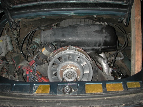

the motor, its not a pretty site but its a good place to start with the upgrades
iv already set in motion the gears of rebirth for this car.

Why putting on 3.2 pistons/cylinders?
i found a good deal on low millage 3.2 p/c's locally. im looking to freshen up the motor and figured why not add some more displacement while im at it.
i don't know 100% of what im doing yet w/ this motor so it could change that's just the plan for now.
Hate to tell you - 3.2 pistons/cylinders are the same 95mm bore as your 3.0. The stroke - same from '72 to '83 - on your crank is 70.4mm. The 3.2l engine got a 74.4mm stroke crank.
Now, if you want to get larger pistons and bore out and replate your cylinders, keep the 3.2s and use them - you can't do it to your existing 3.0 jugs. Give Troy @ EBS (ebsracing.com) a call for more info, they do this work.

iv been searching on the forums and having found any info about how to set door cards up like this.
could anyone direct me to some kind of tech data on what all is involved in changing my door card to be more like this?
thanks
thanks
You can get those door panels from Pelican...
http://www.pelicanparts.com/cgi-bin/ksearch/PEL_search.cgi?command=show_part_page&please_wait=N&make=POR&model=911M&section=INTacc&page=39&bookmark=61&part_number=PEL-APBZ-DP4RVB
Easy to install.
Drive safe!
