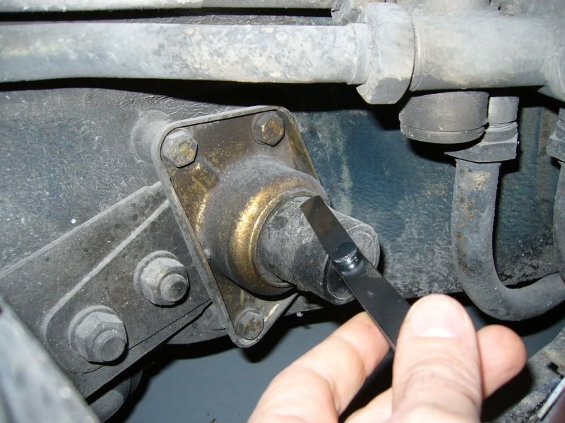

I believe I have a squeaking bushing issue in the rear, which is not all that surprising. Both the spring plates and sway bar are on the originals I believe.
I have ruled out the squeak being in the interior as I completely removed the interior as part of a restoration (new carpets, re-dyed leather etc.) and even with all the panels etc. out, the squeaking persists. Here are my questions that I have been unable to answer through searching:
1) When I bounce any of the four corners up and down, with the car parked in the garage, I cannot hear squeaking… Is it possible that suspension bushings can squeak on the road, but not while stationary? I am surprised, and a little concerned that I cannot hear anything…
2) When I bounce the rear of the car vigorously (by putting most of my 180 pounds on the rear bumper pads) I can hear (and feel) an audible “clunk”. Could this be my torsion bar cap hitting the bushing cover? Or is there a more likely culprit.
FWIW, this is my torsion cap/bushing cover on the passenger side. Close, but still some clearance. On the other side, it appears there is no clearance…
I appreciate everyone taking the time to look at my questions, thanks!

Those spring plate bushing could certainly be the cause.
When under load while driving, the bushing compresses more than you jumping on the bumper. Likely enough to cause metal/metal contact based on the picture. Those are highly deformed.

I agree with Chuck, but you should also look at the sway bar bushings. You might disconnect the rear bar or remove it and see if the clunk goes away. The sway bar bushings are an easier replacement than the spring plates.
Another point I wanted to make is that the'bounce on the bumper' test doesn't work with these cars. The "spring" is a steel bar that twists (torsion bar) and the shock just dampens the recoil. Your 180 lbs won't do much as you found out.
If you choose to redo the spring plate bushings, do the front a-arm bushings up front at the same time, as well as both sway bar bushing sets. You'll be fresh and ready to go after the alignment and corner balance.

You can swap the spring plates side-to-side if the rubber is still in decent shape. Then the fat part of the rubber will be on top and the skinny part on the bottom. After a few weeks, it will be evened out. Works quite well.
+1 on checking the swaybar bushings.

++1. You should just get new neatrix spring plate bushings and put them in. The hard part is indexing the torsion bars, which you have to do anyway just to swap sides. The neatrix bushings are cheap and will last you many more years. One corner balance and one alignment only (that's where the $ is if you do the bushings and torsion bar settings yourself). Many of us have done this as DIY and it is doable with research, questions, a level floor and an angle gauge.

I would agree that it is a short sighted to swap worn spring plates side to side. You still have to do a corner balance/alignment when you are done. And that goes about $600 +/- if it's done properly.
Why skrimp on the parts when you can get proper rubber bushings for a measly $70 from pelican here:
http://www.pelicanparts.com/cgi-bin/smart/more_info.cgi?pn=ERMP-2290003&catalog_description=Elephant%20Racing%20Rubber%20S pring%20Plate%20Bushing%20Set%20Of%20Four%2C%20%39 %31%31%2F%39%31%31%20Turbo%20%28%31%39%36%38%2D%38 %39%29
And swapping sides only solves half the problem. Yes, it flips the 'fat' side of the bushing to the bottom, but it leave an undersized bushing in place.
And undersize bushings will slip to accomodate the rotation, when they should be deforming to accomodate rotation by design. I'll grab a picture to make my point.

The pic above is from a current thread. Notice the bushing is not just deformed, it has worn away. Especially on the left hand side.
Once the bushing has deformed, it becomes loose in the torsion tube / cover plate. It then begins to slide instead of deforming to accomodate rotation (as designed).
Once the sliding begins, the bushing is toast. Wear becomes rapid, as shown. Corner balance slides all over the place.
Flipping the bushing to the opposite side addresses half the problem, at best. The "savings" vs new rubber bushings seems trivial compared to the labor and follow on cost of corner balance and align.
