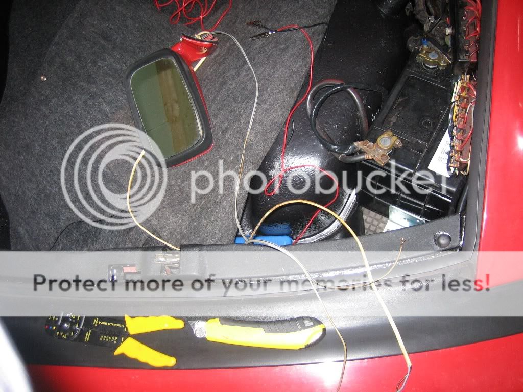

Need help hooking up electrical mirrors
When I started to put in sound deadener inside my doors, I noticed that I had electrical mirrors, as wiring was coming out of them. But they were not connected in any way. My car is originally a 72, without power-mirrors. It has been upgraded to carrera-looks, but the mirrors has obviously never been connected.

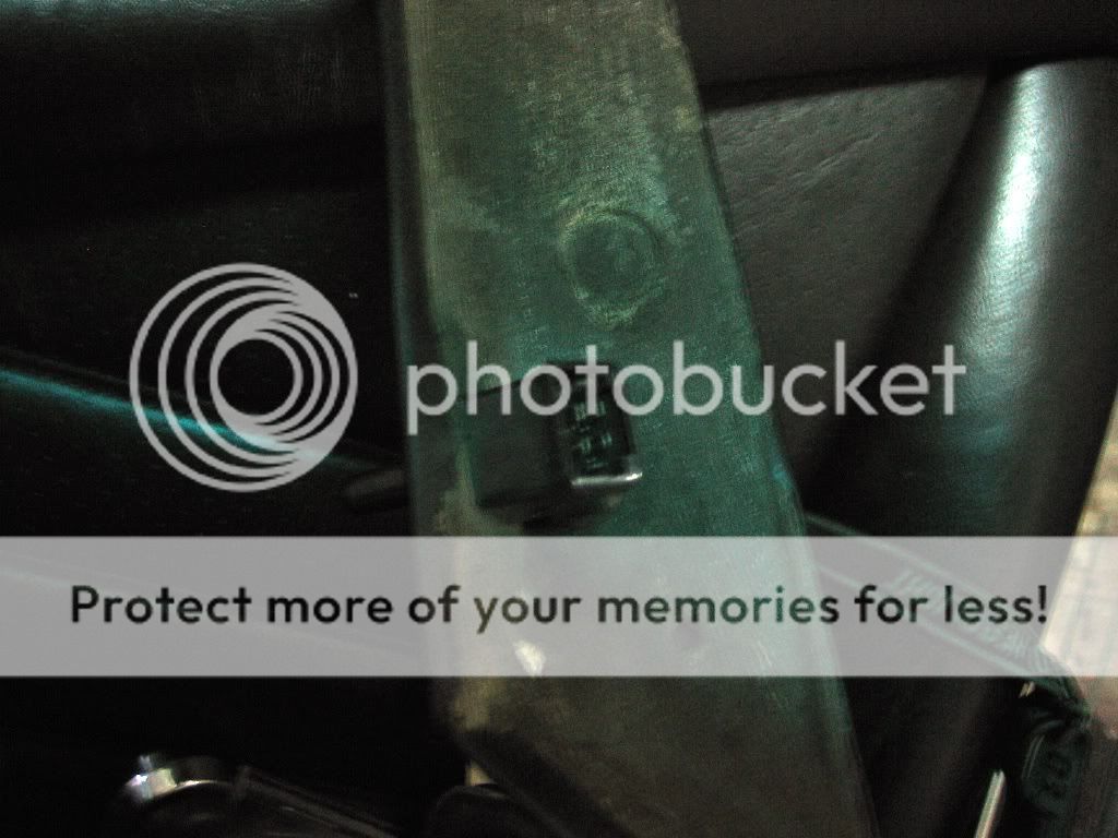

I have the "joystick" on the upper foremost part of the driver door, which shall controll the mirrors, but I don't have the backside connector for it, and neither the switch in the dash that determines which mirror to adjust.
So, can anyone here please help me as to how I should go about installing these mirrors without the dash-switch and without the connector on the back of the joystick? All I have is 4 wires from each mirror, and the joystick with 6 pins on it. I have tested the mirrors directly on the battery to see that they are indeed still operational.

Not an easy question to answer. There are a couple of versions of the flag mirrors and switches and they won't play well together if they are mixed. If you do a search on 'flag mirrors' you will find a wealth of information that will help you determine exactly what you have. Pictures of your mirror's wiring and switch would also help. Once you have that information then you can move forward with fabricating or buying the correct main harness.

Looks like his mirror wiring is questionable. I see 4 wires..should be 6. If it was me I would buy you complete setup and go from there.

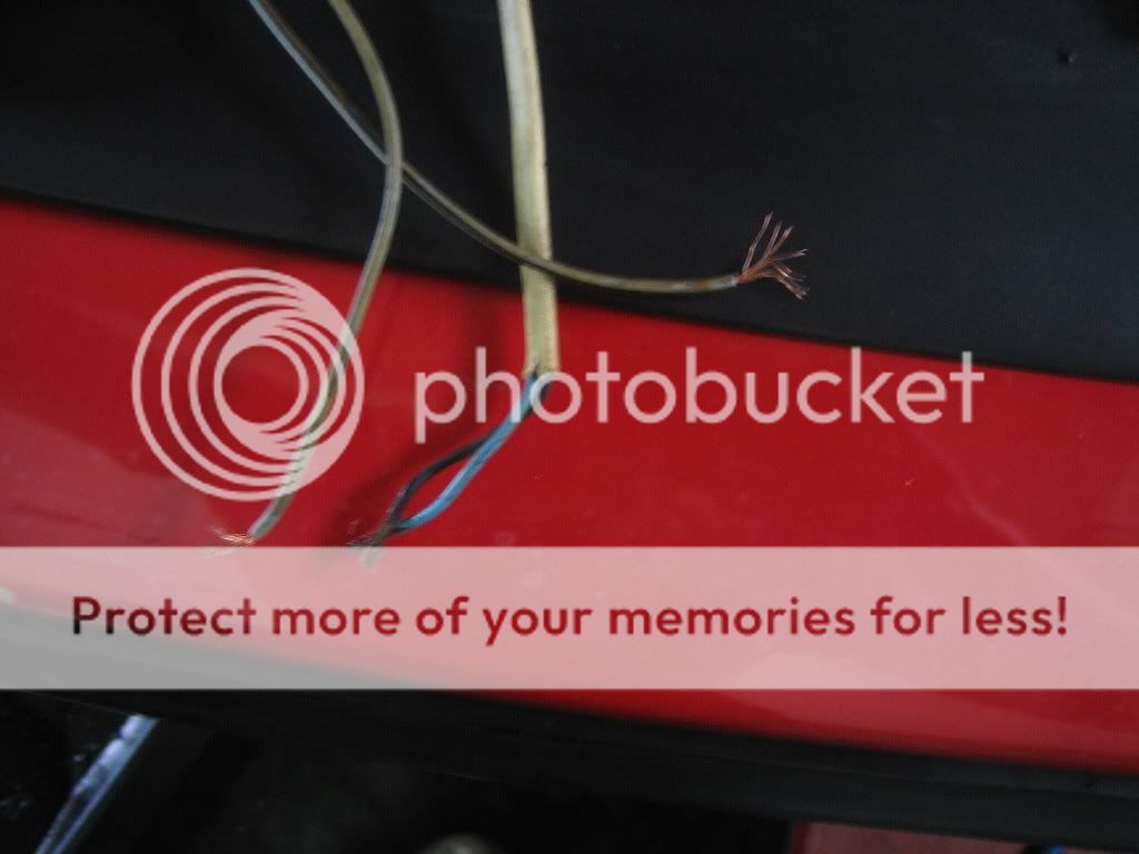

Hmmm. So it should be 6 wires? When I tested the mirror on the battery the other day, I got two directional movements just with the black and the blue wire, by swapping the polarity on them, the directional movement changed. By adding one of the two other wires, the movement appeard along the other axis.
Does this tell you anything?
Rusty, I am more than ready to transfer 35$ ASAP, but will it fit my mirrors? If anyone knows, please chime in fast!

My drivers side mirror plug has 6 wires, but they are doubled up in three of the connector pins Double White, Double Browns, and Black/Blue.
Passenger side connector has only 5 wires, one per pin.

The motor assembly wiring on my car:
2 wires for the motor, Black and Blue on the right side and I had Black and Black/yellow on the left side].
2 wires for the clutch, white and a brown wire
2 wires for the heating elements in the mirror glass, Grey /green and a brown wire.
The motor assembly has a connector. This allows you to replace the unit when it goes bad without rewiring the car! The door harness plugs into the mirror assembly connector and runs thru the door jam, into the trunk and connects to the main harness.
I'm guessing someone removed the heating element wiring on your mirror..which is why I suggested you buy the two mirror motor assemblies from from Rusty so you would have a working set up. I'll look for my wire harness schematic. I decided to document mine when I was troubleshooting the driver side motor failure.
