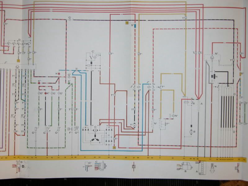

I know it sounds kinds crazy. I was trying to figger out where the actual "control" signal comes from. It's not intuitive, the circuit for the powering the heater fan is simple, a couple of wires in the rear regulator panel and a relay. My conundrum comes from trying to find the signal that tells the relay to power up the heater fan.The signal wire on the flow diagram comes from the 3 lever switch on the dash, the rear window defroster switch, and believe it or not the seatbelt buzzer relay.
Eric
ClickClickBoom 06-28-2009 05:03 PM

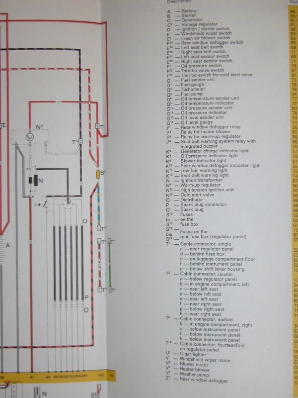

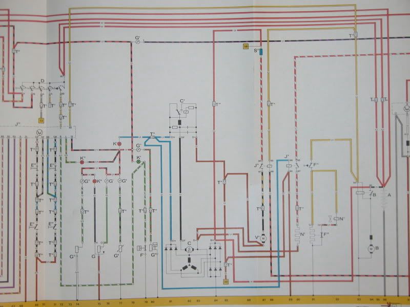

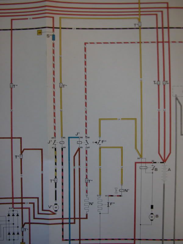

Here are some of the "Flow Diagrams" from the FSM:
http://i71.photobucket.com/albums/i1...DSCN7949-1.jpg
http://i71.photobucket.com/albums/i1...d/DSCN7950.jpg
http://i71.photobucket.com/albums/i1...d/DSCN7951.jpg
http://i71.photobucket.com/albums/i1...d/DSCN7952.jpg
http://i71.photobucket.com/albums/i1...d/DSCN7949.jpg
Start drinking before you try to cypher the bad boys out!
eric

Great!
V4 : Heater blower
J14 : THE relay
Blower
Bottom : red - permanent ground (due to side of diodes, odd color choice)
Top : yellow/black - to relay pin87
relay
pin87 : yellow/black - to blower
pin30 : red/white - always hot (due to side of diodes) via fuse S something
pin86 : red/black - switched hot via fuse S something (due to ignition coil N which must be switched hot)
pin85 : yellow - to the control of the starter B
The seat belt warning (SB) relay J34 is also connected to the ignition/starter switch D. I think it's like this:
Ignition key switch will control the seat belt relay in the following way.
  1. Turning on ignition ('rest' position before cranking) the yellow out of the SB relay is actually connected to ground. Since the complementary side of the blower relay is connected to switch hot, it will blow.
  2. During cranking the yellow out of the SB relay will provide a hot connection for the relay in the starter. Consequently, the blower relay is connected between 2 hot connections and will shut off (no voltage difference).
  3. When the engine is running the ignition key will be in the 'rest' position again and the blower will run again.
Hence, the blower is always on except during cranking! Kinda strange and waste of energy. I think I'm going to wire it differently . . .
The SB relay might also switch some other things off when actual cranking is going on. Because there is a hell lot of connection for a simple seat belt warning relay, even if it has an integrated buzzer:)
Last question:
In the diagram connected to the blower relay at switched hot (ignition coil), there is a blue/yellow wire completely at the right. I got that one too. What is it for?
