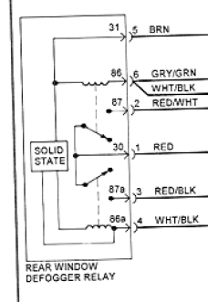

No voltage 2nd stage rear window defogger relay.
I'm about to wire my rear window defogger, but noticed that the relay is not giving any voltage on the second stage connection (see pin 3 in diagram below). In the electrical diagram one can see that there exists an "solid state" unit.
I think this is the problem, but what is it for? And how can I get it to work? I need this since I'm going to use these connections to turn on two separate functions. (defogger and motor compartment blower (got no heater controller??)).
Old 06-27-2009, 08:21 AM
86 911 Targa's Avatar
Join Date: Jun 2009
Location: Manhattan Beach, California. Factory Delivery-Original owner-Retired engineer
Posts: 5,238
I have been flogging this issue for about a year!
Having bought two replacement relays with the same results
as you are having, I finally contacted the folks @ Hella.
The issue is that relay #2 on the PC board is not being activated
by the solid state circuitry.
My best guess is that relay #2 is on a time delay, or cycle profile
by the circuitry in order to prevent rear window fracture.
As you can see by the attached diagram, all voltages and ground
are present.
Additionally I verified element(s) continuity.
Resistor R1 is most probably a factory adjusted setting for a
time constant circuit.
Email me and I'll go into the details with you.

Ah, that makes sense. Thanks for your response and offer gerry50, but I think I can work it out from here on.
I was going to tie all defogger elements together, but that doesnt seem to be too sensible with the potential cracking and all. Than I have to find another way to activate the engine compartment blower, since I got no heater controller (relay). Any suggestions?

Oh, im sorry. I meant gerry 40 off course. Yes, I'm wondering if the separate staging is really necessary? Although, I dont want to take the risks in the winter (with normal temperature I think it makes no difference).
I got a 3.2 and looking at my motronic EPROM it should be around 84.

The two stage is indeed necessary as the center element will not adequately defog your rear window especially if you have a Targa, and live in a very cold climate.
The only time we use ours is on winter trips to the mountains.
However, having friends at, and visited the factory on several accassions, I assure you that the "Porsche Coats" are very thorough folks.
They put that two stage in for a reason.
The earlier 911 (2.7's) had a two position switch on the dash board which,
had time out problems.
Lots of fractured rear windows.

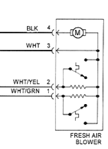

How about the fresh air blower? I took it out to oil it and after installing it again it blows maximum in all positions. The diagram shows some switches to shunt the resistors. What is that all about?

Bad transistor, probably. just check all of the components values/integrity,...replace as necc. Looks to be quite the simplest of circuits.......have you checked (measured) them?

dshepp806, if you refer to the fresh air blower (luggage compartment) then there are no transistors involved. The dashboard slider got some slide contacts and the blower got some resistors as you can see in diagram above.
However, what are those switches parallel to the resistors. They seem controlled by nothing??? In my case they are all short circuiting the resistors, since all positions of the slider result in maximum blow.
Sorry,..I think I was following the first post mentioning no output for the center elements......
As to the switches, not sure. Formally (schematically), it would appear to be duty cycle-related or time based,..or it's a poor illustration of something thermally controlled (although that's not quite the schematic rep for such a device.
Time to break out those (blower) schematics,...let's see..........

Ok, Doyle. That makes more sense. In the meanwhile it gives 12V so I connected center element to 1st stage and upper and lower elements to the 2nd stage. I haven't checked what the exact interval is of the 2nd stage, but it is on right at moment I turn on the 2nd stage. Any idea what the interval is. Is it a matter of seconds or minutes?
