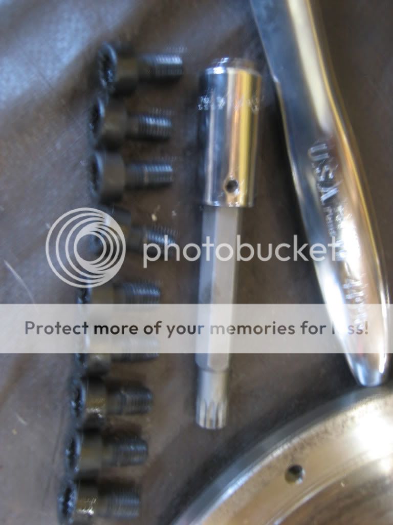

unless you are certain that no Red Loctite was used when those bolts were installed, I'd hit them with a torch before smacking the head and using impact to loosen...
LeakProof 07-09-2009 11:16 AM
A torch is not a problem. I wish I would have thought about that two hours ago when I broke 6 exhaust studs... Ouch.. Man am I butchering things.
Leakproof.
porsche930dude 07-09-2009 02:33 PM
yup i find even a little propane torch can go a long way loostening things
safe 07-09-2009 02:43 PM
Porsche didn't use loctite from the factory, if that helps.
LeakProof 07-11-2009 11:59 AM
This was so easy it was ridiculous. Thanks Pelican for the quality tool. I can't believe how fast you got it to me. These bolts came out like butter. Perhaps spraying them with penetrating oil every day for a week helped. I actually feel a little silly.
thanks,
Leakproof.http://i472.photobucket.com/albums/r...anaz/004-6.jpg
RWebb 07-11-2009 12:21 PM
"every day for a week"
time & tapping on the thing are the key factors in using penetrating oil effectively
I don't see anything on the threads so looks like red loctite was not used - a torch alwyas helps persuade the fasteners that they are unwelcome tho...
LeakProof 07-11-2009 08:43 PM
Yea, I hit each one with a hammer before I successfully removed them.
And from what I understand they do stretch. So I will order nine new fasteners for re-assembly.
Leakproof.
