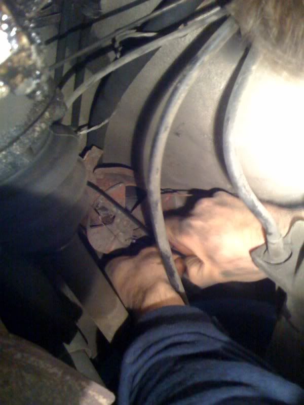

Ok so was under the car, and the flapper boxes need some freeing up via PB Blaster...so I am working on it. I still don't understand what opens and closes the valve in the flapper? With the auto heat control, is it turning the rotary dial? How about the temp slider on the dash? I could not see what would move in the cockpit b/c I was under the car. All help appreciated!

The flapper box mechanism all works as one motion. The cable that's coming from the tunnel on each side of the trans pulls/pushes on the flapper 'door' to open/close the holes. The parts inside of the flapper box that move you don't really get a chance to look at, unless you take the whole flapper box off the car. Which is usually a PITA.
If your cable coming from the tunnel is actually broken, you should be able (once you free up the flapper doors) to close them by hand and tie them closed.
If the cable is NOT broken, it may be hard to manually close the flappers under the car, unless you unhook the cable from the flapper box. 7mm, don't lose any parts and remember the sequence of bolt/flapper/washer/cable/nut.
I'd say soak 'em with the PB blaster and then after a day or so try to move the controls between the seat again. Someone needs to chime in about how the auto heat works, too.
If your car has an owners manual, maybe check out the auto heat section and make sure you've got a handle on what the controls are supposed to be doing, too.

Was able to go to my buddy's lube shop and get under the car via the pit. We zip tied the flapper boxes some of the way closed and voila, an intense amount of heat...they are in better condition than they appear in the photos, the passenger side was a little bit stuck and a couple of shots of PB Blaster and it freed right up.
