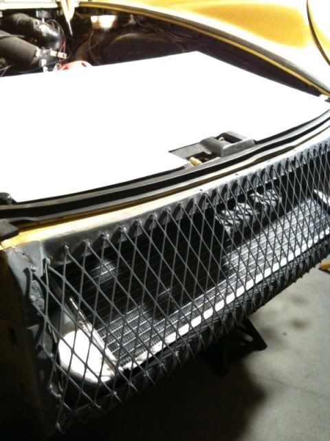

I looked at his setup and Ken has limited his air flow to the rad. by using the oil cooler opening but I would still think when you start getting above 100 the effects will be more pronounced I may be totally full of poop hope someone else will chime in that has experience with this at higher speeds than 100 I know I have lots of ground effects on my car and the handling chara. changed at 120 and again at 140. Good luck and just be aware of the possibility at speeds above 100 there will be handling changes most likely understeer.

Take a look...
Mine:
http://i18.photobucket.com/albums/b1...an/photo-6.jpg
His:
http://hatfield.homelinux.com/cooling/38.jpg
I don't get it? Please point out the differences... Also, my bumper is..
http://www.octanemotorsports.com/images/EXD-1053880.jpg
Which will be ducted on the underside to feed the rad, just as Ken has done..

An idea would be to seal off the bottom and duct the air out the side into the wheels wells and use it to cool the brakes ala Matteo's car. Just a thought. I would think at >100 Ken would have the same issue maybe not I am just going off how the ground effects are setup for high speed road cars they duct the air out and up away from the bottom.
mbaran 12-27-2009 05:54 PM
I feel better with air coming out the bottom, rather than reduce the structural integrity of the entire front of the car by cutting away the sheet metal around the wheel arches and replacing it with a mesh.
The 50+LB of coolant, radiator, pumps, hoses will have more effect on downdraft than the 2800CFM fans will at full tilt. The fans are totally sealed to the radiator, and you cannot pull the air through the fins that quickly.

I too believe that cutting into the frame, ala the 3.9 RSR project, or a Rod Simpson type cooling system, wouldn't make me feel real secure at speed.
I would believe that the front valance design would be important and mbaran's would push more air under the car that the 930 type that I have, which, in theory, should push the air around, more than under, the car. I would think ride height would be an important variable, as well. My car is set to 25.5 inches ground to the bottoms of the fender openings.
I do know that connecting ductwork between the valance and the radiator box made a difference in fan run times and coolant temperature. The ductwork being connected made a huge (positive) difference. That being said I can only conclude that the air naturally wants to go around and under the radiator box, between the valance and the frame opening, unless forced into it.
My car is probably helped by having a the additional weight of the larger renegade full tank as well as the condenser, radiator, coolant, etc.
I suspect that the handling will change at some speed, but it won't be 140 as I'm electronically limited to 135 :).

mbaran 12-27-2009 06:39 PM
Ken,
How much temp change did you see with the ducting straight to the rad vs. without?
My car is very low, and with the splitter installed below the bumper, there is only a matter of a few inches between the ground and the bumper. The vacuum under the car will more than make up for any added air.
Did you notice any change in handling by pumping that air out underneath the car? My guess is since the underside of a car is a low pressure area, it just sucks that air from the back of the fans and is negligible.

By cutting the gas tank in half you lost 9-10 gallons of gas I suspect at 7-8 lbs per gallon you lost 60-80 lbs of weight and added about the same the structural part of that area is above and below where you would attach the duct and my thought is if it reduced the structural integrity that much then why did they do it on race cars. Another thought is you cut the gas tank in half which is attached to the frame in a triangulated format when you cut it in half you take a third of that away and add flex.
mbaran 12-27-2009 06:52 PM
The gastank is also fastened to the car with like 3 flat washer plates. It's not structural as much as the front sheet metal is.
I'm not saying there arent other ways to doing this, I'm just building a kit that mimic's the kit of Renegade Hybrids as best as I could and pretty much how I've seen every front radiator'd 911 done.
I'm sure there will be course corrections as we polish the final product.

pt109 12-27-2009 08:36 PM
mbaran,
The temp difference was on the order of 15 degrees Fahrenheit.
I didn't notice any handling difference with or without the ductwork.
I was going by the picture you posted earlier in the thread which didn't
show a splitter. The splitter should indeed help increase the vacuum
under the car.
