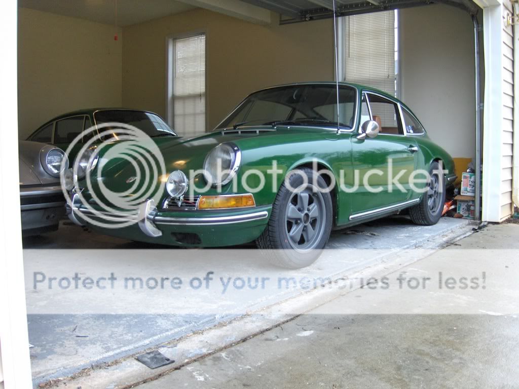

Tuned the car over the past couple of days and it runs MUCH better. Just about ready to try my 95 mile commute in it.
Got some Thru the grille type lights and went ahead and came up with a bracket to mount them. Since they are not the real deal and my grilles are not dead I wanted to mount them without drilling any holes or cutting anything.
I went to Lowes and was going to buy some aluminum and make a bracket and then I saw this "T" type door hardware and thought it would work with 2 bends.
I then took some stock Aluminum I had and made a bottom plate to make a sandwich mount of sorts. I think it turned out pretty good for 6.79 and an hour. I took some quick shots but will get in there and knock of that surface rust in the fenders when I take the bumpers off to touch them up. I may have to lower them a little, so I may have to spend 3.00 bucks for the brackets to do again but I am pleased that it can be done.

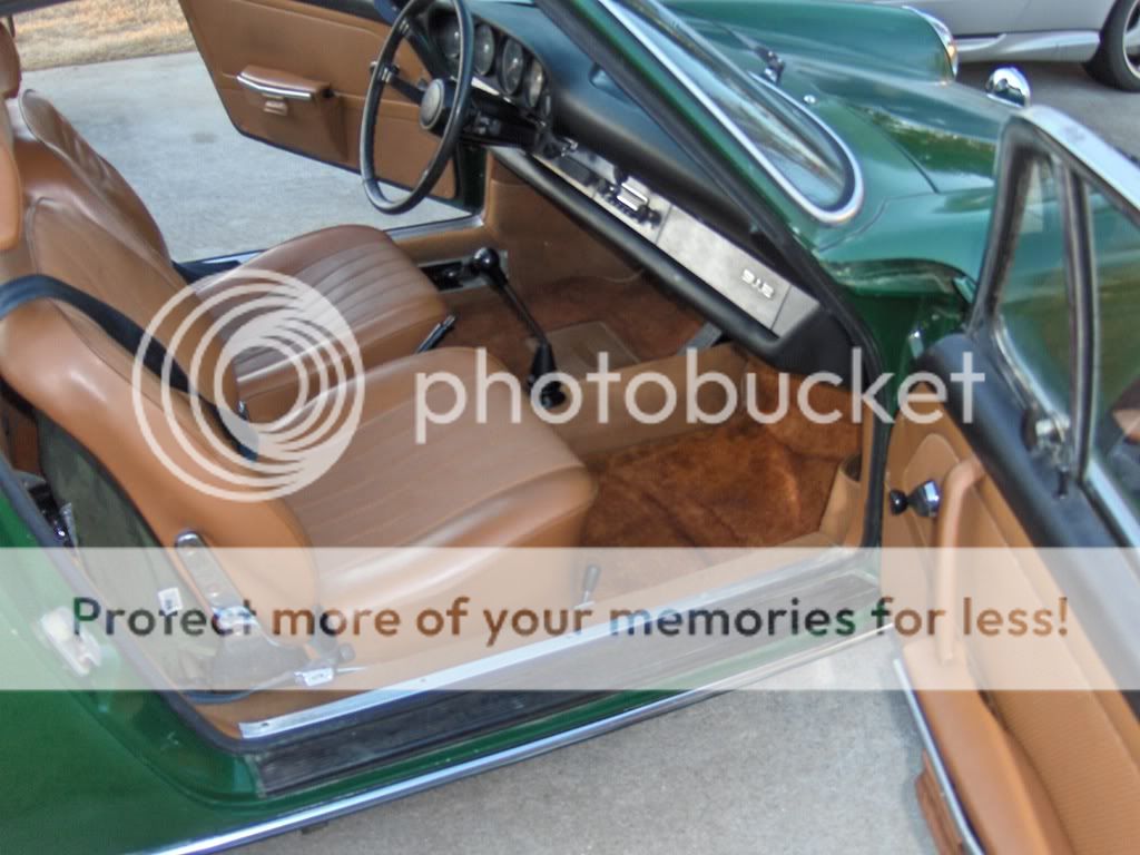

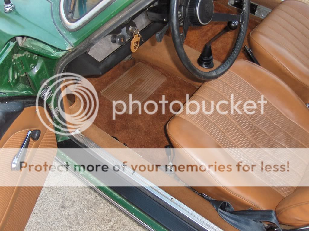

I put the car into some daily driving chores this past week and it has performed very well. I had to fix the heat, broken cable that took 3 hours due to the cable coating getting stuck in the tubes.
On the carpet I could not get the shaving method to work out as the shaver kept cutting out so I went to the Hobby Lobby and found some Tan fabric dye that is pretty much a perfect match. You have to boil water, add the dye and let the carpet sit in a big tub for an hour. Turned out pretty good.
