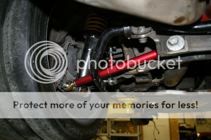

Latest progress.. Ralph and I installed the KW V3's, Tarett drop links, Walrod bushings, and TRG sways. I think I'll have to get RS rear drop links, the tarret drop links don't seem to be long enough to be used with the KW V3's and TRG sways. Right now the biggest hold up is a missing oil cooler bracket.
http://i674.photobucket.com/albums/v...r_parts021.jpg
http://i674.photobucket.com/albums/v...r_parts034.jpg
http://i674.photobucket.com/albums/v...r_parts046.jpg

Bill Verburg 04-12-2010 11:09 AM
I'm not sure what the tang on the shock body looks like but for JIC you need to use long tangs and RS curved drop links
here you can see the RS drop link secured to the incorrect short tang, the required long tang is below
