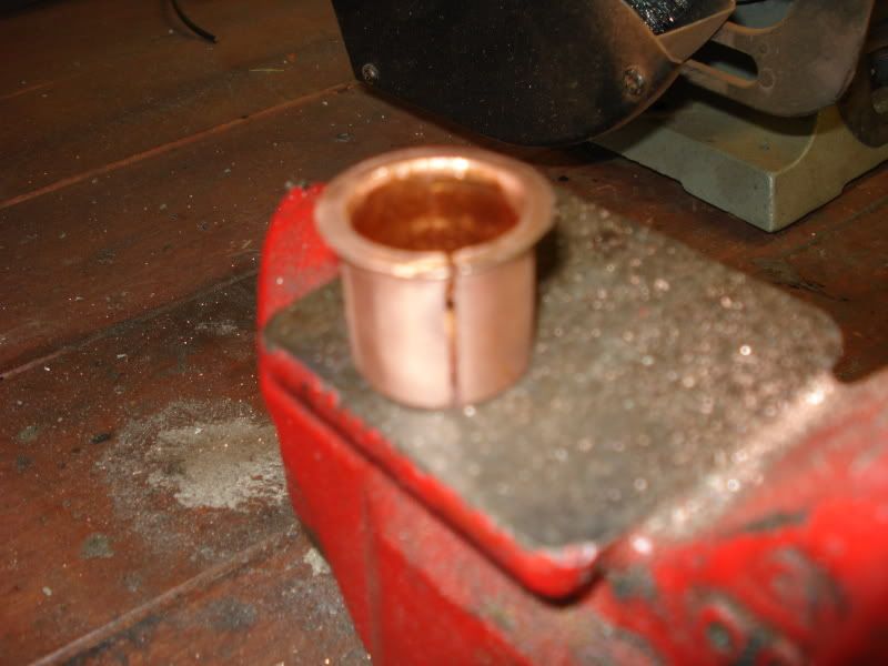

Well eventually the plastic bushing on the steering column disintegrated completely. So instead of ordering a new one I decided to DIY it. So removed the horn pad and steering wheel and the c ring. I had a section of 22mm copper pipe in the garage. Now I was a plumber way back in the day and still have all my tools. So I put a 22mm swedging tool in one end of the pipe and flared it out a bit. I placed this piece over a 19mm socket and placed in the vice and tapped down the flared end of the pipe till it was at a 90 degree angle to the main section of pipe. Then I cut a slot longways about 30mm then cut that off. I dressed up the sharp edges with the dremel tool and expanded the section to fit over the steering column OD. Slid it down and tapped into place, perfect fit. I reckon the copper will last a lot longer than the plastic piece and I saved myself some bucks. Sorry did not take any pics but it is an easy cheap fix.

Davy: I admire your ingenuity, but it appears that what you've done is simply recreate the Pelican part -- the 928 sleeve -- out of copper. I wonder how long soft copper will last in that environment, or whether it will throw-off any pieces that could become lodged somewhere in the steering column.
In my view, there are a few places that DIY/home-brew fixes shouldn't be undertaken. Steering is one of them.

Scott, after you read the Rennlist post you may wish to reconsider your concerns, this really is a relatively minor but very annoying problem. If Davy has created a tight (interference) fit with the copper piece he made, he will address the concerns discussed there (2nd page is most of the good stuff) with the 928 part causing wear. Copper plenty malleable so unlikely to shed chunks, especially if it is well-wedged - if I can't modify the 928 sleeve to wedge I'll try Davy's solution myself - Edge Gel caps may have real competition!
Also even with this bushing completely missing, it just feels horrid but it won't cause any harm, damage to controls (it sure feels like it would though!) or a steering failure. Unlikely one would want to drive even 7/10ths with the way this loose wheel feels, too. Parking is particularly unpleasant.

Hmm did not realise this post would lead to such controversy! Let me just point out that I am in no way suggesting this as a permanent fix. I read with interest BarryJB that the Pelican part is self lubricating? Wonder how that works. The copper I used is not that soft it is for domestic water supply use and I have seen pipe that has lasted 50+ years in daily use, so cannot see it suddenly disintegrating after a few months. Copper is very maleable and is actually self lubricating to a point due to the patina created naturally. As for it throwing off chunks...please... Anyway I have re-recreated the Pelican part from copper and it is a quick fix while I wait on an order which in my part of the world can take up to a month.. Glad such a small issue led to such hot debate.

I also made my own copper bushing on my 85 also. I made the bushing a drive in fit so there is no chance of wear. You rely on the bearing that is why it is there. The only thing that can fail is the bearing. From what I have read the 928 sleeve is not a tight fit so you will get wear from the column spinning in the bushing.

windsoreight your copper bushing is exactly the same as the one I made. And I agree it is a drive in fit therefore the actual bushing is seeing all the movement, the copper one is basically to support the steering column from flopping around.
