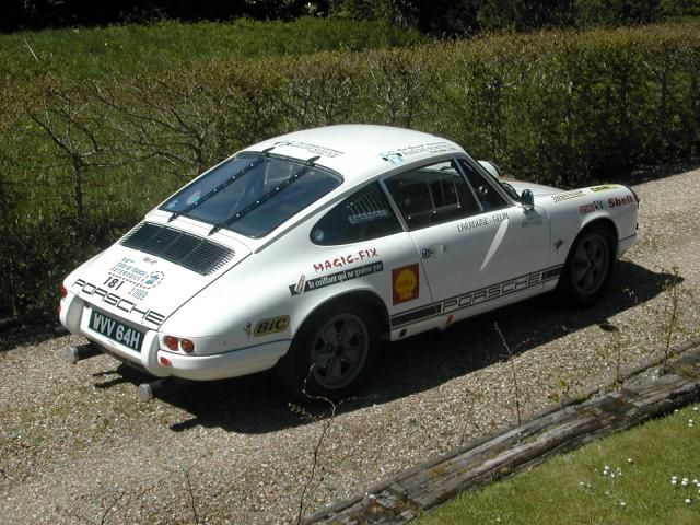

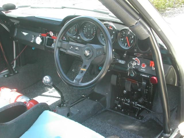

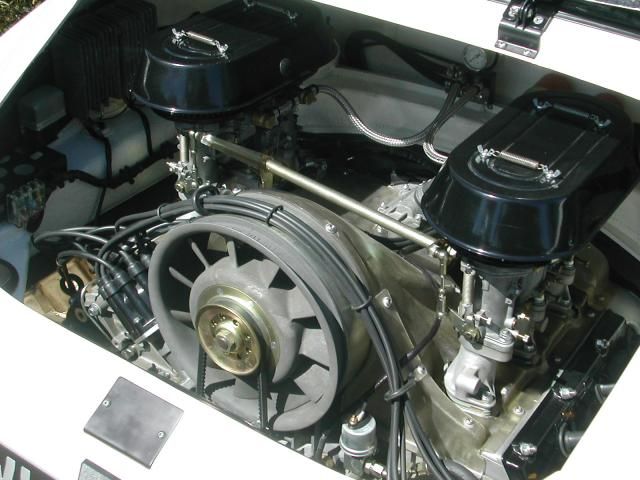

haasad 06-04-2013 12:34 PM
1975 Euro 911S is now a 2.8 twin plugged carbed homage to the 1969 TdF winning R of Guy Larrousse and Laurent Gelin.
10 years of effort but worth it I think.
http://i171.photobucket.com/albums/u...psfcdf0f31.jpg
http://i171.photobucket.com/albums/u...ps07d94104.jpg
http://i171.photobucket.com/albums/u...psb7e11e97.jpg
http://i171.photobucket.com/albums/u...ps6d71d58f.jpg
Rodsrsr 06-04-2013 12:45 PM
I'm wondering why so many people take the time/money to do a beautiful complete backdate but than use the wrong mirrors and wheels. It makes a very realistic looking long hood look like, well a backdate. IMO.:confused:
haasad 06-04-2013 12:59 PM
from my position...
Couldn't afford those 7 inch by 15 fuchs for the back, don't like silver and black.
Like Durrants but not the fact I can't see behind so made a new mount.
You might also notice the "wrong" pedal box, cage, headlamp covers, door handles, airfilters , dizzy, arch flares, wheelbase... etc etc .....;);)
They are "correct" NSU front lamps though....they were cheap:D:D
Andy
