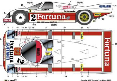

Oh, and to answer your question, Jille: I personally prefer the classic Gulf/Wyer livery.

if you have any pictures like this one, but from a 917, I can use it as a guide for drawing a paintjob for the car...
