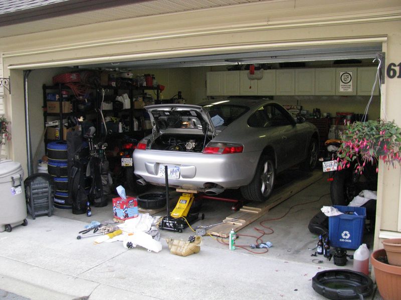

I bought my first Porsche, an early SC, in 1997 and by 2007 it had been transformed into a bare bones carbureted monster. The car was the very essence of 911 sporting. Problem was I didn't drive it much because of kids and work, neither of which fit my 911. I worked on the car a lot though, it always needed something tweaked or replaced. I plain spent as much, or more, time under it as I did in it.
Anyway - I gave my head a shake, sold the 911 and bought a Seal Grey 2002 996. I'm not looking back. In fact I liked the 996 so much that I bought another one after I was forced to sell the first one because of a temporary transfer out of country. I have a Silver 2002 now and it is a fantastic car.
*My car in current state alongside a mate's MkI
The 996 has been a dream to own. It is *much* faster than a 911 and it handles superbly once I installed Bilstien PSS9 coilovers. It is easier to work on than the 911 was, but of course it requires much less maintenance since it's a newer car. My Silver car had a new engine installed under warranty at 40K miles (before I owned it) but the paperwork is not clear on why. It doesn't sound like it was a catastrophic IMS failure like...perhaps an intermix issue? My Silver car is now approaching 100K miles and it looks and feels like new inside and out. My old Grey car is still going strong with the original engine with 75K miles or so on it. The new owners elected to install the L&N IMS upgrade as a precaution.

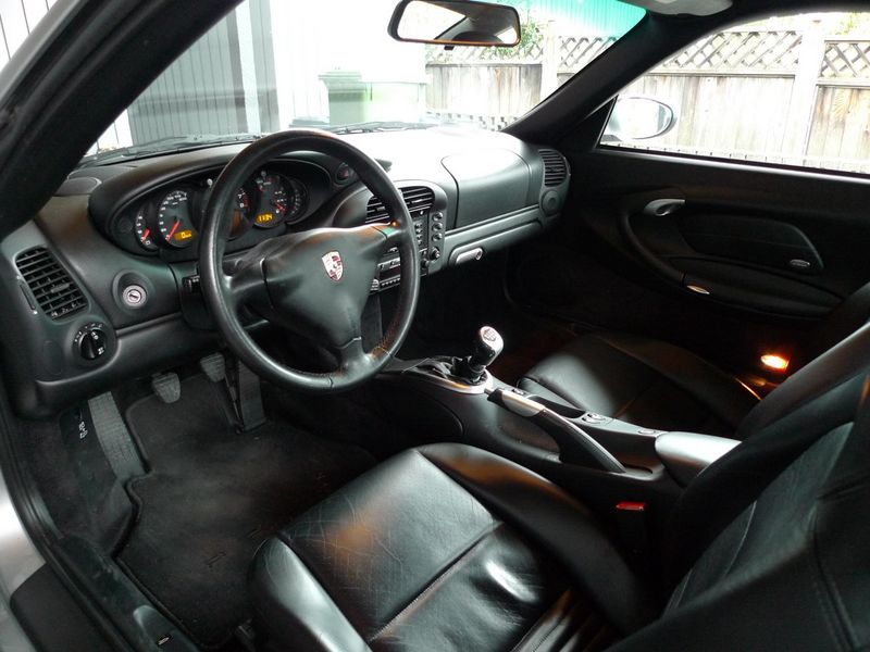

*On lift at buddies house replacing the coolant tank.
*Interior with console delete "installed"
