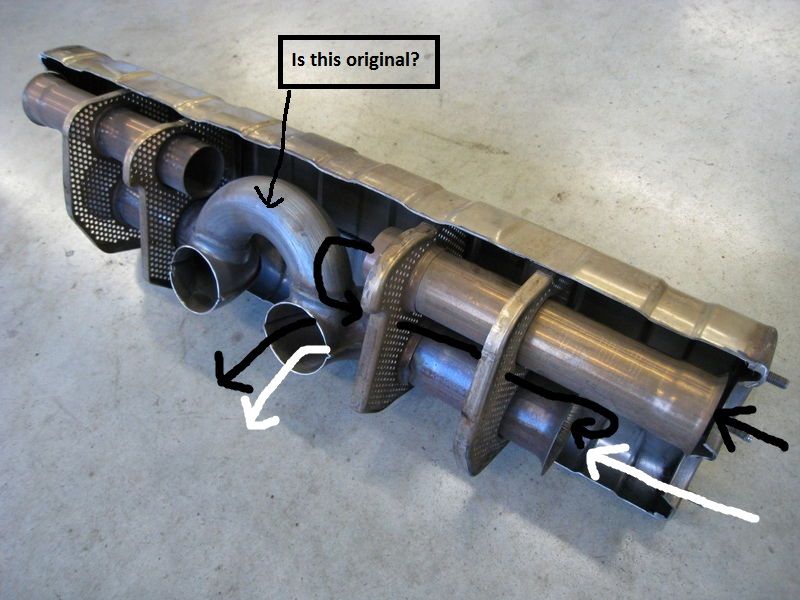

Originally Posted by Steve W (Post 5628339)
That exhaust looks so nice. Im dreaming of copying your idea.
What kind of noice it makes? Have you measured the noice level? Would you happen to a clip of the sound it makes?
I was wondering about the flow in the muffler? Is it like this:
(Black arrow when the valve is closed and white when open)
http://i216.photobucket.com/albums/c...1287700974.jpg
Is the crossover a modification done to reduce the drone? Did it help?

Steve W 08-31-2012 02:56 PM
The crossover is original, nothing was changed internally. I don't know if that crossover was done for sound, flow, or both. I would suspect for flow first as we've dyno'd 911 race cars with an open exhaust making a bit more torque and power with a crossover vs without. I believe the perpendicular T of the crossover allows the pulse of the opposite bank to create a vacuum in the T, reducing the backpressure of the other bank.
No db measurements, but it is not anywhere as quiet as a stock car. I would describe it as 'controlled loud'. The sound is deep, healthy, and unrestricted. With headers, normally resonance and drone exists between 1500-2700 rpm with or without mufflers, then goes away after that. Similar with this setup but not as loud and noticeable when the valves are closed, then gets really quiet from 3000 rpm on, so the exhaust valves programmed to switch to full open, and as you pass 4500 rpm, it goes into a full incredible wail. When the valves are shut the overall sound level is reduced by about 6-8 db. A MSD rpm switch controls a OEM Pierburg vacuum solenoid from a 997 GT3, providing vacuum from a 944/964 vacuum canister to actuate the Pierburg exhaust valves. If you're ok with loud cars, driving on the street is fine and should not be enough to get you pulled over. Though, when you floor it, after 4500 rpm, the exhaust note is completely open and when you merge both exhaust banks together in the center, the acoustic coupling creates loud a high pitch wail. This is as opposed to an exhaust with separated outlets, such as megaphones with have a very loud but deeper note that is about half the pitch. When the valves are full open, a 30-40 mm gap between the intake pipe and outlet pipe on the larger pipe allows the muffler to remain as an expansion chamber to perform reactive noise attenuation, keeping the exhaust note similar to but just a few db short a track car with an unmuffled 2 into 1 tailpipe at high rpms. The sound at full throttle in the upper rpms is somewhere between a typical 911 race car with open exhaust, and a GT3 Cup car. The 997 Cup cars in fact use something similar to this muffler, just use the lower inlet and block off the upper inlets. Since they are 3.6-4.0s and run much higher compression, they have a bit louder and harder exhaust note.
The flow diagram you've detailed is exactly how it all flows.

Bill Verburg 09-02-2012 08:33 AM
Originally Posted by Steve W (Post 6947789)
The crossover is original, nothing was changed internally. I don't know if that crossover was done for sound, flow, or both. ....
The X-over is a classic drone/noise abatement strategy
look at the flow path, in at the top, where the combined flow of both banks pressures the containment vessel, there will be close to uniform pressure at all points w/i the containment. Flow will be out the bottom, sound waves are bouncing around all throughout the containment, the goal is for some of the peaks and valleys of the sound waves in the outlets to meet and cancel each other, similarly the internal perforated screens break up the sound waves, often there will be f/g or ss packing wrapped around perforated tube to additionally absorb sound waves, though that strategy appears to be missing in the muffler picture, The factory mufflers also incorporate shaped containment walls which reduce sound vibrations that are often set up in slab sided walls.
