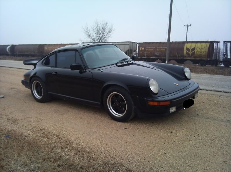

here she is:
i took the pic while waiting for the tow truck

Beautiful car! and welcome.
