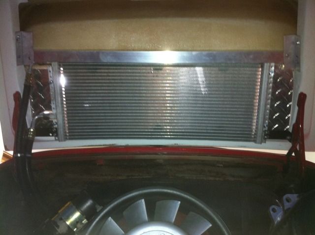

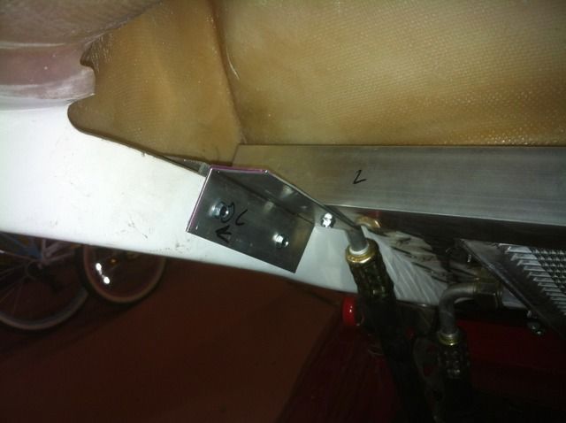

Here's how I mounted my condensor in my new FG ducktail:

Josh it looks like you are making your rear condenser install look nicer

Just fine actually. If I manage to get covered parking at work, I have a cool cabin within minutes on my drive home. If it's been sitting in the sun and gets heat soaked, it's more like 15 minutes until it's comfortable
You will need more surface area in your rear PFC, To be honest yours is just not big enough to get your temps down quicker and lower for what you really need!

Josh D 08-16-2012 01:08 PM
Originally Posted by KelogGes (Post 6915337)
Josh D are you running the stock OEM tube and fin front condenser with your newer rear deck lid PFC?
Yes. And I wish I would have replaced it when I did the upgrade. When I removed it to clean it, a lot of the fins were brittle enough to desintigrate in my hands.
It will be replaced down the road.
Josh D 08-16-2012 01:15 PM
My cabin temps drop from when the car is sitting parked sitting in the sun at about 93 ambient and I step inside and the cabin is 150 plus +++ and I drive about 1/4 to 1/2 a mile or so (just a few blocks) in only a few minutes and the cabin starts to cool good with low 30s vent temps. but i have not been monitoring cabin temp
only vent temps.
http://forums.pelicanparts.com/uploa...1344737943.jpg
Apples to oranges. I'm dealing with much higher ambient temps (110*+) than 93*. You would need more condenser area as well to get the performance you describe. My A/C works very well up to 105*. Beyond that, I need more condenser. At some point, I'll upgrade the front condenser, but I'm not interested in adding the weight or complexity of fender condensers and fans, even if it improved my A/C at temps above 105*.
