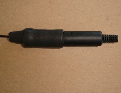

When I was a Noob and still feel like it some times. I built a shroud with parts from Home Depot and Electronics store.
http://img.photobucket.com/albums/v5...COA5OG/o2s.jpg
http://img.photobucket.com/albums/v5...OA5OG/o2s2.jpg
It worked but, I did not solder it properly and it broke off. so I went with the Bullet Spade with Water Proof insulation.
If you want OEM look this is how you can do it.
You know while I was taking the earlier pics, I placed a 1.5" piece of 3/8 hose around the male connector so the holder held it firmly, realized I did not like it being loose. OK I have OCD :(
DRACO A5OG 07-03-2011 07:17 PM
Now the New & Improved version 3.2:
http://img.photobucket.com/albums/v5...703_191556.jpg

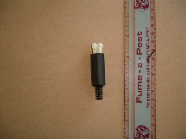

http://www.idylwilde.net/Porsche/01.jpg
http://www.idylwilde.net/Porsche/02.jpg
maybe this gives a better idea of what im dealing with. Im not so sure i can tackle it, those wires are very thin. I tried separating out the inner signal wire from the outter mesh and plugged that into the o2 sensor but did not hear any change in idle, so dont know if that worked.

DRACO A5OG 07-03-2011 10:09 PM
^^^ LOL ^^^
OK,
I see the metal mesh shield, green wire cover then the copper strand wire underneath. Am I missing anything?
If not, you are good with the Bullet Spade Set.
The green thing in the connector is piece of the green wire cover that snapped off.
Simply slip some heat shrink on then solder that copper strand on to the Male Bullet (prefereably water proof type a FLAPS will have it, i.e. Pepboys is where I got mine)
Heat Shrink that Mesh and end of the Bullet where you soldered it.
O2S, solder the Female end and then heat shrink it for extra measure.
Prior to soldering, make sure the Bullet set is nice and snug, if loose squeeze the female side. Better safe then sorry with a loose connection.
That's it brother.
