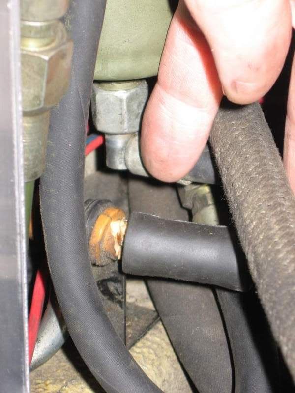

It was a tight fit because my 3.2 O2 wire was too short to work on so it took me couple of tries to make a solid solder. As far as the wres, the 3.2 sensor and heating wires were designed seperately so I left the OEM heating conectors alone and just butt spliced the O2S side on to it.
Top is the Mercedes Logo-ed ( on the other side) heater connectors and the bottom is the O2S rig with water proof sealed bullet connector with heat shrink. I used the OEM connector metal clamp/holder to keep it where it should be.
I pulled it out a bit to show you the work.

Where you see the yellowish shield/tube use to be where the 3/8" OD OEM connector was. Underneath was the metal mesh shield. Liken to a coax cable.
I simply stripped it and the green outer layer away and solderd the Male Bullet and finished with Heat shrink. The O2S side I spliced the matching Female spade and finished it off with heat shrink for extra measure.

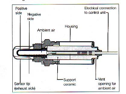

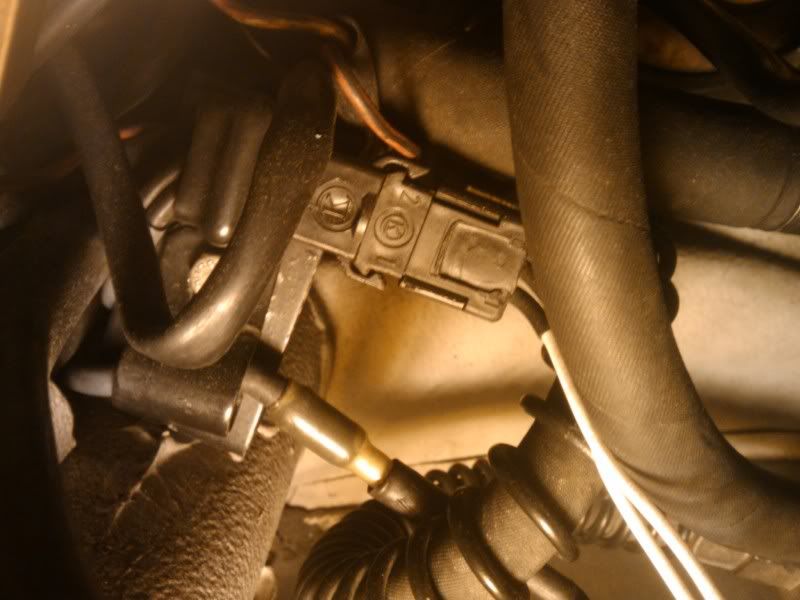

This what mine looked like prior to fix:
Indeed the mesh goes back to the DME as a ground but strangely enough it terminates at the crumbled connector with absolutely no indication it grounds to anything. In fact, the Female shroud ( O2S Side) only receives the signal feed and nothing more.
It is however well insulated by the rubber shroud and crumbled plastic which was white in color in the beginning of it's life. Solved this on my mod with heat shrink, sorry to sound liek a broken record
Also did a bit more digging and found the "air" sample appears to be from the sensor itself as described in BOSCH's own cross section:
