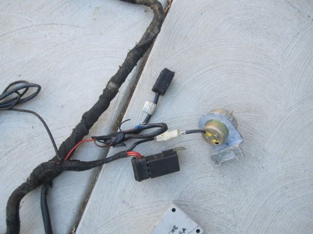

I need help to identify where these 9 wires coming from the front of the harness (from DME)
Colors
thick red
medium red/green
thin purple/black Tach
thin black Tach
thin black with current running
thick black
medium Yellow
thin green yellow
thin green/white
Here is what I know so far
Thick red wire goes to Battery but I see it needs a fuse what is the fuse it needs ?
Thick and thin black wire (with current) go to the 4 terminal(15) (right?)
Thin black (no current) goes to tach (but where ????)
Purple/black goes to Tach (but where) A photo would be nice
Red/Green goes to fuse terminal 3 (right ?) 25a (where 25a??)
Yellow is Start signal right? but where does it connect ? (photo)
The next two are A/C related I assume but I am not running a/c
although I do have the heater control in my dash (only) no other knobs or controls
Green/yellow a/c compressor switch ..where does this wire into ? (photo)
Green/white a/c Related ...where does this plug
SO if someone has photos where these wires connect a little bit of help would be appreciated ....

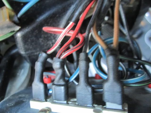

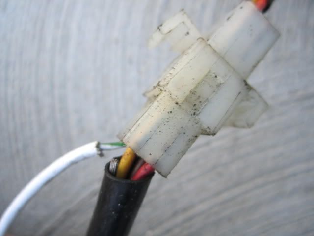

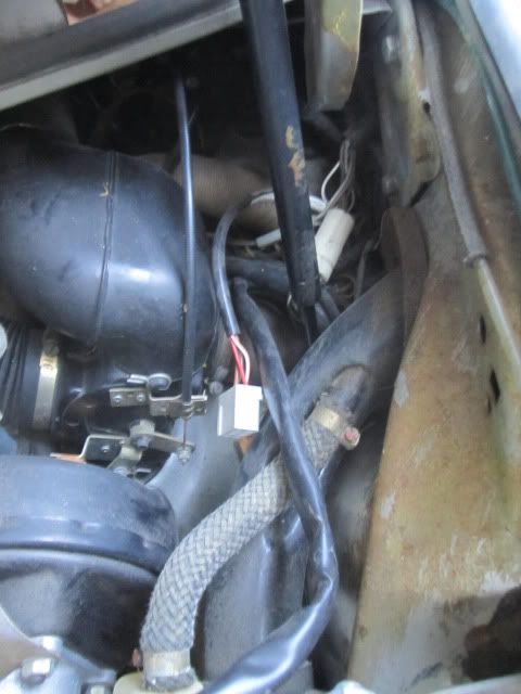

Are these heater blower cables ?
colored wires (yes I'll fix the damaged wire)
Where does this green/white wire go ....it is A/C related but Im not running a/c
Where does the blown and black wire connect to ? are those ground for the seat ?

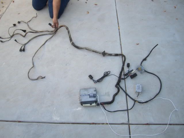

complete look of the harness for the 1984 911 3.2 Carrera ROW
Easy to work on interior

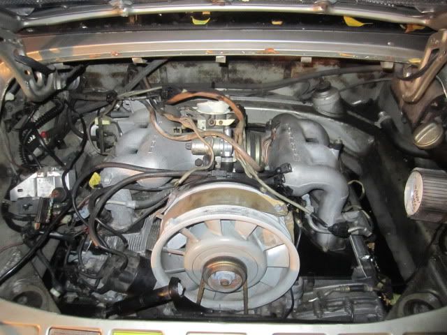

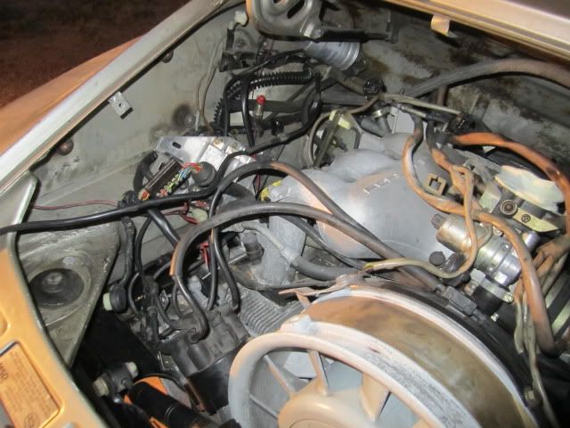

current state of my 3.2 engine in the SC
still need to extend the wires for the tail light harness

I got The 3.2 Carrera DME wiring harness to front trunk soldered, shrink wrapped and routed through the trunk.
Figured where the 7 of the 8 wires that lead from the DME to the front trunk fuse box.
-Thick Red cable to battery cable was routed but not connected yet.
I looks like I could use the previous existing red battery wiring that was already there.
Maybe I could wire it together if I find where it comes from.
(3 Red cables were already wired to the positive battery terminal) <---????

what to do here????
-Thin back wires x2
I still don't know witch one is the power wire until I test it (need the proper tool)
but it still leaves me with the question....
Where does the black tach cable connect too ?
I hear this is a “upshift cable and is optional.
I plan to use the Carrera tach since this is whats is required
(yet i've read in various conversions where they can keeep the Stock tach)
-Yellow cable (ignition) has been rounted but Im not sure if:
  1. connect to the actual ignition plug
  2. or if it goes to a different location (fuse box ??????)
- Green/yellow wire won't be needed since im not running A/C
-Green/white wire not being used either (a/c related)
I was lucky enough to have 2 left over 1988 911 Carrera chassis wiring harnesses + misc harnesses.
So I stripped and used as much OEM wiring as possible.
In the process of working with the cars wiring I removed a few onces of extra butched cables.
Included: fake 80's kill swich and stereo related stuff.
Only thing needed left to do is
14 pin connectors!
I figured the Red/White pin wont' be used.
All the other color pins match except a Black/Violet (purple) and a Red Pin on the opposite side.
So from chassis harness : black/violet goes ???
from Engine harness : Thick red goes???
Need to do more research
I think im inspired to make my own “light weight” wiring harness with the left over cables from the 2 88 chassis. (ha! Dreaming...can't even wire a few plugs lol.
Currently the DME is sitting in the passenger side.
But I think im going to route it so its like the Carrera on the driver side.
Planning to fabricate a panel for it to sit on or some sort of enclosed box so no “accidental” water gets on the DME and DME relay....this already happened to me once...lucky Progressive ins covered it.
Also all engine plugs are in there correct order
Coil wires (extended using 88 wires )
I really need to go get a Bently repair manual for the wiring. I think I'll get one through the host (Pelican) They ship fast enough
I think I will get this one: Pelican Parts - Product Information: PEL-P989
Only $89! shipped
Unless someone has a used one for less
Pictures coming soon and hopefully I can figure out the wiring soon.

I hope these help you.
A nose heavy airplane flies poorly, a tail heavy plane flies once.

1)I see where the diagram shows the
Black wire (thin)
Black violet wire
connect to on the tach but it doesn't show what widon'tou dont use on tachometercometer
Or what you do with the existing black/violet cables
wires on SC tach
Brown x2 into 1 (ground)
Violet black (tach signal)
Red/Black x2 into 1 (power)
White/Red
What wires get eliminated or fused together ?
I saw this thread:
Tachometer tap 3.2
and noticed the back of a Carrera tach for the first time
(ive had a 3.2 carrera but forgot the look of tach)
So this helps a little more....
I also read in 4-5 thread to contact Steve timmons!!
is he the 3.2 Wiring harness god or something ??...gonna try him out soon.
ENGINE/CHASSIS HARNESS IN TRUNK
so I read that
Black/Violet wire in the chassis harness gets plugged up and not used.... is this true ?
Same goes for the Red/White
The extra Red wire doesn't get used either because it goes
“we also got some tips from Steve Timmons for wiring which were helpful. One of his printed instructions I recall well- don't connect the #2 red wire in the ## pin harness connector in the engine bay. It will back-feed the system.
so now that I red this does this mean the # 2 Red pin from the 3.2 Carrera DME harness doesn't get used?
Because it's no currently connected to anything.
(do I just plug it)
confused !
The 3.2 DME engine harness has 2 red wires
pin# 2 and pin (connected to the opposite side matched color) # 14 in the corner
OK moving on
What to do with the brown and black wire seems like it doesn't go anywhere
The more I read on and on in Archive the more I realize my wiring harness in the engine compartment is pretty much all matched up
just double checking if I don't need to use
From 3.2 Carrera DME engine harness:
Pin# 2 red doesn't get used source from alternator Kl.30 ( or B+ )
Brown/black temp switch for fresh air blower
Wiring from 3.0sc chassis 14 pin harness
Black/violet doesn't get used Tachometer
Red/white doesn't get used Thermovalve
so considering my research and finding I think I'm in the clear
Just need to confirm this info

Behind your brake booster, coming from the ignition harness, there should be a little tail of yellow wires that are daisy chained together, that is where your yellow wire goes. The black-violet wire to the tach carries the rpm signal, the black wire just turns on the shift light, safe the black wire off.
