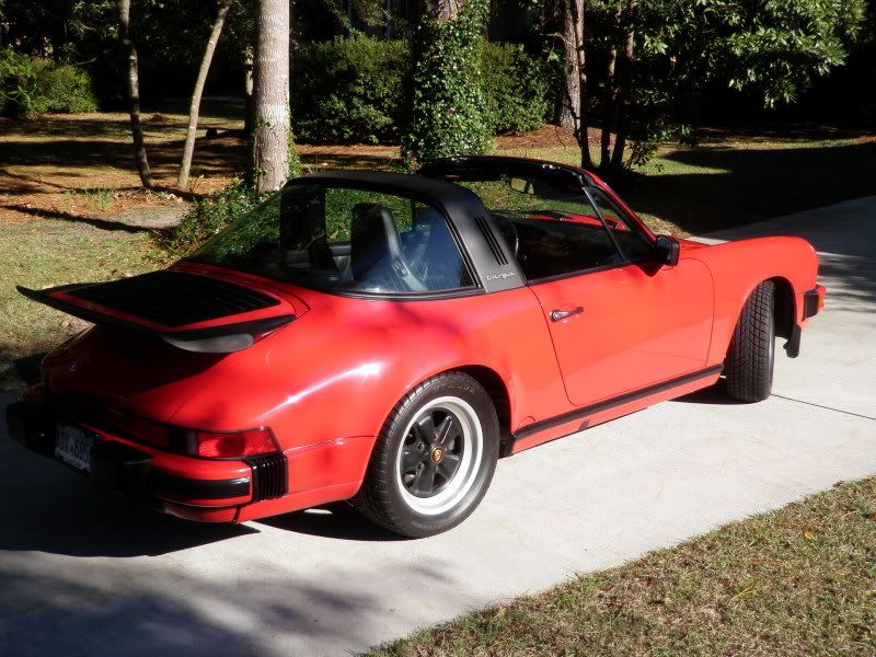

After a few months of searching, with some good help from here and Rennlist, I found my 87 Targa in Georgia. I'm a first time Porsche owner.
I started out looking only locally near CT but was persuaded to expand my region. As a result, I got a low mileage example at a lower price than what I could find in the Northeast (even factoring in the shipping price - thumbs up for DeMoise Trk-ing).
PPI results were good and I had some of the 60K service items done to start a baseline.
Some items to be tackled in the future:
- Targa top/window adjustment (see below)
- Sports seat leatherique treatment, currently stiff as a board and shrunken
- Height adjustment, probably after getting a set of 8"s or 9"s for the rear (but I may opt for 17")
- AC line replacement
- I may swap out the Carrera tail for a ducktail
Otherwise, this is a pleasure/weekend car with no plans for tracking so I want to enjoy it with the family rather than go down the slippery slope of upgrades.
And I know, I've got nothing without pictures so....
The paint condition is better than it appears in the pictures (which makes it look faded)
The targa top is pulling back (not lifting up) from the front seal in the front - see arrows). Possible to stretch out somehow or am I looking at a recovery in the future? The corners are fine.
Also, the driver side window does not fit properly under the side seal - the front 1/3 fits under but the rear 2/3rds fit over. I probably have to adjust both the side seal as well as the window angle, correct?
Left (Driver side)
Right (Passenger side) - which sits properly under the side seal
Anyway, looking forward to a long and enjoyable ownership.

I my self own a 78SC targa, im almost positive the window goes over the seal not under it. It is a very simple thing to adjust even or the inexperienced mechanic. I am doing the bear mountain/seven lakes run this friday if you are interested in joining for a fun run.

Dave - unfortunately I have to work this Friday. As far as the side seal, it has this lip and the passenger side window fits right in there - which seems to make sense as far as sealing purposes as opposed to sitting above the seal lip but what do I know, I'm a noob.
canoehead - I almost purchased a higher mileage 83 SC targa but it just didn't work out.
I took the family on a frozen yogurt run over the weekend, the kids crammed into the back seats. It was 24 degrees outside but the kids had a blast on their first Porsche ride.
Can anybody confirm whether the window should be fit in the side seal "lip" or sit outside the seal?

side seal answer -- the window should fit into the lip. Note how the rear targa bar seal on your driver's side is interfering with your side seal -- this to me indicates that your driver's side seal needs to be pulled out so that it fits with the door seal like your passenger side seal does. The side seal actually has a fair amount of side to side adjustment once you loosen the screws holding it on. I did this by taking the top off, turning it upside down, loosening the screws (you can access them through the holes in the side seal), pulling the side seal as far out as it can go, tightening the screws and reattaching the top. Mine was spot on once I pulled the side seal all the way out -- if yours is too far out, you can readjust as necessary.
On the front pulling back issue, first step is to be sure that the clips on the roof are securely attaching to the front targa bar when the top's unfolded -- this almost looks like the clips are slipping under the front bar and causing the distortion you're seeing. The clips are also adjustable and you might be able to finesse them to pull the top a bit farther forward when unfolding the top.
There are also a fair # of adjustments that can be done to the window itself, but these generally require accessing the door's innards which requires removing the inner door trim.

Thanks darrin for the side seal info. I'll start with that adjustment and see if fixes the sealing issue before having to take off the door panel.
hcole, why is the cap on the alternator a good thing? That it's the original alternator?
Anybody on the targa top front lip issue? Is it possible to restretch the top?
I was thinking of waiting for the summer, soften it somehow by liberal treatment of vinyl protectant and hot sun and try to stretch it out between two people. Do you think that might work?

The Targa top issue comes down to how much and when you plan on using the car. If you are going to garage it for the winter its not much of an issue. I use my Targa mainly in the summer so the top is usually off and things like this on my car go unnoticed for better or for worse. There is a shop in jersey that recovers them, many people here have suggested it, do a search and you should be able to find it. You may want to consider taking it to them and asking what you should do. I have to look again at how the top is fixed on but remember the front bar collapses so you may just be able to collapse it in, re affix the top then fold it back out.

Maybe it is a good thing or bad depending on how you look at it. I used to have one and now it is gone after all the in and out of engine and changing belts over the years/etc. The dang thing may be in one of my part boxes somewhere. Having the cap there might indicate the engine hasn't been horsed around with by sloppy DIY'ers, that is probably a good thing. Not a significant deal, probably not a valuable comment now that I think about it. Feel free to disregard. The alt. might be original, they seem to last a long time, others may have better info.

Very nice car tincob. I wish you many happy miles in it! A little bit of fiddling will sort your seals out. When I got mine, the one side didn't even touch the glass. Now it sits perfectly flush in the lip.

I see tops all the time with the shrunk up vinyl so I can help.
1.This caused by the deterioration of the inner reinforcement and webbing. When it breaks down it makes the top smaller. This the worst in between the metal folding plates. If you look close at the picture you can see that the vinyl has lost it's flexibility whitish color of vinyl.
2. The side seals are adjusted by loosening the side seals and sliding out.
3. Is the clutch pedal push in easy?
