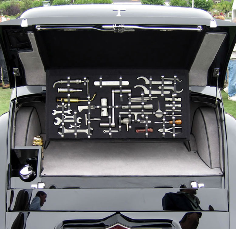

HarryD 01-08-2012 07:29 PM
You can never have too many tools, just in case:
http://1.bp.blogspot.com/_i_AovfzNXg...ToolKit+HR.jpg
As found here: Just a Car Guy: 7/1/07 - 7/8/07
