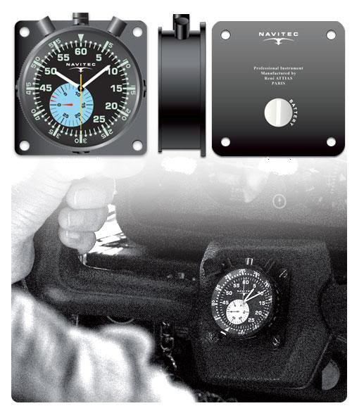

I have a few of these available. They are quartz, not mechanical. Stainless case:
