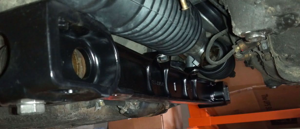

deathbyspoon 08-13-2012 11:12 AM
Made a little progress...Though having these nice shiny parts on there made me realize how disgusting the rest of the underside of the car is. Once the car comes back from fab, I'll attack the 29 years of neglect.

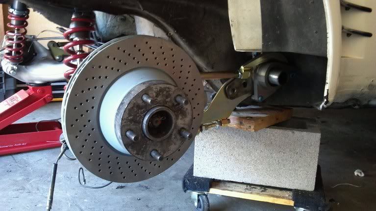

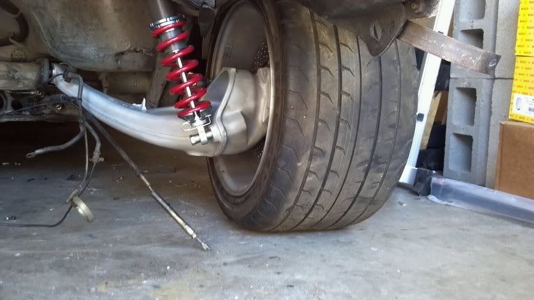

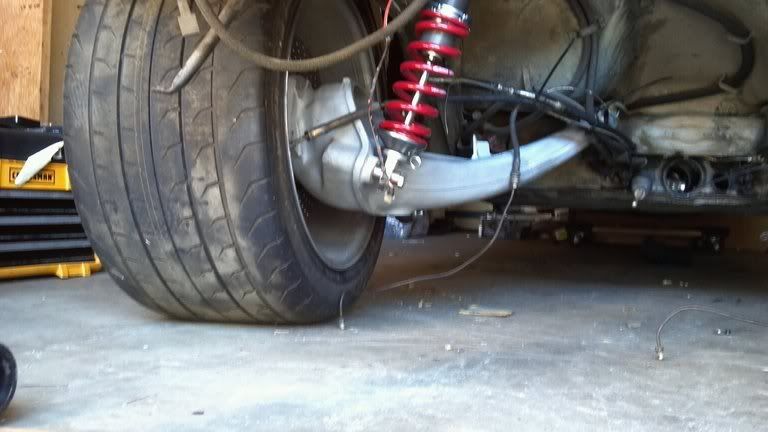

deathbyspoon 08-20-2012 08:22 AM

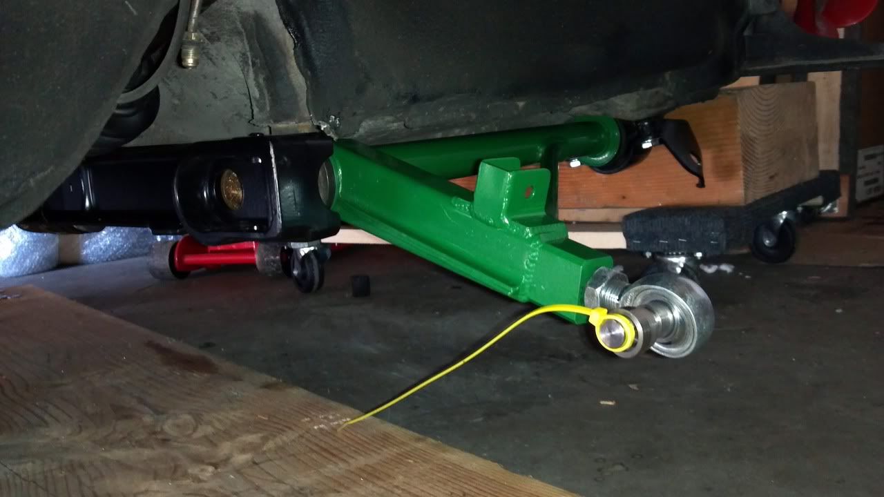

Managed to do a little more work on the car this weekend. I've been waiting for some parts to come in for the front suspension, and they're still not ready, so I had to re-use my oem rubber bushings for the time being. I'll have to take them off, but at least it gets the car rolling.
http://i112.photobucket.com/albums/n...-04-43_348.jpg
http://i112.photobucket.com/albums/n...-07-01_952.jpg

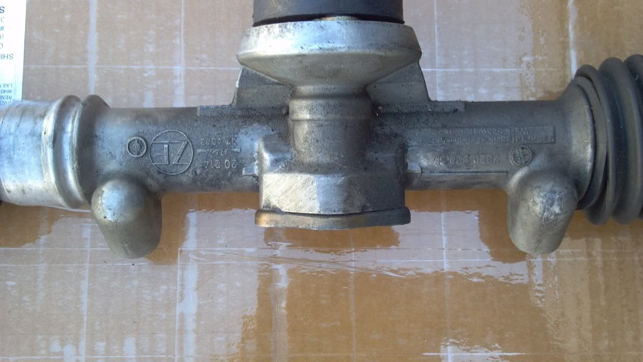

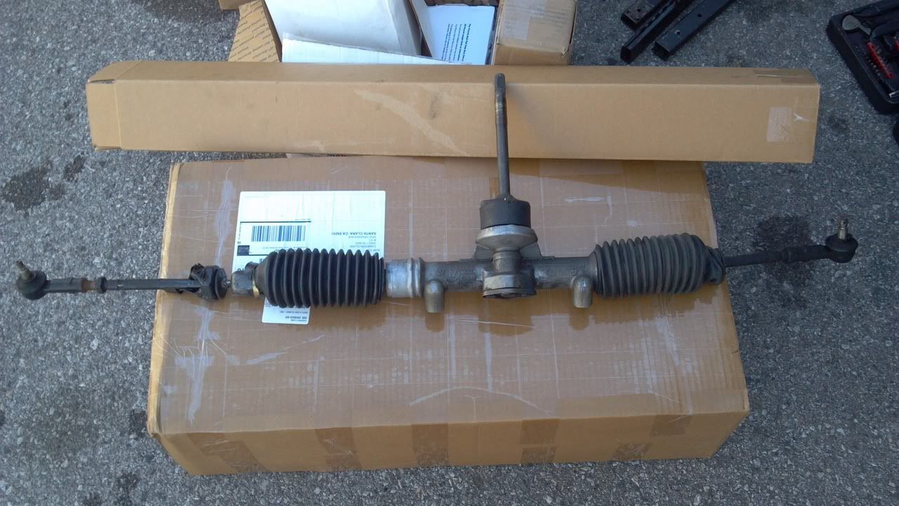

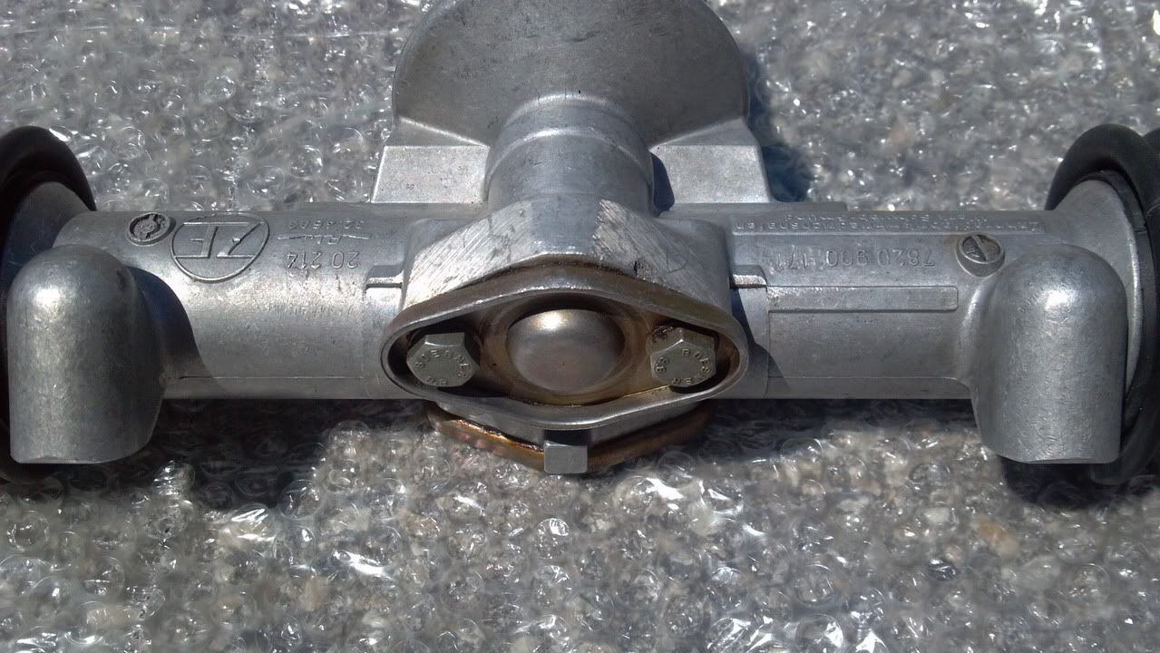

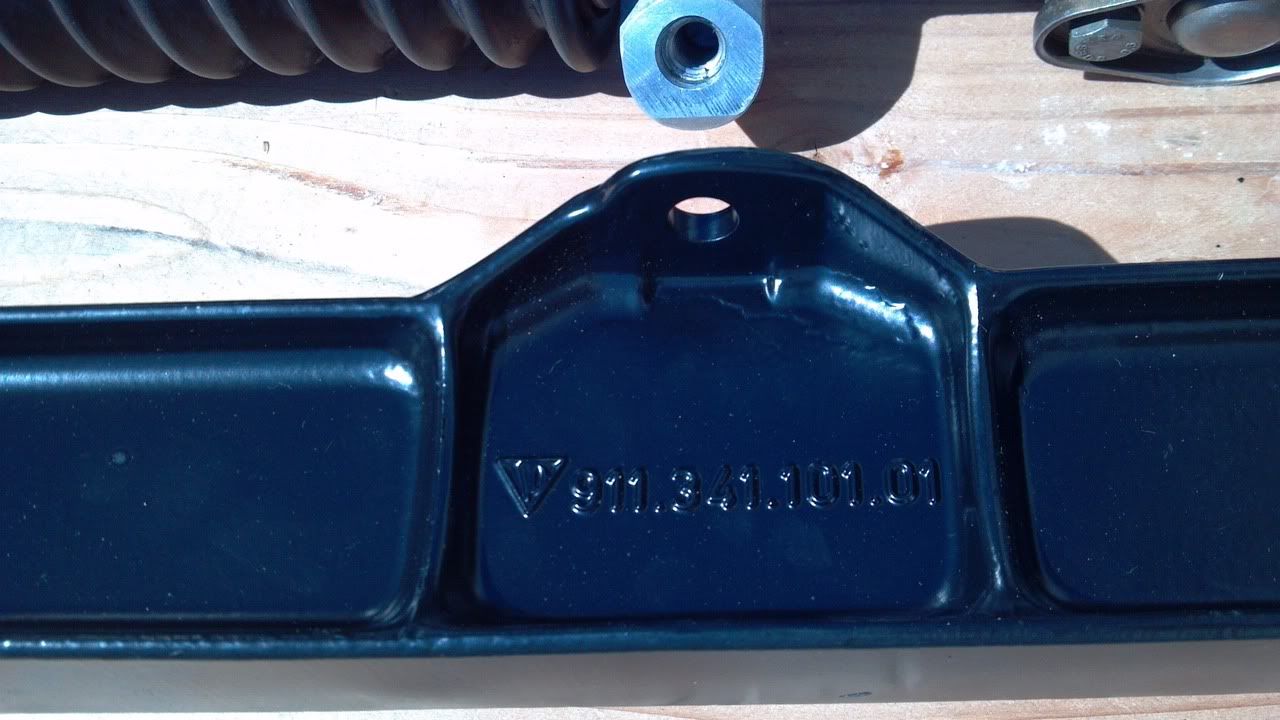

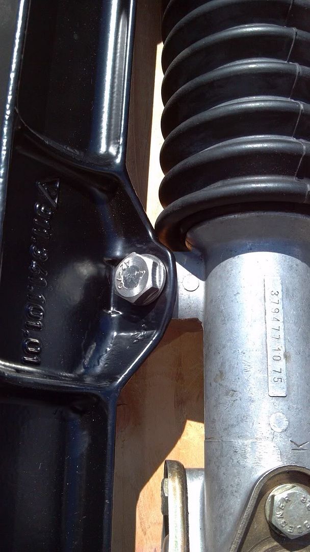

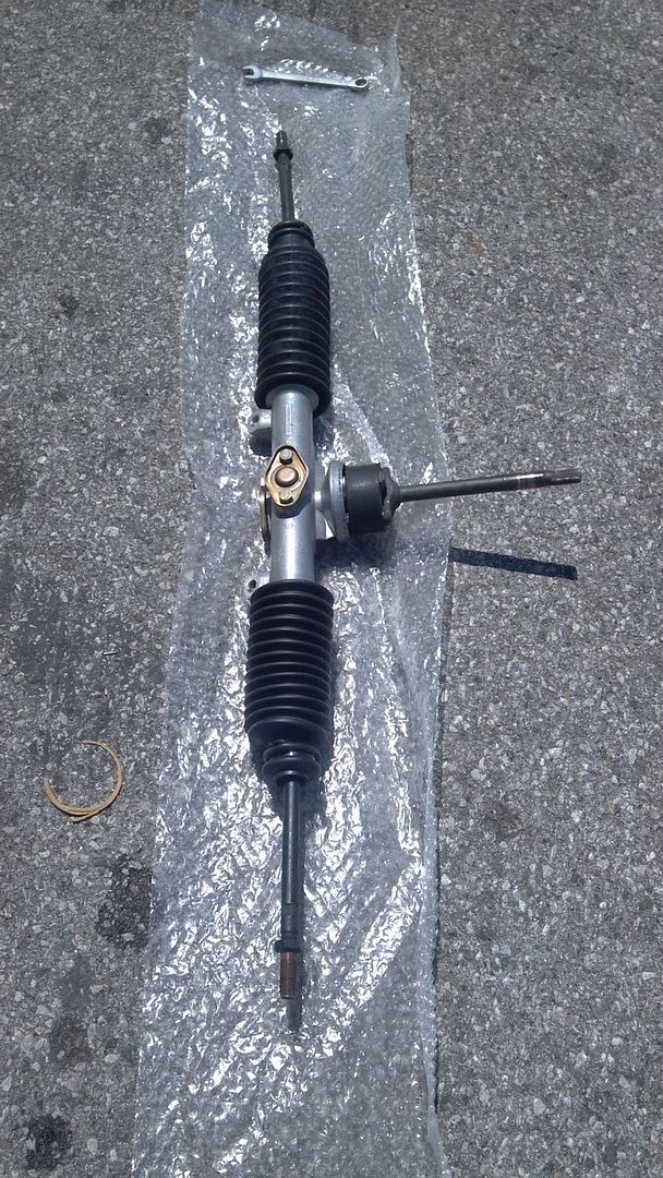

And I re-booted and cleaned up the steering rack as well.
Before:
http://i112.photobucket.com/albums/n...-37-59_302.jpg
http://i112.photobucket.com/albums/n...-38-04_547.jpg
And a little bit of elbow grease, sweat, and patience:
http://i112.photobucket.com/albums/n...-44-36_683.jpg
http://i112.photobucket.com/albums/n...-44-29_177.jpg
http://i112.photobucket.com/albums/n...-45-16_701.jpg
http://i112.photobucket.com/albums/n...-06-55_247.jpg
http://i112.photobucket.com/albums/n...-07-11_305.jpg

and installed...Sorta :-)
http://i112.photobucket.com/albums/n...p/Untitled.jpg

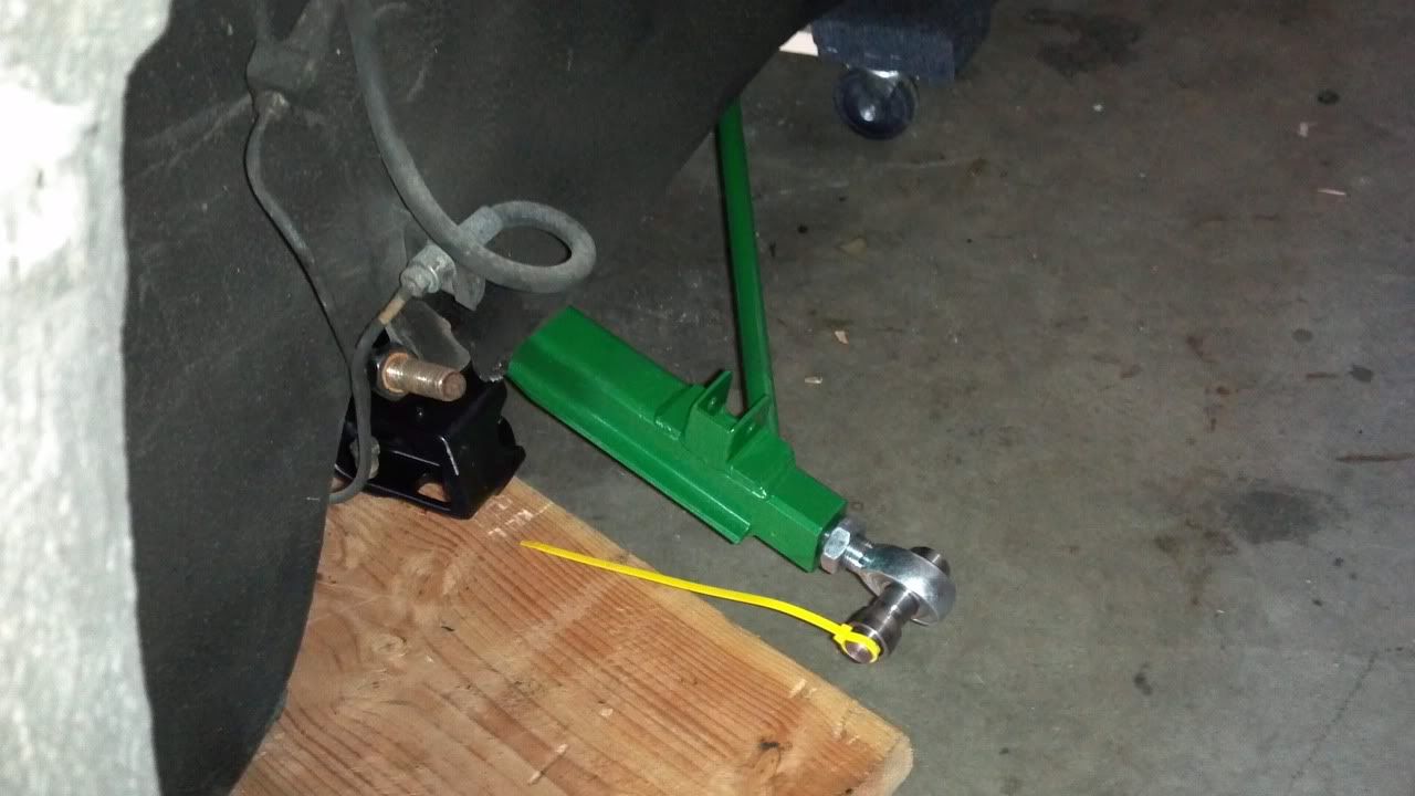

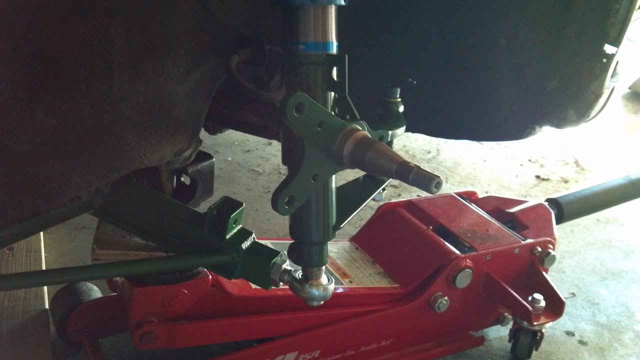

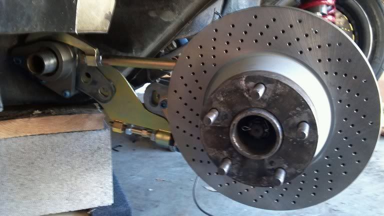

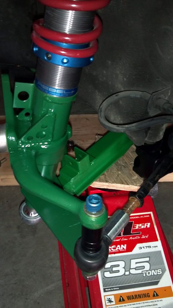

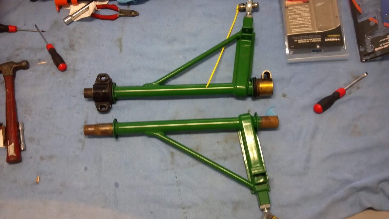

deathbyspoon 08-21-2012 04:57 AM

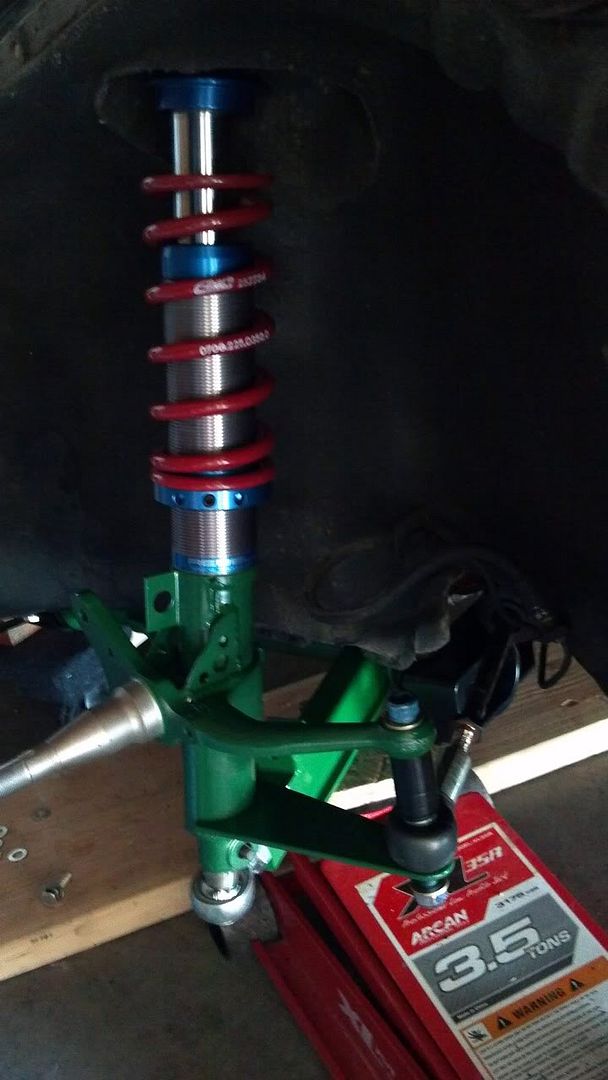

Managed to get both arms on, and the driver side strut yesterday...I'm trying to have this rolling by the end of the week.
http://i112.photobucket.com/albums/n...-35-49_172.jpg
http://i112.photobucket.com/albums/n...-35-41_996.jpg
http://i112.photobucket.com/albums/n...-12-57_313.jpg
http://i112.photobucket.com/albums/n...-10-54_957.jpg
http://i112.photobucket.com/albums/n...7-12-45_72.jpg
DW SD 08-21-2012 06:20 AM
Looking good!
seems like an awful lot of threads showing on your tie-rods. When I lengthened my front a-arms, I had to make lengthened tie-rods to go with them to ensure enough thread depth. Is that in the works?
I ran and extra 1", I think or maybe 30mm of length on the a-arm.
Looking great!
Doug
deathbyspoon 08-21-2012 06:42 AM
Doug -
Good eye! I qctually just butted the tie rod against the end for the picture, theres no threads engaged yet. I was in a rush yesterday and thought it looked more complete for the pic.
The car will be getting camber boxes, so im hoping between rhose and the rod ends, i can get the camber/adjustment i want without having to lengthen the tie rods.
DW SD 08-21-2012 06:49 AM
There can be an advantage to running lengthened arms in reducing the scrub radius, which affects steering effort and feel. It might be worth running the a-arms extended. This also would affect the offset wheels which you'd run. I did custom wheels and custom tie-rods. It was worth the extra effort. Lindsey made my Fuchs and I could order them however I wanted, so some extra fabrication on the tie rods wasn't a big deal.
I'd take a close look at what is optimal, given how much adjustment you have. I'm thinking +30mm from stock might be in the ballpark. I believe plenty of the guys with 935 - style a-arms will know how to optimize.
With the lengthened arms, having enough negative camber is easy, even without the camber boxes. I did use the offset monoball strut mount offered by Tarrett.

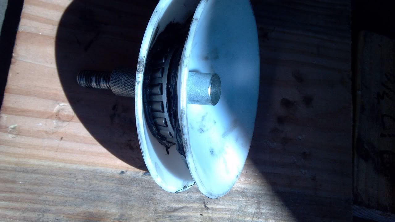

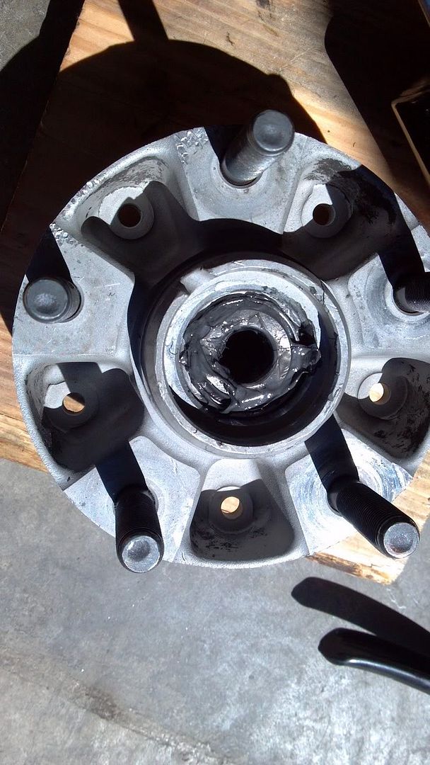

deathbyspoon 08-22-2012 05:45 PM
Made some more progress today...
Finished the passenger side strut install. Threaded the tie rod ends and visually aligned the struts. So far so good.

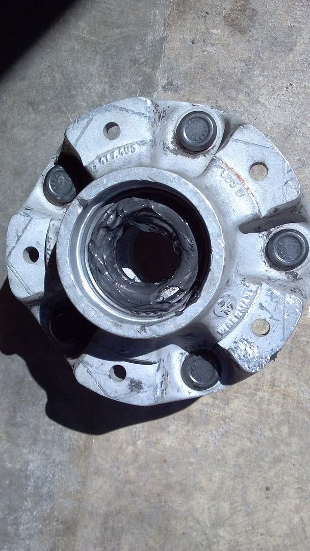

Then i greased the wheel bearings:
http://i112.photobucket.com/albums/n...-58-37_823.jpg
http://i112.photobucket.com/albums/n...-02-00_142.jpg
http://i112.photobucket.com/albums/n...-06-08_563.jpg
http://i112.photobucket.com/albums/n...-56-22_337.jpg

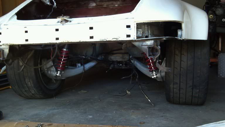

Bolted on the wheels, and out she came!! First time it has rolled on it's own wheels in 15 months...
http://i112.photobucket.com/albums/n...-51-14_942.jpg
http://i112.photobucket.com/albums/n...5680620845.jpg

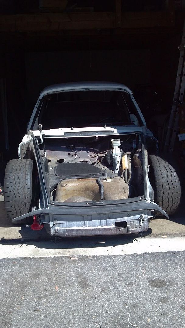

Well, took the 930 to 9Elf Motorsports in Santa Rosa last weekend. Roll cage, rear fender removal and fiberglass fender mounting, fiberglass roof skin, and some other work to be done. Hopefully back in a few weeks.
http://i112.photobucket.com/albums/n...-37-17_664.jpg
