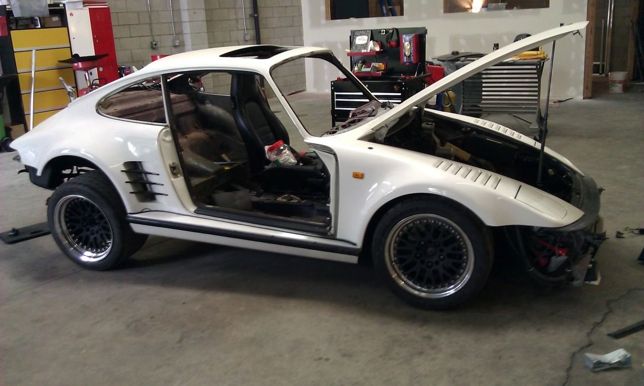

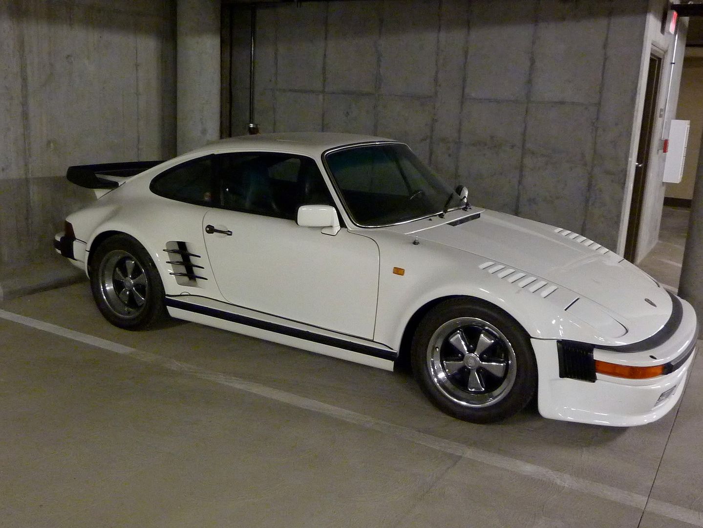

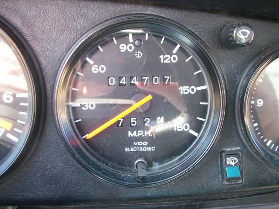

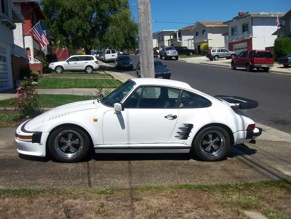

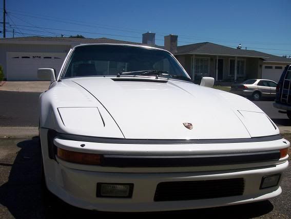

In late 2009, after some heavy craigslist searching, i found a local seller who had an '83 930 euro car. He got the car from hsi dad who essentially walked out on the family, and left the kid two slant nose converted cars. I was stupid and didn't get a pre purchase inspection, and thought i was getting a pretty good deal because the car had only 44k on the clock, sport seats, the slant kit, boxed rockers, and was only $17k, down from asking price of $30. Here's what i came home with:
Looks pretty good at first, doesn't it? Not bad from 15 feet away.

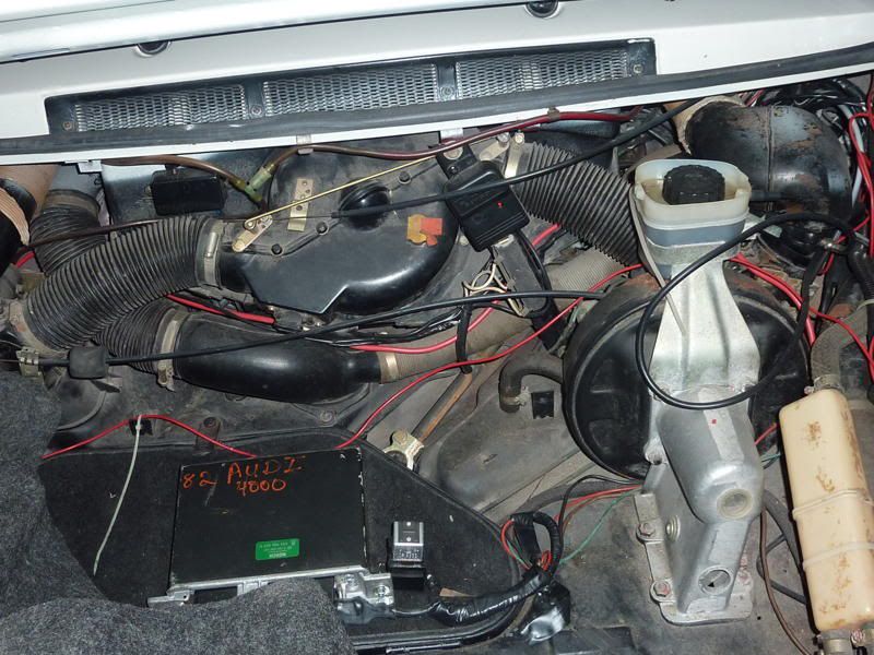

Well, as it turns out, things weren't as good as they seemed.
*The car was repainted.
*Fuchs needed rechroming
*Boxes rockers were held on with screws of different shapes and sizes (wood, drywal, sheet metal)

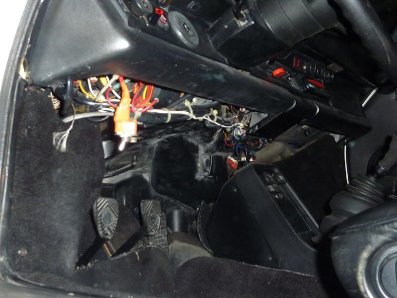

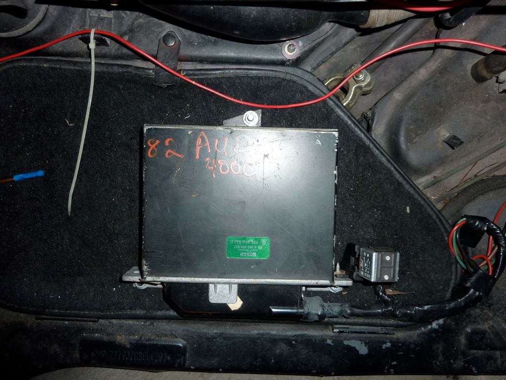

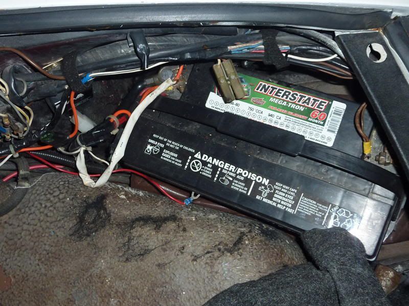

*There had been some shady wiring work done over the years from various aftermarket alarm and stereo installers.
*The suspension was shot, and the rear sway bar was missing
*Rear torsion bars were the wrong size
*Power windows didn’t work
*Brake rotors were cracked
*Transmission needed a reseal
*Engine had been sitting too long and had oil leaks that required a rebuild to fully rectify.
So, after all that, i thought I'd buy another Porsche engine and do a minor resto mod. I bought a "fully built" 3.6 turbo long block from a local member on here. It was alleged to have gt2 evo cams, pauter rods, 993t pistons, fire ringed heads, fully ported heads, etc etc, with only a couple thousand miles of break in and dyno time. My friend who owns a Porsche shop advised me against using this engine because he wasn't familliar with the build or parts used. After a leakdown test came back with marginal numbers, I sold it. Turns out, the engine was garbage. There were metal shavings in all the oil passages, ceramic lining on heads was missing huge chunks, one of the valves was brand new (why?), head porting was meant for ITB's only, cams had wear from running on low oil, fire rings were pinched and not seated right.

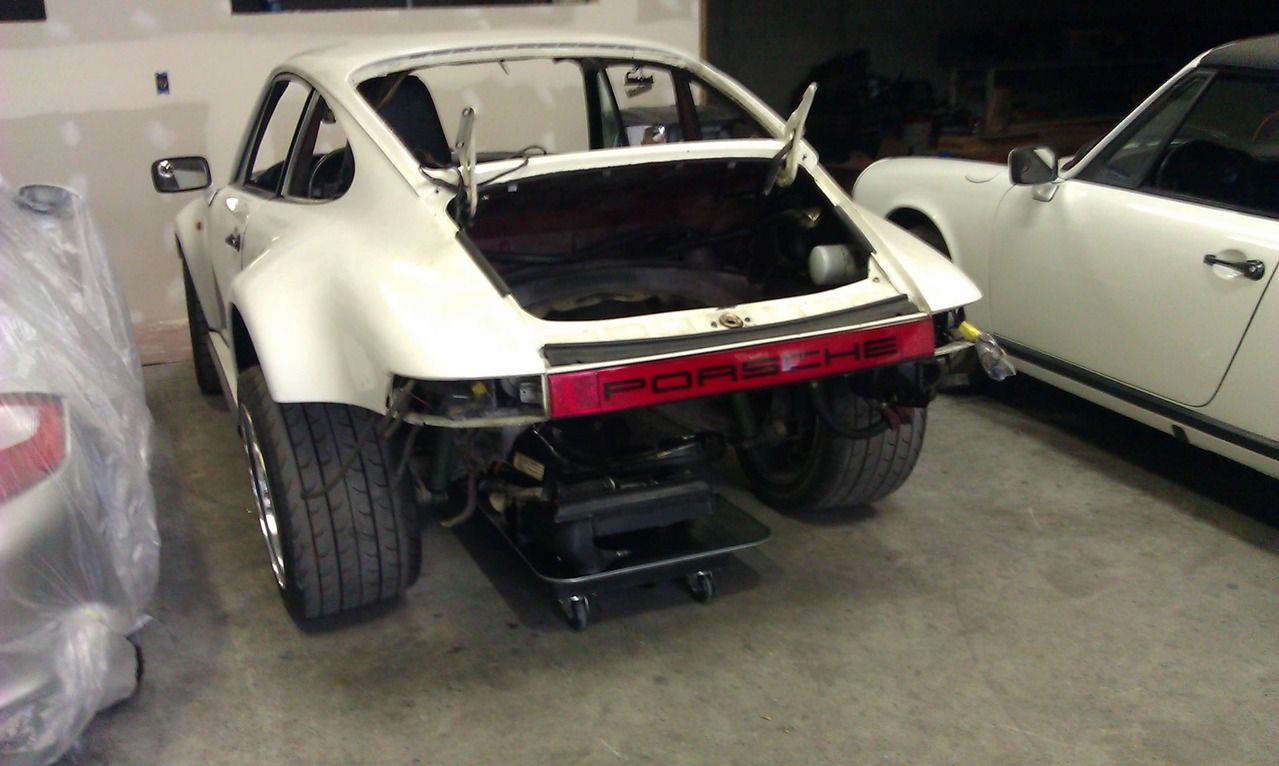

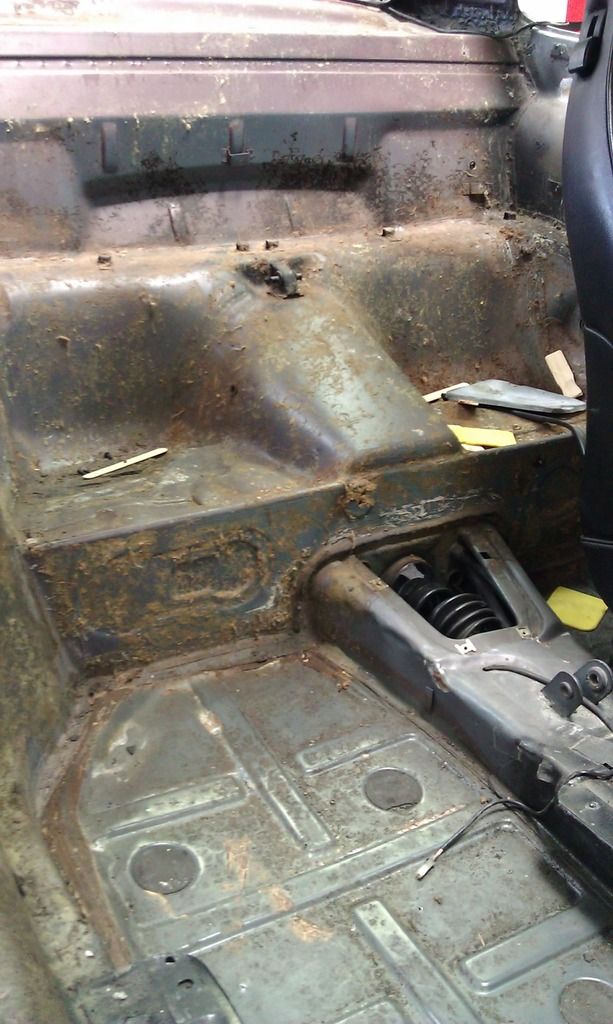

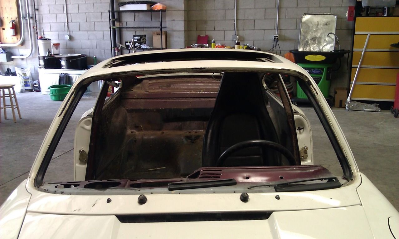

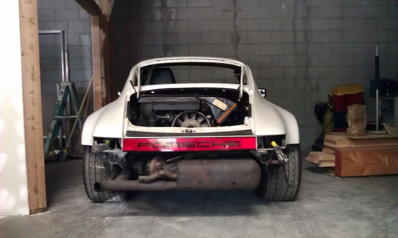

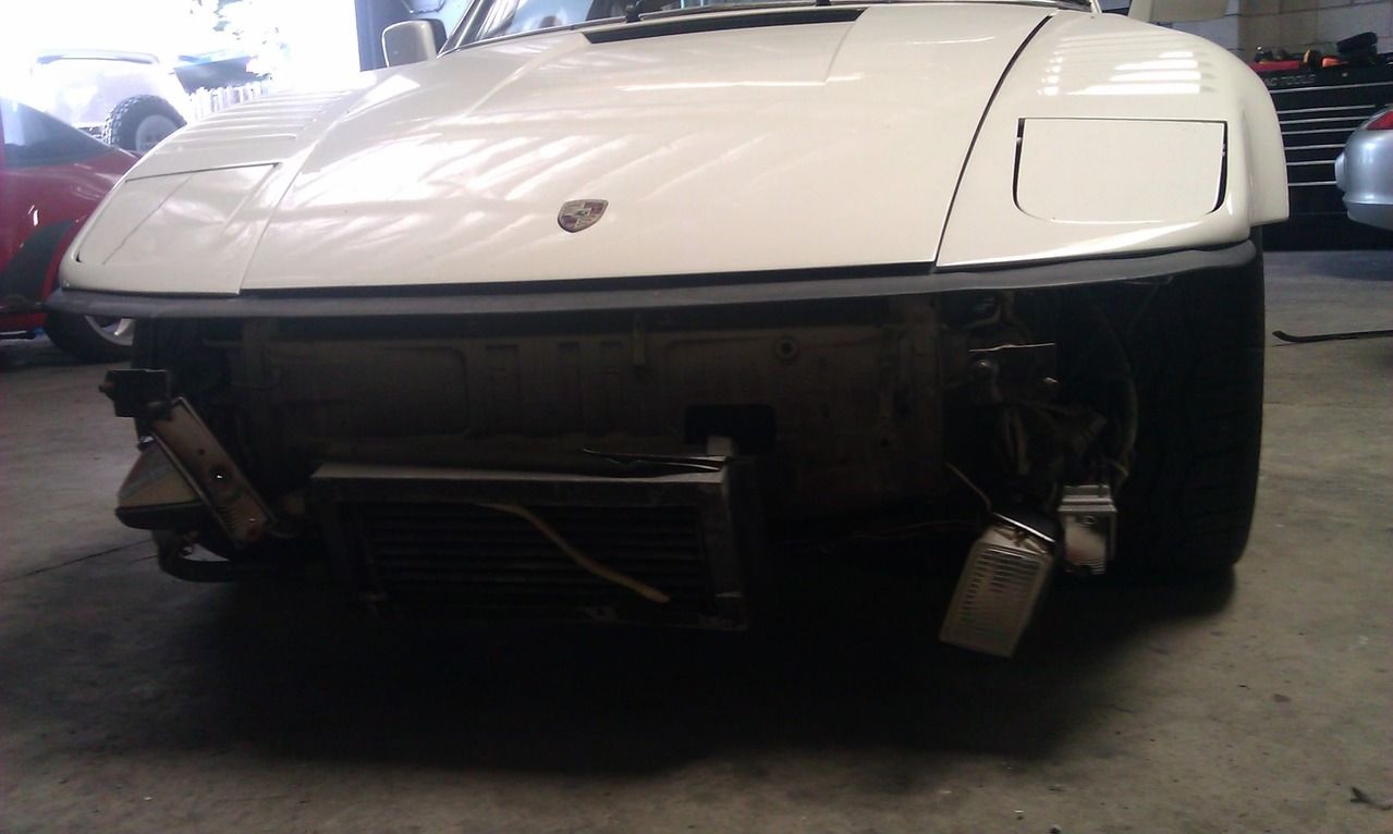

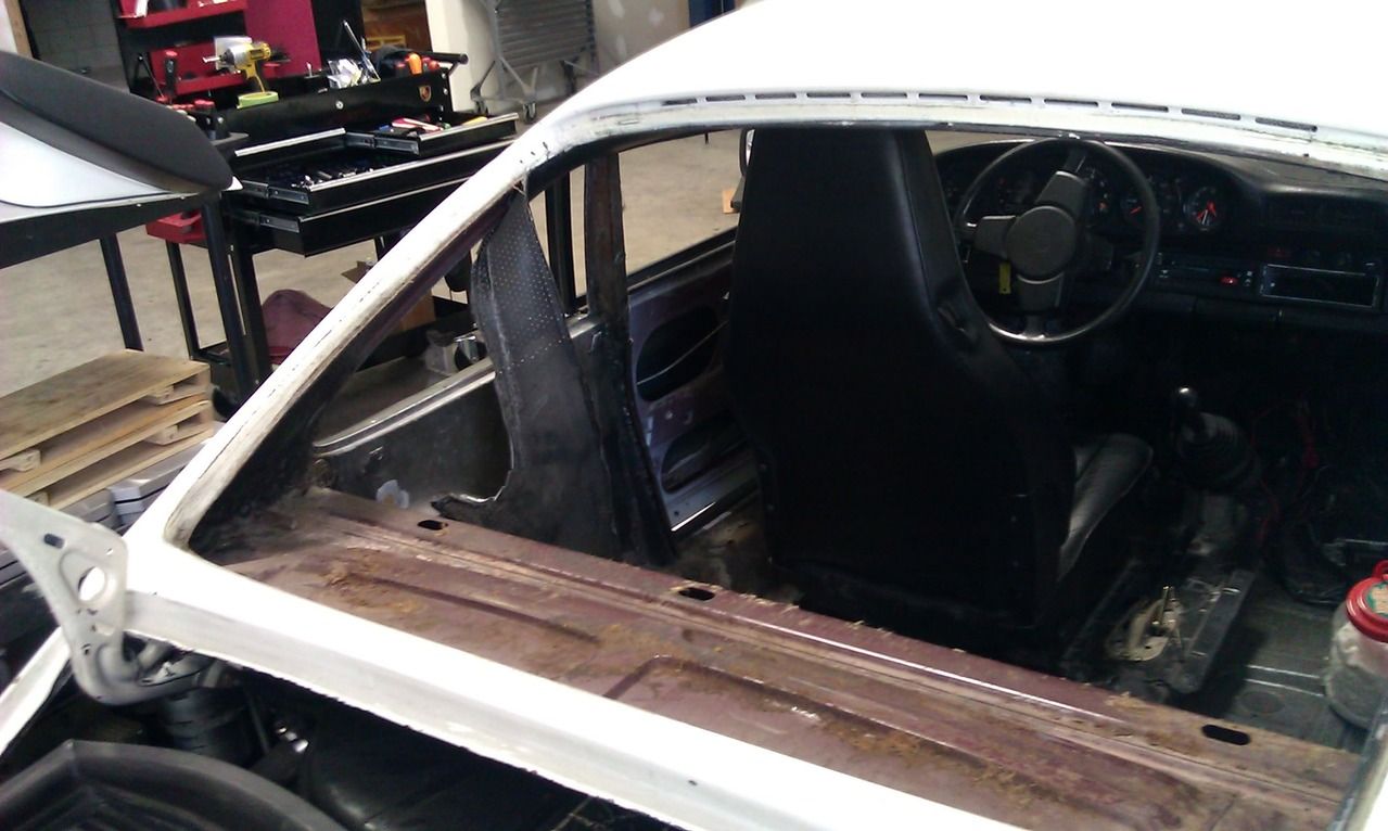

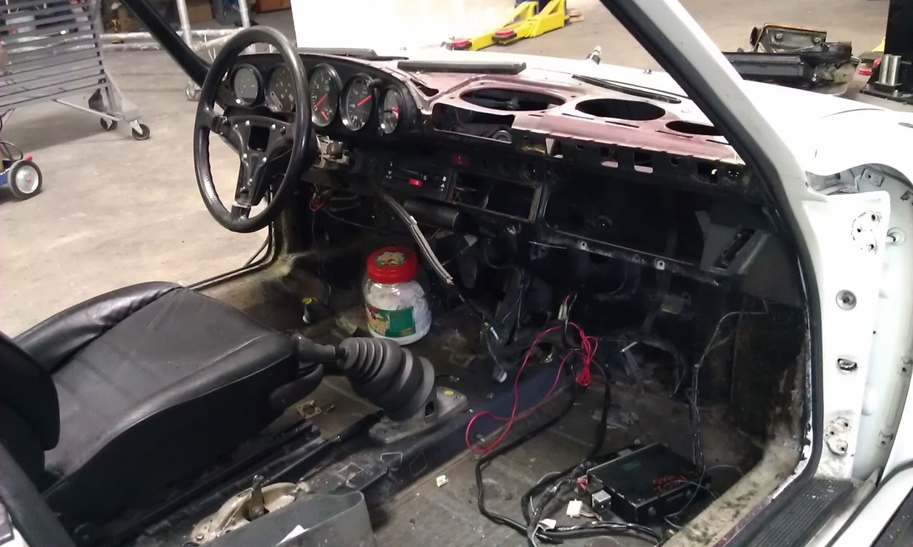

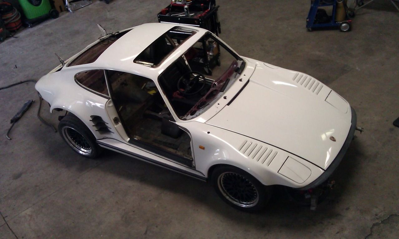

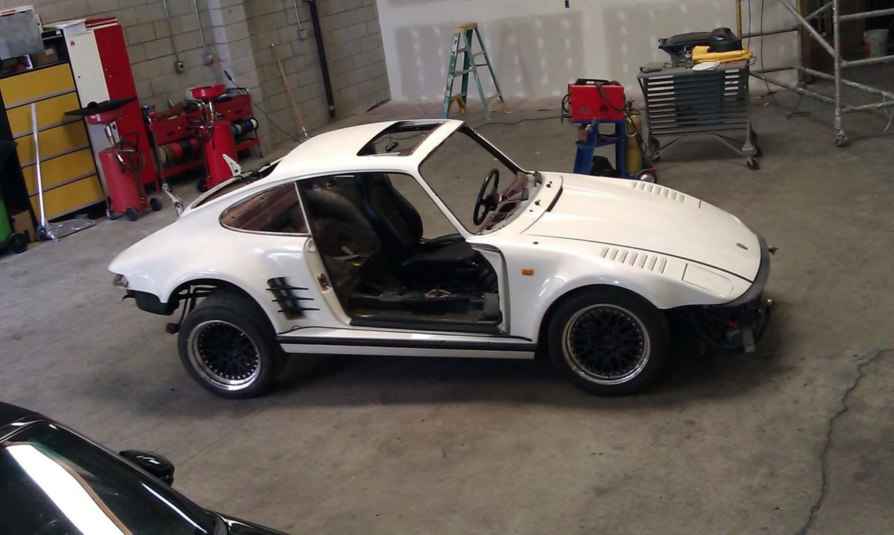

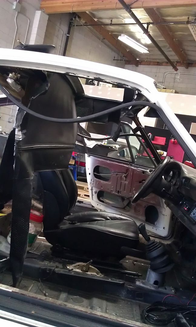

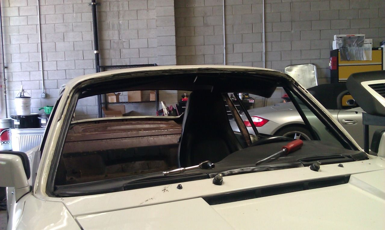

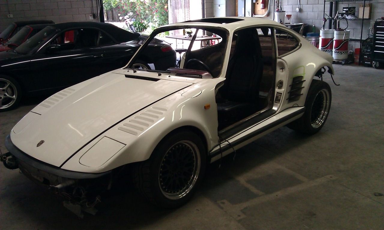

In the meantime, I'd completely torn down my car. Here's some pics in no particular order.

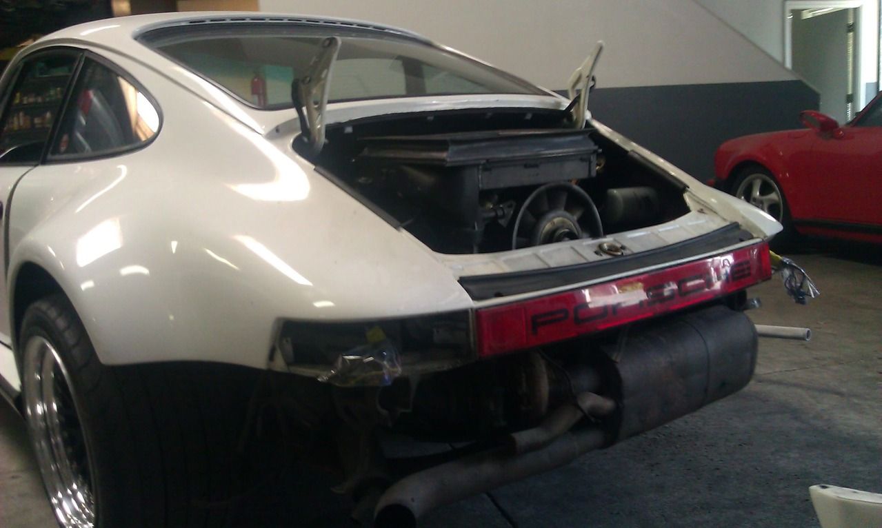

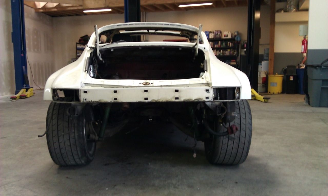

I don't see this mentioned but it appears like this car was smacked in passenger side rear pretty hard. The repair was not done correctly as they left a common tell tale sign of having the lip out of alignment. I think I can also see this in the picture with the decklid closed, it's off on that side.
2021 Model Y
2005 Cayenne Turbo
2012 Panamera 4S
1980 911 SC
1999 996 Cab
Old 02-16-2012, 12:28 PM
Join Date: Aug 2005
Location: Santa Clara, CA
Posts: 294
Scott - you're right. Nobody has ever pinpointed that, but it would explain why my right wheel was sticking out past the fender when i mounted it.
Whats the best fix for this, besides another car...?

Hey, go for it! You seem to have gone through your share of pain with this car, but $17K is not tooooo bad as a starting point. You'll end up like most of us and have more money in it than it will be worth, but the journey is part of the fun. I'd say the body work pointed out by Scott might be the most difficult problem. Good luck & have fun.

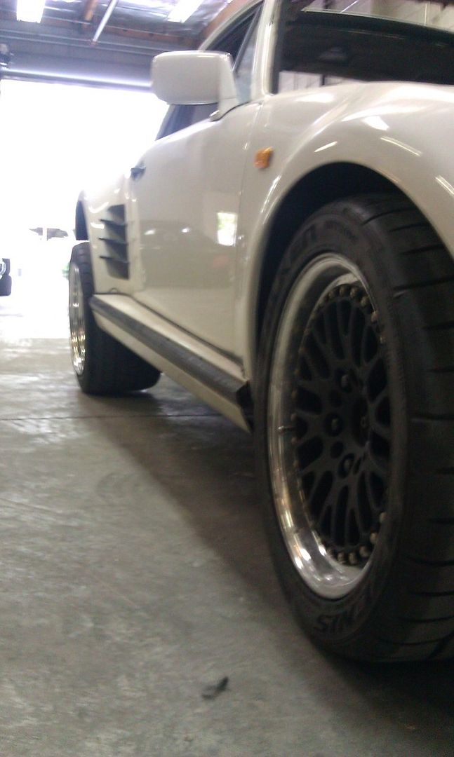

Cam - The CCWs look sweet!!
