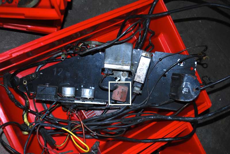

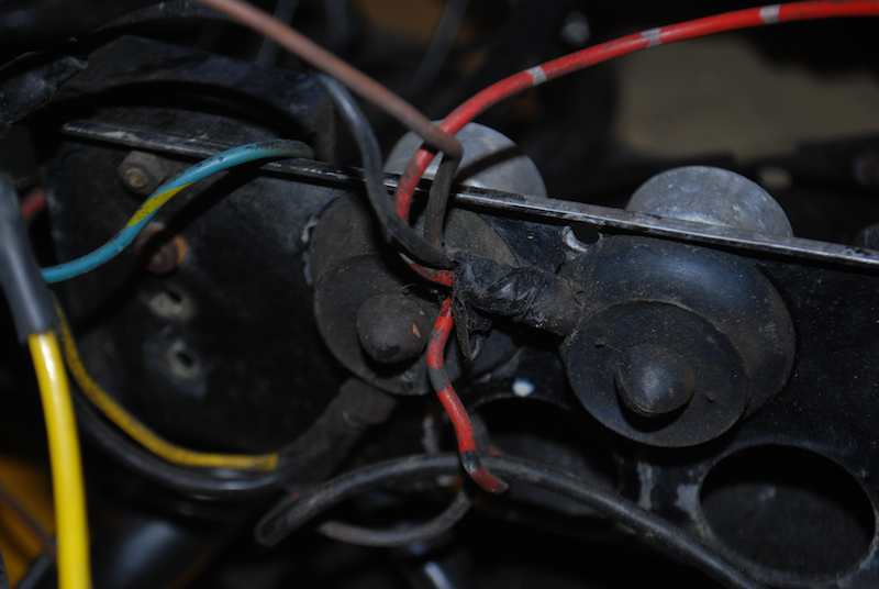

Sorry, i wasn't clear enough. I have the panel but it has been modified in the past and my wish is to restore this to original condition. My car is 911T 1969 with Webers. This is my panel:
What's in the white box? I didnt see that on the other pictures and should the mount for the Hardi pump straight? Mine is a bit bent.

Siim,
The device in the white box is a ‘Radio Frequency Interference’ (RFI) suppression filter to prevent alternator noise in the radio or other electronics.
That is an original factory part.
The 3-prong connector from the alternator plugs into this device.
This device plugs into the Bosch voltage regulator (yellow arrow).
What are the numbers and wire-colors to the device (green arrow)?
You will notice connector pin numbers on the device and connector.
Associate the pin numbers with the wire colors.
Originally there was a Hardi electric fuel pump located here (violet circle).
A better solution for fuel pump is to locate a rotary pump on the front suspension cross member.
This is identical to the 1969 MFI 911E & 911S, only a different (lower pressure) pump.
(A 1970 911T was configured this way.)
Does your chassis have an unused fuel return pipe in the tunnel?
If so, you should consider a circulating fuel system (like MFI, CIS, DME and more.)
If not, you might consider a new return pipe.
Post the wire colors and associated pin numbers from the two silver relays (brown arrows) on the panel.
What are your intentions with your project? Restore to original? Make work properly? Build a ‘hot-rod’? Other?

Siim,
OK, lets’ get this ‘straight’.
This “12” electric panel seems (to me) to be for a 1969 MFI 911E/S with (possibly) a single-stage (or no) heated rear window.
Your 911 is a 1969 911T – correct? VIN = 119121314 Engine number = 6195100.
2.0 or 2.2 liter engine
Note the images I posted above have a “10” electrical panel.
While not exactly correct for your 911T, I’m sure we can make this electrical panel work correctly for your application.
First – Do you have a Heated Rear Window?
If so, is it single stage or 2-stage (full top-to-bottom heating element)?
If you have (had) a Heated Rear Window, the gasket and body should have provision for the wires in the lower-left corner.
Please post images of the engine so we can see the configuration.

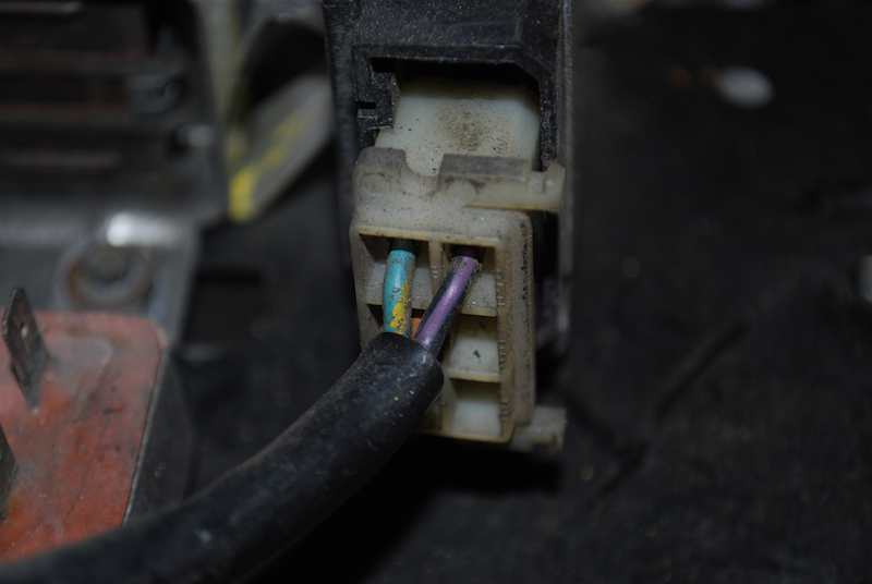

On your “12” electric panel, please confirm the wire colors and pin numbers on the two ‘silver’ aluminum relays and the MFI RPM Transducer.
There can be pin numbers both on the devices and on the connectors.
Please post a detailed image of the Rear Fuse Panel.
Please clean or ‘peal-back’ coverings so we can be sure of wire colors.
Eventually, we want to absolutely confirm that the wires go where indicated on the wiring diagrams.
You will need a ‘multi-meter’ or ‘continuity tester’ for this.
The 1969 model-year was a ‘transition’ year and many things changed during the production.
We can get your electric panel to serve properly and look exactly as if it were original (the “12” excepted – leave it intact).
Here is your (I think) Heated Rear Window Relay. It is also possible this is part of the MFI.
The numbers are relay pin numbers.
Please confirm the wire colors and pin numbers.
Here is your MFI RPM Transducer.
Here is the ‘other’ relay.
This may be part of the MFI.
Please confirm wire colors and pin numbers.
Overall, this may be an electric panel combined from several.

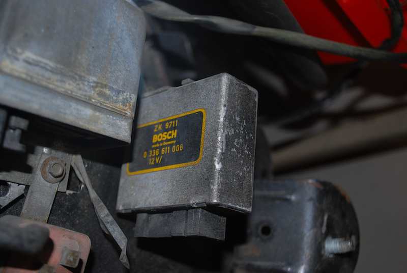

Old 04-22-2012, 02:18 PM
kkinzli's Avatar
Join Date: May 2009
Location: Lakewood Colorado
Posts: 1,346
Hi Grady and Siimlane,
Here is a more detailed picture. I am guessing I have an MFI RPM Transducer which makes no sense on a 69T? Why would this be in there? Maybe there was an MFI motor in the car at one point?

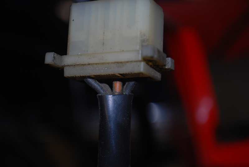

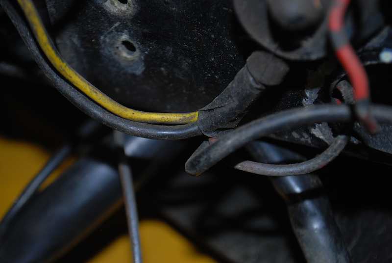

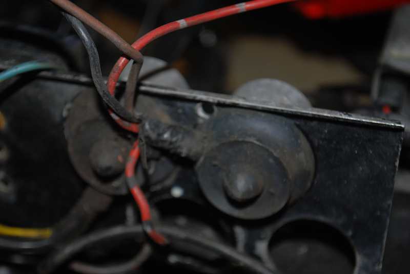

Hi
I made some new close-ups and checked all wiring colors. The car has a single stage heated rear window.
Transducer plug:
Light blue with yellow stripe
Black with violet stripe
2 x Brown
Black
Relay nr.1
Brown
Red with black dots
Red with white dots
Black
Relay nr.2
Yellow
Red
Black
Red(in a black insulation tube)
Plug that comes from alternator
Brown
Black
Red
Sorry for poor quality of some pics that i made with phone.
