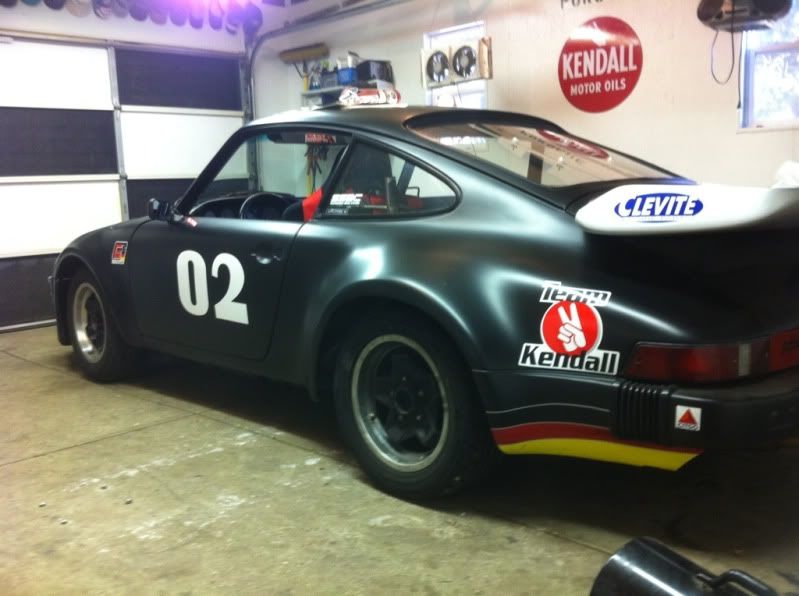

We used the original rubber on all the windows and 3/16 lexan.

I used 4mm lexan with 993/964 seals and clamped it to the original glass so it matched the curve.I also did my door window wind up glass but would use 5mm next time as 4mm flexes to much for a road car in this area
the front & rear 1/4s and rear screen fit with no leaks HTH

I have a seal and a piece of polycarbonate that can be used as a template. The polycarbonate is flat, and flat works just fine for a 911. My chassis is a '75.
As an alternative to polycarbonate, one can use Vivak.

I just did this project and used both the stock seals and trim. Lexan MR10 and cut it to shape (I was surprised how easy it was to work with). I went with 3/16" in the rear and the rear quarters. As others have said, the rear will flex into the shape of the stock glass.

You should use PC (eg, Lexan, Makrolon) for the windows. It is designed for that type of application. PETG (Vivak) is a clear substrate that technically would work but It is more of a point of purchase display product. Like acrylic (Plexiglas) on steroids or a 2-liter Coke bottle. It does not have as high impact as PC and will yellow quicker when exposed to UV. Since your going through the effort, use PC.
In the US, 3/16" is typically .177" thick and 1/4" is typically .220". You can get 1/4" at .236" but that is not what most plastic distributors stock.

Yes, that is me at Laguna in group 7 at RR IV, car #4. There were a few of us in Group 7 with cars that are registered for street use...
I have made these windows out of scratch-resistant polycarbonate and out of PETG, and have purchased one from a commercial vendor in PETG. PETG is much less expensive for DIY and works just fine. I have the PETG unit on in the picture above. Excellent optical clarity and easy material to work with.
I use 1/8 thick material in either case. No benefits of thicker material.
No issues in street driving, BUT I do not drive or race in the rain. If I did, I would modify the install slightly.
With a rubber seal, I do not think leaking would be a problem... it wasn't for me when I ran the rubber seal, based on washing the car.

The polycarbonate materials come in various types... and there are various types of scratch-resistant coatings.
My original window was installed with a rubber seal and flat polycarbonate and held up very well.
Several friends have the Spektr products frame and window and they appear to hold up well. Spektr actually use a shaped piece of plastic for their rear windows. They use heat to shape the plastic. A great product that is used by many folks.
Other companies sell just the windows and some of them are shaped, and/or have scratch-resistant coatings. Prices vary.
This year I made two frames, similar to Spektr's. One is made out of carbon fiber, the other from ABS plastic. The frame is lighter than the rubber by just a tad, and now I can easily remove the window for cleaning, et cetera. Plus I needed a project.
I bought piece of PETG/Vivak and used that in the CF frame for a while. I shaped it with gentle heat. Held up well. Now I have a flat, scratch-resistant polycarbonate window sitting in the ABS frame I made.
When you use a rubber seal, flat plastic is just fine. When you use a fiberglass frame, like what is available from Getty Design, flat plastic seems to work fine.
The frames I made encourage the use of a window with some shaping. Either polycarbonate or PETG can be shaped with heat, but I think PETG is easier to "heat form."
