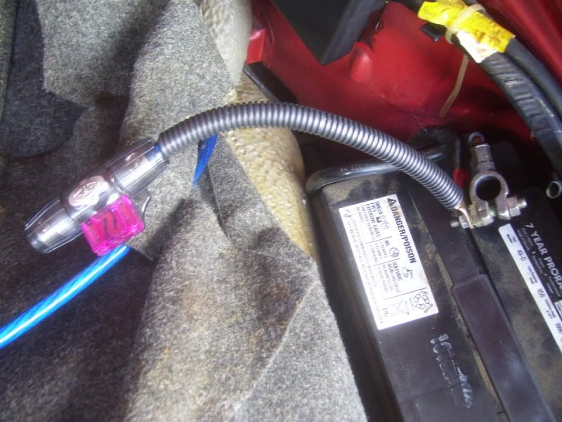

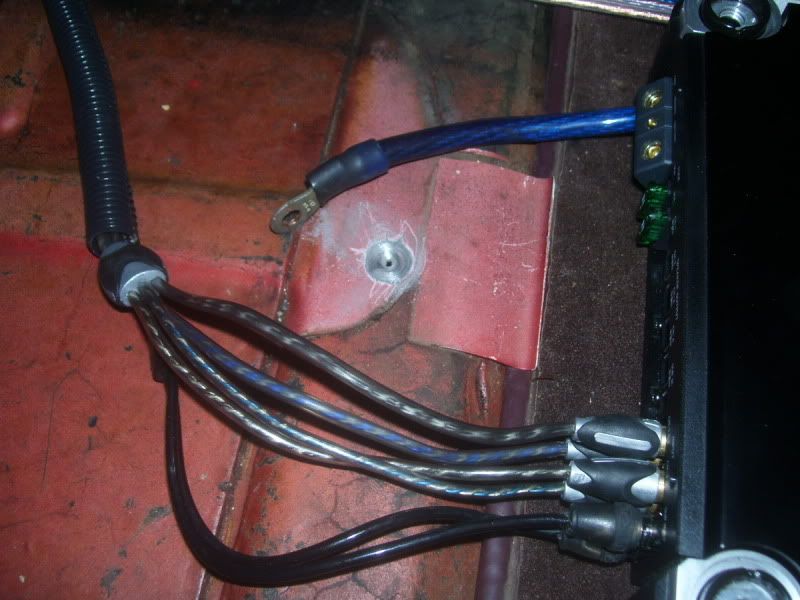

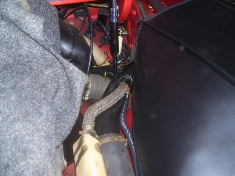

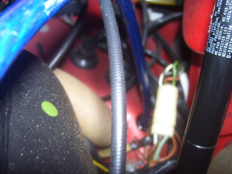

first on the list was to find a way to run a 4g wire from the battery to the cabin. i found a grommet to use (as you look at the car from the front) in the rear right corner of the trunk.
it enters the cabin on the upper left corner of the driver's footwell area.
i ran it under the edge of a few pieces of carpet and ended up under the drivers seat
finished product, no wire in sight

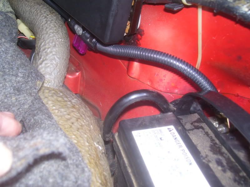

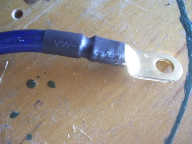

next on the list was attaching it to the battery. used a ring terminal on the end with some heat shrink.
connected it to the battery, covered in split loom, connected to the inline fuse.
i did not want to drill any holes so i used this stuff. it is sort of like plastic velcro only has a much stronger bond. the glue on the back is incredible as well. i have never seen it let go in the 5 years i have been using it.

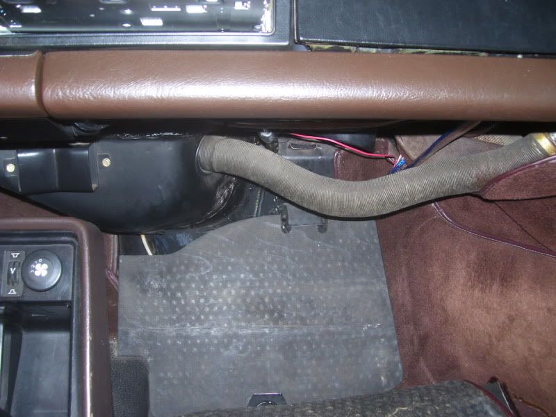

here is the line attached to the wheel wheel and then running back to the grommet, all covered in the loom.
black line on the bottom

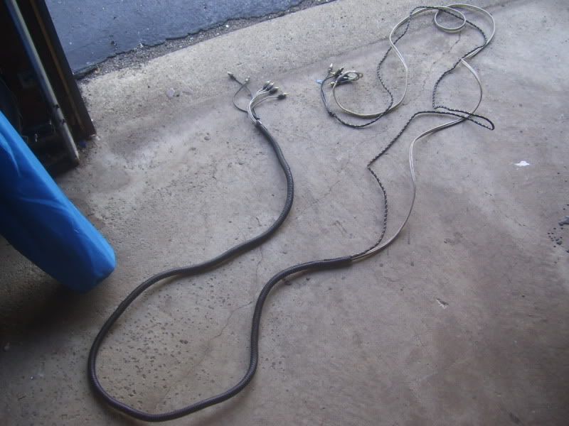

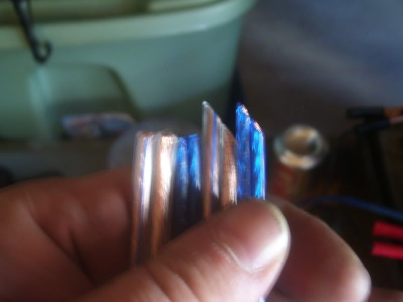

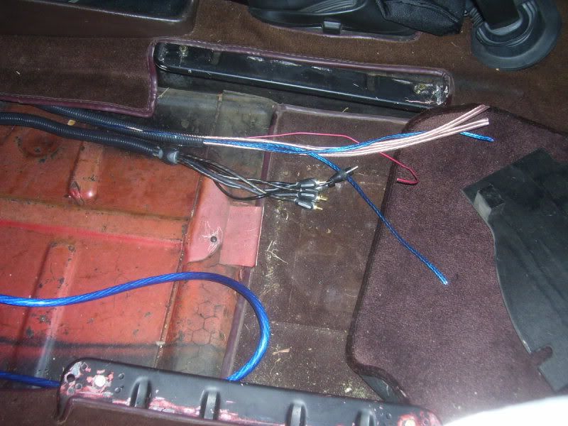

next on the list was putting the 6 rca lines and 4 sets of speaker wire into looms then running them. i used a normal set for the sub input and a dual set for the comps up front. 16g wire for the tweets (blue), 12g for the mids (clear).
a good tip for running more than one set of speaker wire - cut one set at an angle and the other straight. never worry about which is which again.
all lines are wrapped in loom and run to the appropriate places. they all end up clean and neat under the drivers seat.

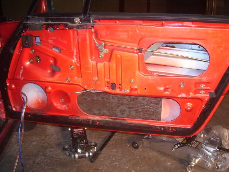

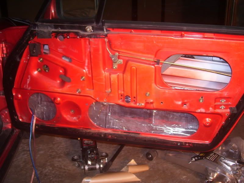

up next, the passenger door. panel removed and ready to begin. removed the 25+ year old factory dampening material with a heat gun and a screwdriver. the heatgun made all the difference. i tried to use a small putty knife but with the limited movement in the door it was impossible.
coated the inside with a layer of secondskin damplifier pro
my comps came with their own mounting ring that doubles as a spacer so i put a layer down behind that first.

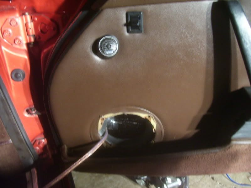

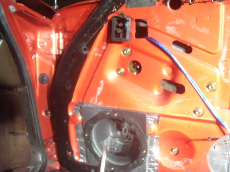

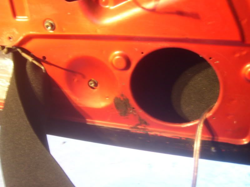

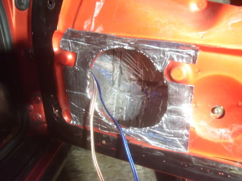

getting the new speaker wire into the door was a pain and a half. i wanted to attach it to the factory wiring and pull it through but the wire was so brittle it broke somewhere in the middle. i had to remove the plastic piece in the back of the trunk to get to the grommets on the passenger side. the wires are ran in the same place as the power window/mirror wires. i had to take the door off to get them into it, and even using a 2x4 on a floor jack to help support the door it still took me a few hours. working alone on removing, installing and lining up doors is NOT the way to do it. if you ever attempt this get a friend first.

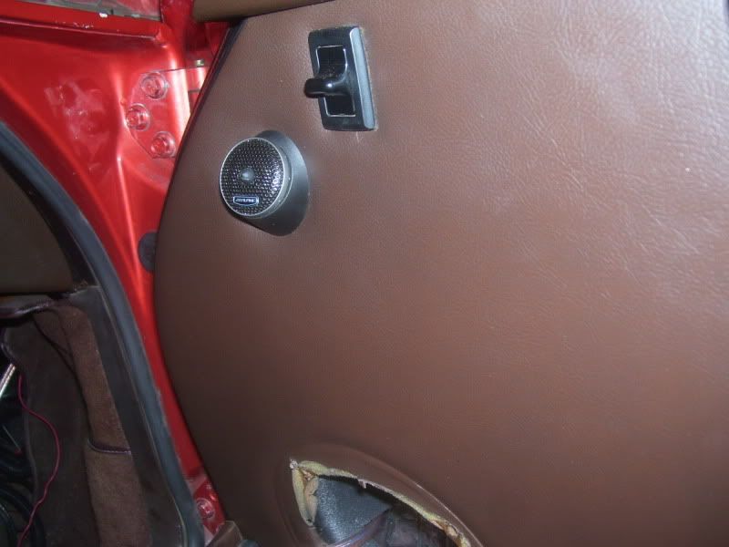

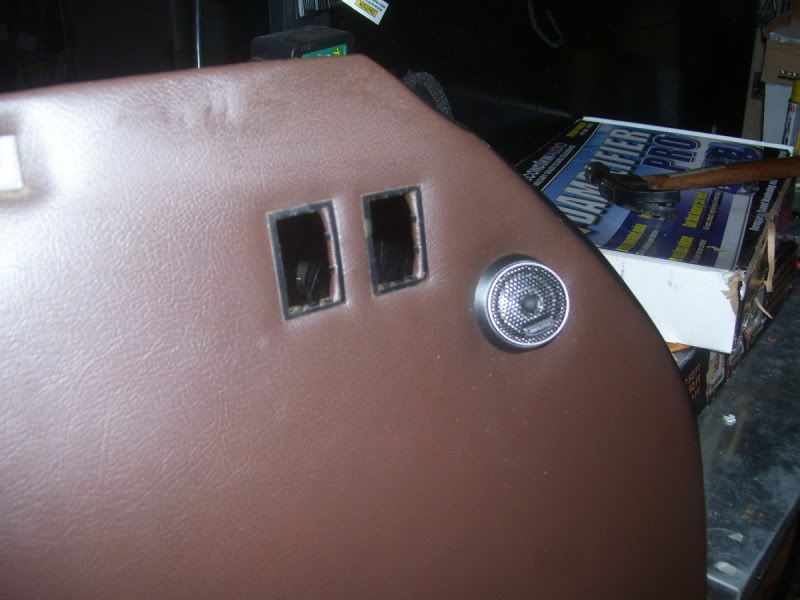

bought a set of xtc foam baffles to replace the tired and cracked factory ones. cut off the back and bottom since all i am using them for is a rain shield.
foam baffles and spacer / mounting plate installed. i ran the tweet wire through the extra hole next to the power window switch.

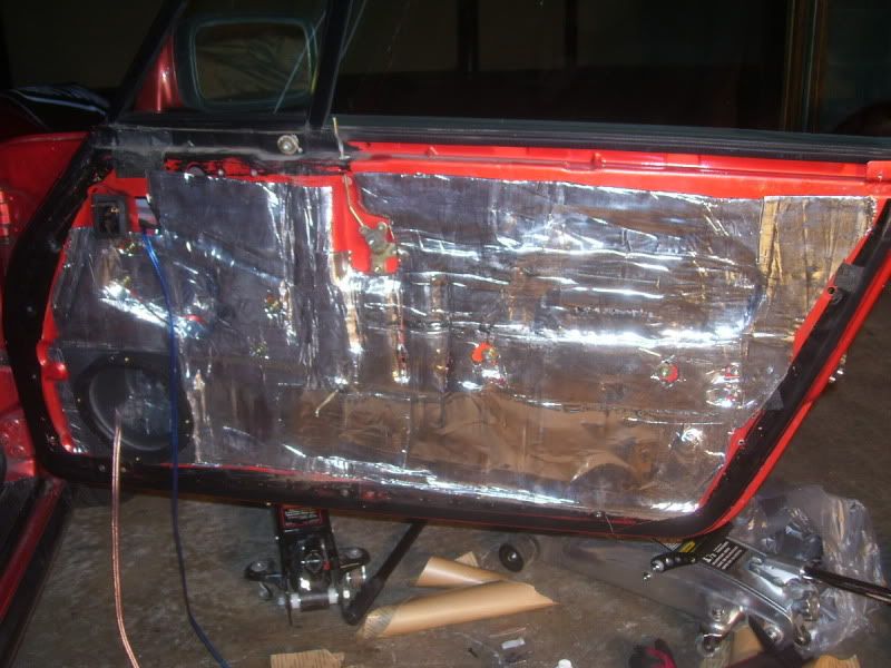

next on the list was a layer of damplifier pro on the inner door skin. i left a piece of the paper backing in place to allow the lock bar to slide.
anywhere there was a bolt or hole for something i cut around and left it exposed. made sure not to go all the way to the edge for a clean look and no problems later. this stuff is butyl-based with a 6m layer of foil and it will serve as the new moisture barrier. the factory one was still in place but it basically crumbled in my hands when i removed it. the good news is the inside of the door was clan and dry and had zero signs of rust anywhere.
put the panel back on and this is the (almost) final product. tweet is in an agnled surface mount as it would not fit with a flush mount. i still have to install the mid in the door but since it was 1am i decided to call it quits for the day.

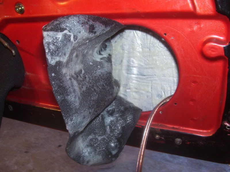

just a minor update today. i ordered some overkill ( http://www.secondskinaudio.com/noise-filter/overkill.php ) to put on top of the damplifier pro to help with some extra noise reduction and vibrations inside the door from the sound waves. it is supposed to arrive tomorrow so i did what i could tonight.
first on the list was to make a more stable holder for the door. i broke out the nail gun and some spare 2x4 pieces i keep and make a little bracket/holder for it.
note the little tub of grease. it worked wonders to help with pulling the wires through the grommets.
i used the same grommets as i did on the other side so nothing more to see there. i also found that with the door held up with my new tool i only had to remove the bolts from the top bracket. this gave me enough room to fish all the wires.
drivers door with factory asphalt dampener
stopped at my local hardware store and bought a small puddy knife / scraper. it has a nice beveled edge on the end which helped a lot with removing the old stuff. broke out the heat gun and in about 15 mins had it all gone and a nice clean surface to start from.
threw down a layer of damp pro inside the door
that was as far as i went tonight. i needed to keep the panel open for the overkill. i will have to trim back some of it on the passenger door (the big hole on the bottom) and remove the speaker to get it in there. i had everything bought to complete the job...until i changed my mind. oh well, just another excuse to spend more time in the garage.
i kinda skipped the pics of the tweet mount and since i had nothing more to do to the door i mounted it to the panel.

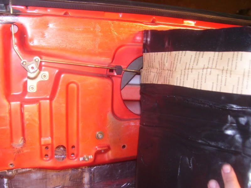

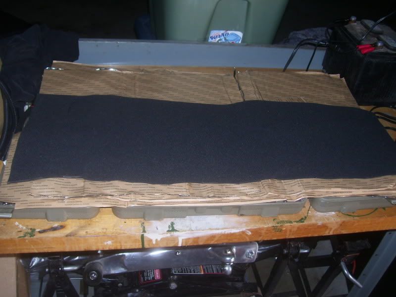

came home from work to find my overkill so i went out to the garage to get started again. i did a rough measure and found i needed a piece 33" long that tapered from 12" to 10" so i cut one to size.
next i fed it through the door and past the power window parts to get it in place. once i had it pushed to the front where i wanted it i held it in place by hand and pulled the front through the speaker hole. i then pulled the other side through to hold it in place.
i applied a very liberal amount of 3m super77 spray glue to the back of the overkill and also on the damplifier inside the door. i tried to spray as far back towards the power window parts as i could since i could not fully get my hand behind it. i then let that tack up for a good 1-2 mins.
next up was to smooth the front half into place.
repeated above steps with the big half and then sat back and admired the nice job i did.
at this point i removed the passenger door panel and did the same thing there. next layer of damp pro on the outside of the inner skin.
door back together.

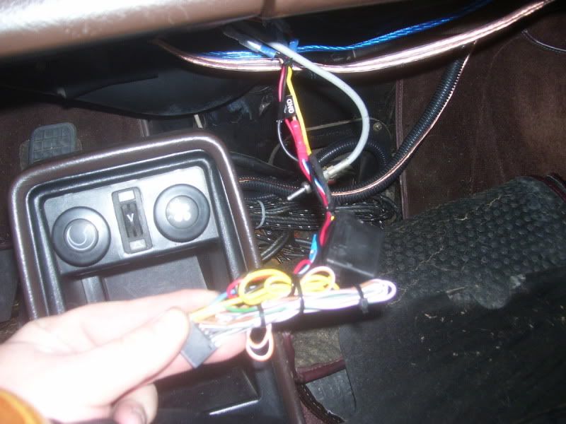

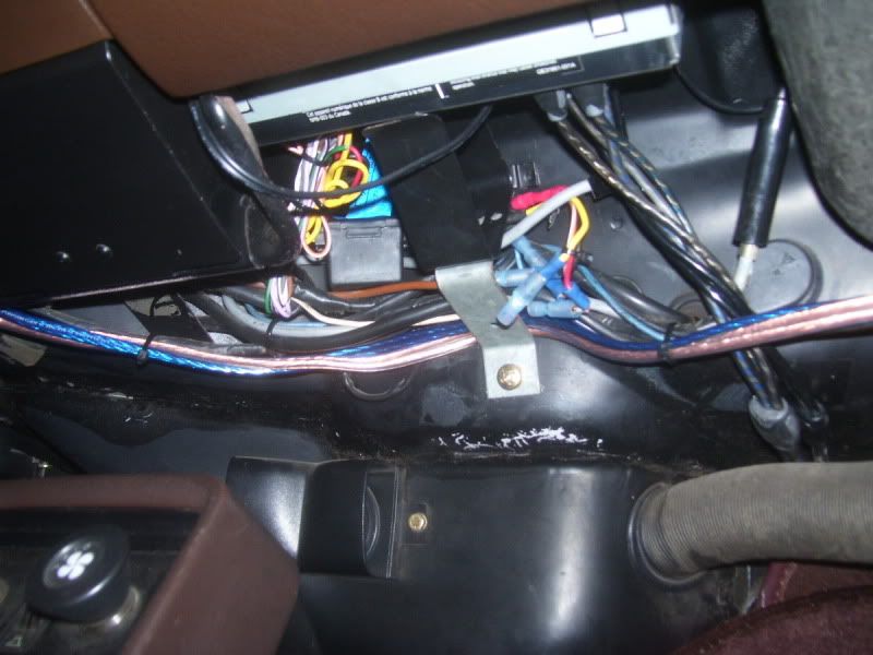

first up was to tidy up all the wires behind the head unit. i was not using the speaker lines so they got bundled and ziptied. then i grouped the excess power/switched/remote/ground/illumination wires and made everything nice and clean.

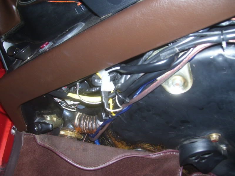

here is a shot under the passenger side of the dash. you can see the speaker wires as they run over to the middle.
all excess speaker wires and rca cables are ziptied and behind this panel, again all nice and clean.
left side speaker wires ziptied and ran to the middle.
this is behind the head unit. all wiring was put behind the bracket that holds the rear of the head unit. nice and clean, if i haven't said it before, is the way to go.
this is the ground from the previous owner's debauchery of the audio system and as my goal was not to add a single hole anywhere i reused it. first i cleaned off the area of contact.
here is the ground mounted. a generous layer of dielectric grease was used between the floor and the ring terminal as well as a solid layer over everything once installed.

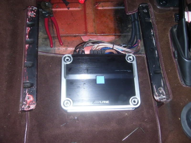

finally everything was cut to length and connected to the amp.
side view
rear view
i had to remove the 4 little feet that go on top of the mounting holes in the amp to get it to clear the seat rails and made it by a few mm. i also had to remove the rear floor mat - not the actual carpet just the mat that was on top of it. clearance was that tight. the rear seats will be coming out soon enough so no real need for the mat anyway.
once all of that was done it was time to start tuning. i set all the gains properly on the amp and then set the crossover points on the hu. the tweets are crossed at 3.2k and the mids at 63/3.2k for now. once i get the subs installed i will probably raise up the mids to 80. mids are getting ~150rms and tweets are getting about 60rms now but there is still a lot of tweaking to do.

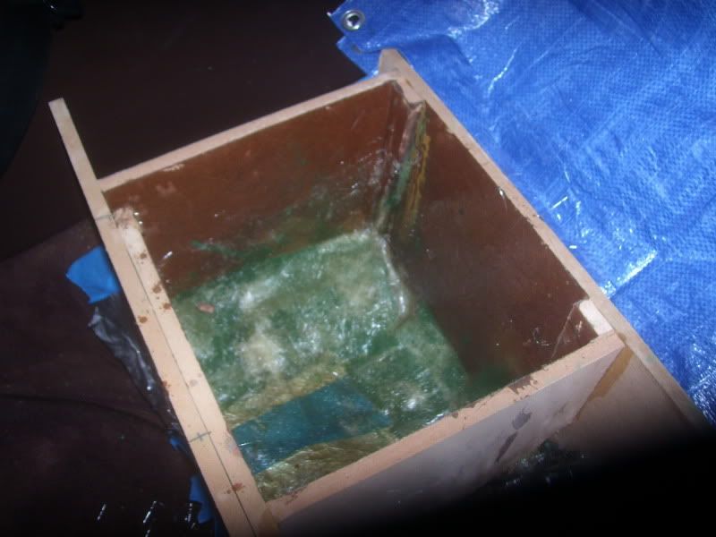

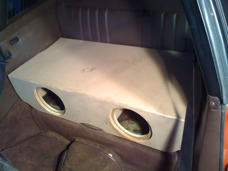

finally had some time to spare so on with the build....
i apologize for the pic quality on some of these. i left my camera at work and had to use my broken iphone that is getting replaced tomorrow.

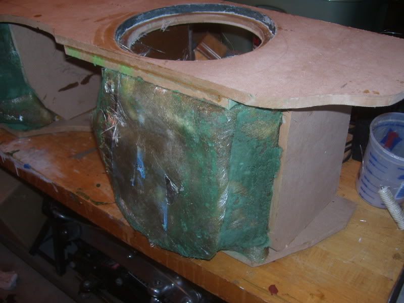

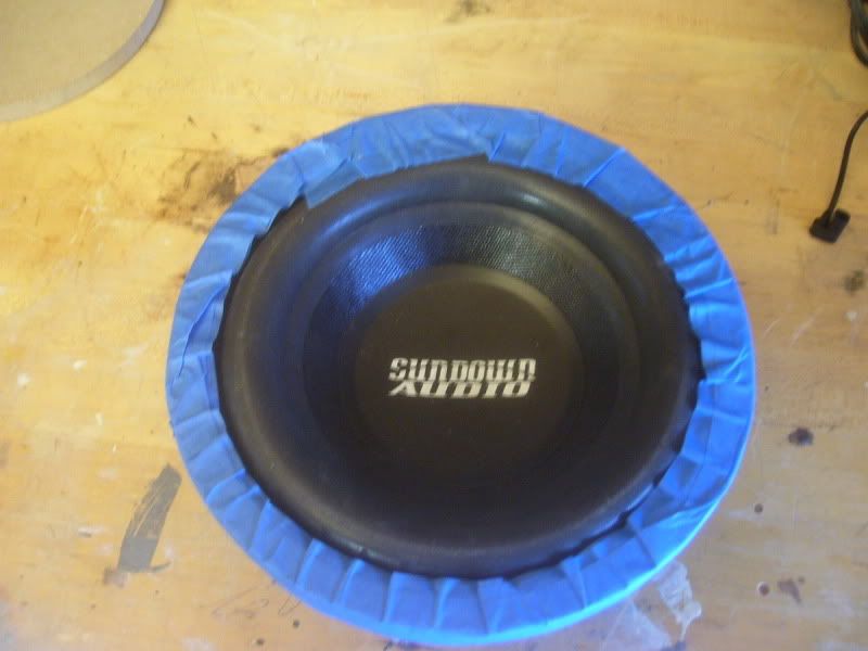

finished the framework for the enclosure / parcel shelf. normally i would use 3/4" but since i am only using a pair of 8s with ~200rms each (or less once i install and tune) and want to keep down on the weight i used 1/2" mdf. once the top is on (cut but no pics) it will be the same height as if the rear seatback were folded down.
i used my new jasper jig to cut out the holes but unfortunately i cut the flush mount face a little too small and had to go back around it with a jig saw. it's not perfect but it's close, and once the vinyl is on and i use some foam tape no one will ever know.

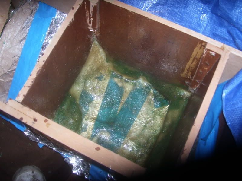

2 layers of painters tape in opposite directions
a layer of aluminum foil over that
here it is sitting on top of the prep work. have to go to home depot tomorrow and get some spray foam to fill in the gaps on the bottom and then i will start laying the glass for the base.

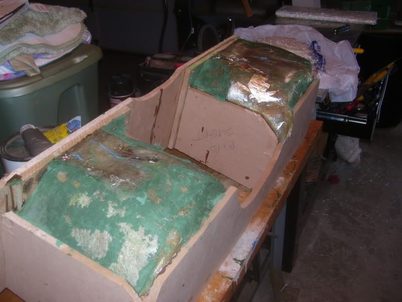

did a little research and decided to use floral foam instead of spray foam to fill in the gaps. it's super easy to shape/sand and resin does not stick to it. best of all a 3 block package is only $3.50 at walmart. looks like i will need 2 packs.
since i had to run up there i threw the top on just to snap a pic.

free time is at a premium but once i get started i totally lose track of time. this is as much as i can get done today, tomorrow i will work on the mounting system. i am thinking some form of a small plate that i can connect between the inner seat belt mounting bolt and then a bolt through the middle brace. i won't know for sure until the enclosure is fully cured and i can stick it back in the car.
on to the pics...
first up was to clean up the flush mount holes in the front panel. covered the speaker in a few layers of tape to protect and help simulate the vinyl thickness
next i filled the mount with some duraglass around the edges and then set the woofer in place. i let it go just a bit beyond the green stage and then removed them. i was left with this.
while it still is not perfect it is much better than it was and should look perfect once the vinyl is on.
time to start laying glass. this is in the car with 2 layers down. the green areas you see are the floral foam that i used to give me a better surface to lay the glass on. btw, if you ever need this stuff don't go to walmart like i did. i thought i would need more so while out supply hunting this morning i stopped at pat cataan's craft store. got the exact same thing, only with 4 blocks not 3, for $0.30 cheaper.
i let that cure and then removed it from the car for easier access while working (back and knees are gonna hurt tomorrow!). this is what the bottom looks like after removing the tape/foil/foam.
you can see here that even with 2 layers it still would let light through. this has nothing to do with the build but i smiled.
it now has 6 layers of mat on the inside and i will let it fully cure overnight. more updates as they come...

is this going to be FG + mdf or just FG alone for the enclosure?
