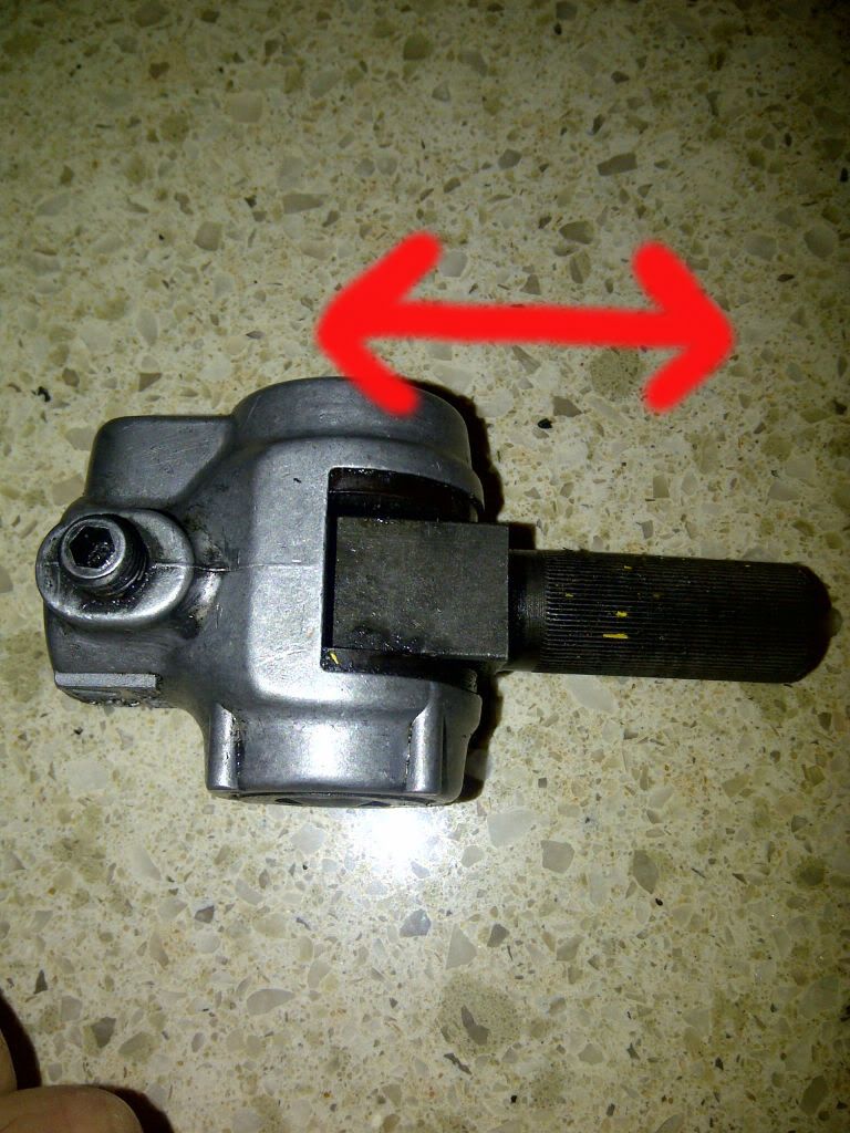

Hi guys - trying to tighten up my shifting (the cars, although I am sure mine could be better as well) and wanted to asked about play in the coupler?
Is play along the axois shown here normal, or is that an indication that it needs to be replaced? This is a "low mile known to be good spare" that came with the car.
Specifically I am asking if there should be any movement or wiggle possible?

To answer my own question - no, not normal. Indicates worn bushings.
Old 07-02-2012, 09:07 AM
Posts: 137
No, there should be no wobble, wiggle, or movement along the longitudinal axis in the coupler when the coupler is attached to the shifter input shaft into the tranny via the locking pin on the left in the pix, and when it is attached via the 13mm bolt locking collar to the gear shift lever from the right side in the pix.
The black, or sometimes white, plastic bushings can come apart with age. From what we can see in this pix, the black bushings appear to be in good shape. If the one in your car has wiggle or movement, those bushings are coming apart- or the locking collar is loose. In either case, finding the gears will be difficult- lots of wailing and gnashing of teeth- bad news....... I had those bushings suddenly break and fall out while driving one time- very sporting all of a sudden. Of course, those bushings had been deteriorating for some time before they gave up the ghost.....

There should be no "play" in that coupler.
It may be "good" (i.e. usable\fixable), but if there's any slop it needs to be re-bushed.

Guys,
Stock Couplers have always had elongated holes in the bushes with around 2-3mm (1/8") longitudinal free play.
If your 'as new' coupler has only a small amount of longitudinal play it is probably OK.
This is to stop the gear lever shunting when the engine'transmission unit shuffles back and forth.
If you buy new bushes from Porsche they will come with elongated holes.
Most of the good replacement bushes have a round fitted hole and eliminate this feature.
I think that the Delrin Bushes are likely to be the best as they have low levels of friction and can be used dry.
This type of bush is said to improve shift quality.
The PU bushes have higher friction levels and will tend to bind a little unless greased.

the "trouble" with the elongated "stock" holes is that your contact area to prevent slop while twisting/rotating is reduced to a single point/line along the flat and that causes faster wear. Since the contact area is reduced and the stock bushings are soft they are easily distorted under a load.
most aftermarket bushings are poorly made and either lock the coupler tight so it has no slop (and no movement at all so it jams) or they are made just like the stock ones and dont offer much improvement.
Wevo makes a great product but it will set you back some $
You might search on here for "coupler" and see what info you find
