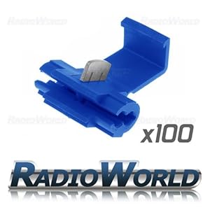

I used a flat four wire connector and these crimps.
Since I am running R tail lights I opened the cover and crimped into the brake, stop and left turn wires. I run a separate ground from the flat four TO the trailer with a quick disconnect.
I run a separate wire from the right side inside the motor compartment for the right turn signal.
The flat four is wrapped around my fog light assembly when not used.
Probably better connectors but they have been fine for 5 years.
As for sensor wires into the cabin, I use the existing grommets in the fire wall, run under the carpet up to the dash.
