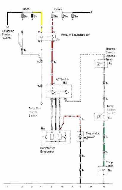

I jumped from the black wire on the relay in the smugglers box to the blower motor's red wire and it came on and I also could hear the compressor clutch kick in. (just the ignition switch was on)
I suspected the relay so I pulled it to check it out. I used a 12 volt power source to check it and when applied to the lug the yellow wire goes to it closed the contacts in the relay. So I figured it was good.
Re-installed the relay and checked the fan speed switch which checked out okay.
Pulled the wiring diagram for the AC and traced out the wires etc.
Checked all the fuses in the fuse box and did not find any blown.
Pulled and cleaned all the connections including the plug for the resistor in the air intake.
The wiring diagram shows that there are fuses in yellow wire going to the relay. Where are they located?
[IMG]
Any help would be appreciated. I'm scratching my head on this on.

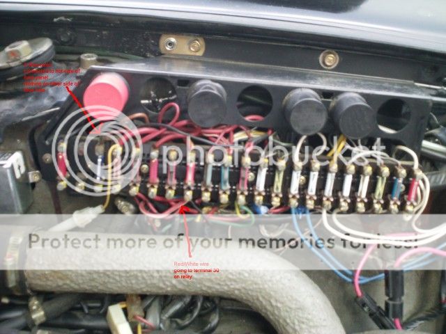

Found the problem, fuse was not making a good connection. Also it seem to be in the wrong location with a Red fuse. I guess the PO must have re-wired some things in the fuse box. (see photo)
Found two red wires attached to the hot side of the fuse box in the blue fuse location with nothing on the other end. will have to trace them out since they both go into a wiring harness when I have time.
[IMG][/IMG]
Thanks for the help guys, I appreciate it.
