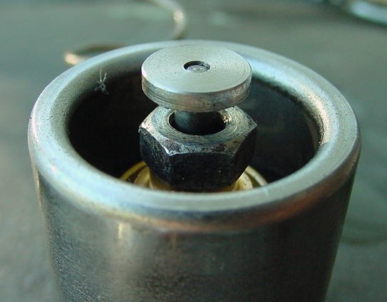

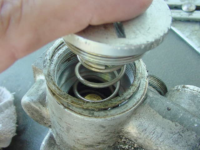

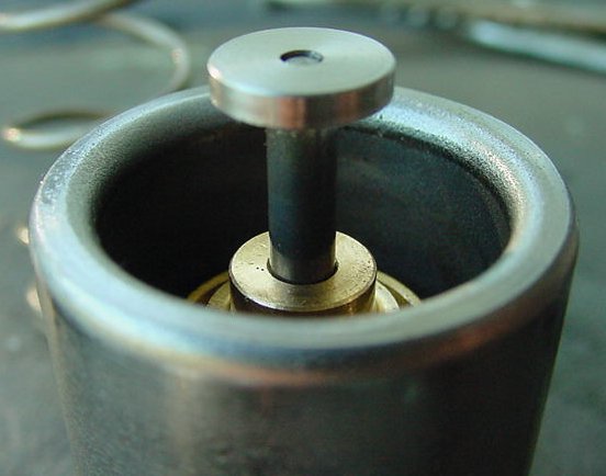

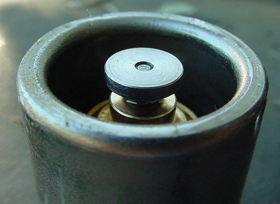

Here's the thermo element barely open. It's almost 100 degrees today, and probably hotted than that in the storage bin where this baby was sitting. Normally the plunger would be down flush.
Here's the plunger extended.
Here's how I shim the plunger. This keeps it from closing all the way, so you're going to flow a certain quantity of oil to the cooler at all times. This doesn't guarantee that the thermo will open al the way - if the element is bad, this will sorta-kinda get you by.
Here's the thermo element in the housing - the plunger end goes in first.
