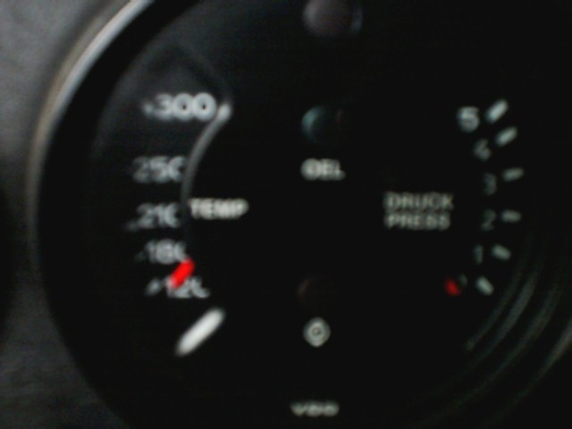

I upgraded my gauge and sender to the earlier version with the numbers. The only thing I don't like about it is that the numbers are covered slightly by the primary gauge face, as the opening isn't big enough to accommodate them.
[img] http://forums.pelicanparts.com/uploads/temp gauge.JPG[/img]
I'm using a radiator style aftermarket cooler without a fan. My oil lines are slightly crushed towards the front, but not enough to cause a flow problem (I don't think).
Does anyone make a temperature controlled fan that can be added to aftermarket coolers? Maybe that's the route I should take. I don't want a switch controlled fan.

Dang it......Here's the picture.....
