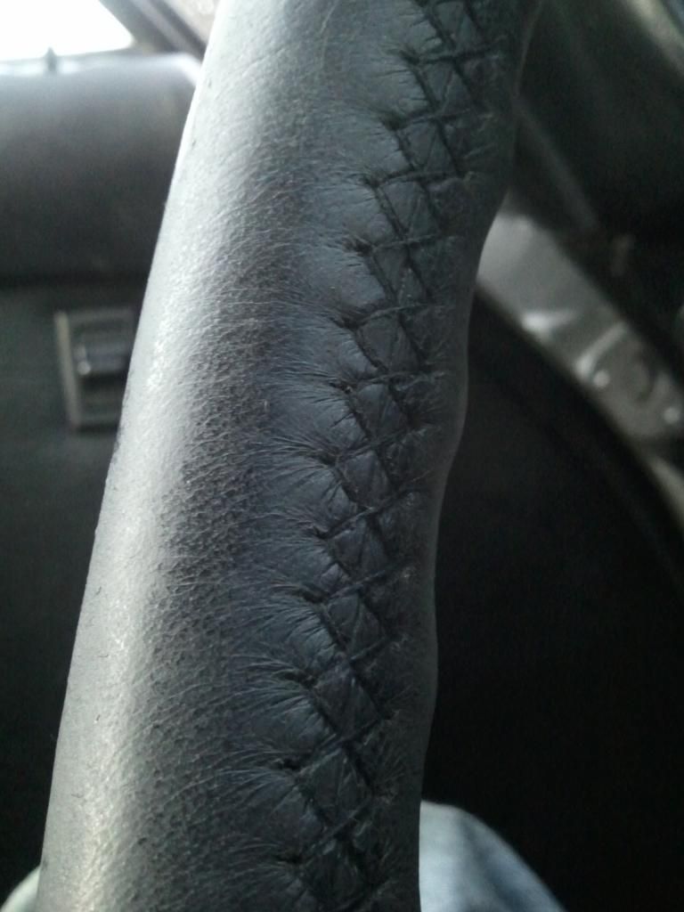

I had part of the upper steering wheel coming apart too, so I stitched it up today. I'm happy with the results.
