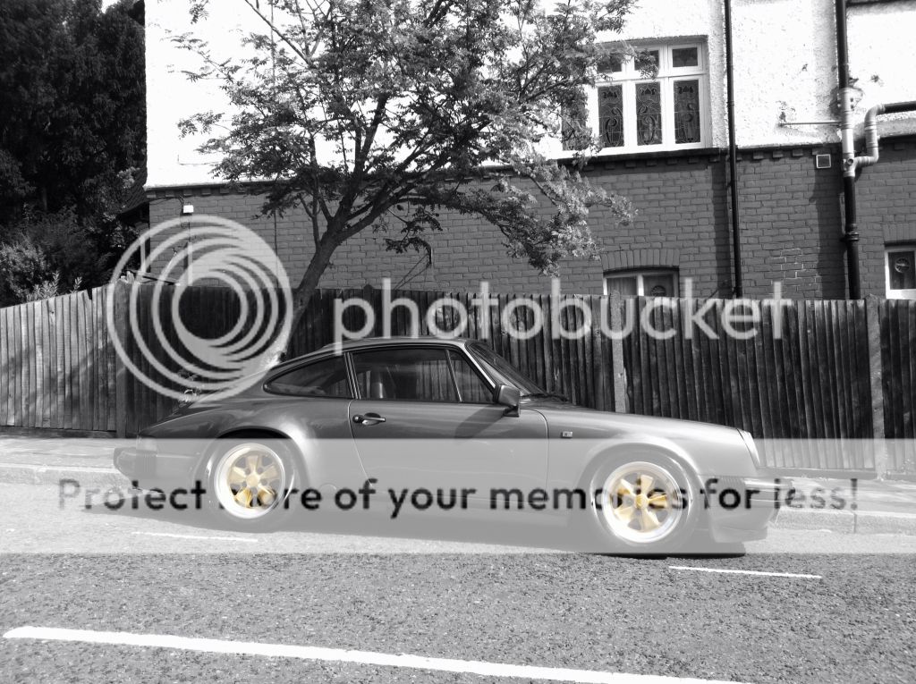

Had Boges fitted all round together with a hefty drop/CB/+1mm on front/rr arbs
Perfect combo for me - ford focus like suppleness in a straight line but with added anti-roll on the twist stuff :)
http://i383.photobucket.com/albums/o...02d457c16d.jpg
